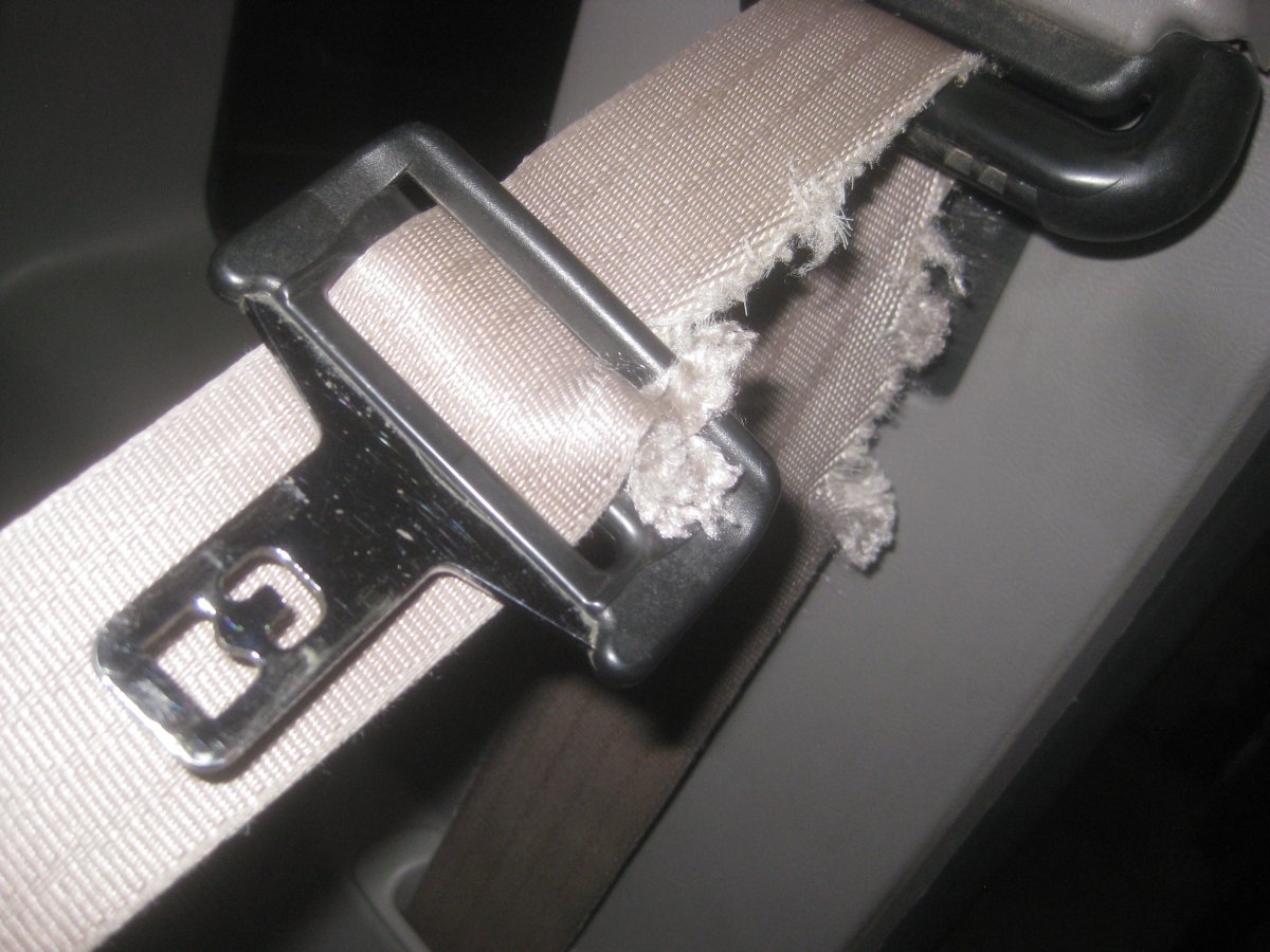

Before - latch gets hung up on frayed belt - also might fail inspection

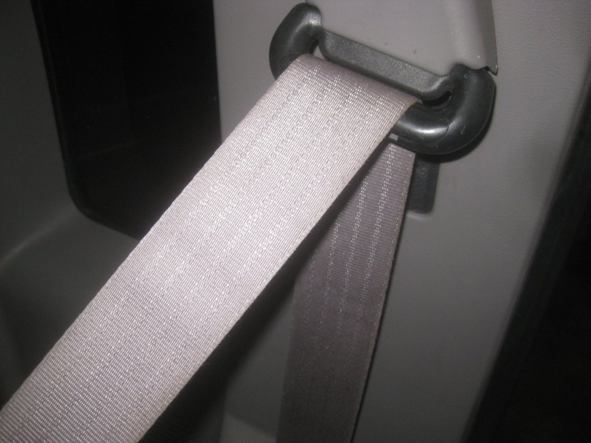

After - $45 for junkyard belt - was dirty - Simple green etc take out dirt but not black mold; full strength household bleach takes out black in about 20 minutes.
