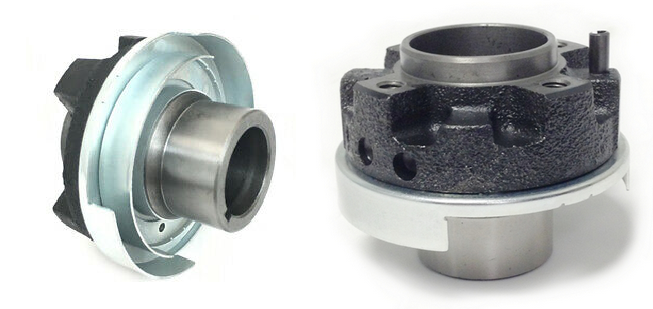

This is a fairly straight forward job. It's just unbolting stuff. Tough access is really the only thing that raises the dificulty. I could not find any info on how to do it, so I figured I'd write something. It took me 7 hr with 3 trips to the store and a few breaks to look up what to do. Be sure to know how to do your timing, cause the timing belt is coming off. This article is for the 2.3 Lima engine with the below pictured harmonic balancer... not a tone ring that looks like a sprocket.

- Use puller to pull harmonic balancer (optional, but makes sensor and timing belt removal easier). Remove the crank timing disc washer thing so it doesn't decide to roll away.

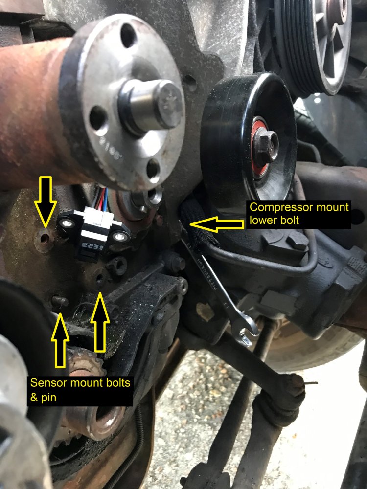

- Remove crank sensor from crank sensor mount.
- Remove crank sensor mount from block. It's held in with two bolts on top left and right, and an alignment pin on bottom. See second picture in step 2.

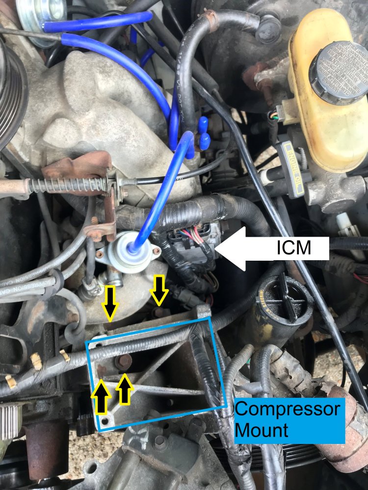

- There's no need to unhook the refrigerant lines to remove the compressor. Just unbolt the 4 bolts on top and pull forward and under top radiator hose to gain access to the mount underneath.
- Remove the top bolts holding the bracket in place. There are 2 large ones vertically and two smaller ones horizontally into the side of the block (marked below in yellow).
- Loosen (DO NO REMOVE) bottom mount bolt about one turn. I put a crescent wrench on it, braced my 3' long jack handle against the wrench, and beat on it with a dead blow hammer from up top. It's location is near the bottom of the block at crank shaft level. Access may be better from underneath.
Step 3: Remove Sensor.

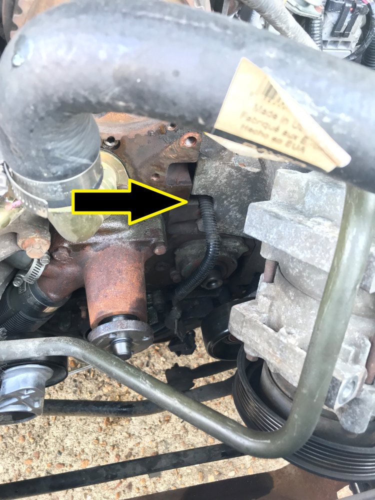

- This is the hole that the sensor passes through. Loosen the bottom bolt enough to allow enough movement from the compressor mount to get the sensor through the gap.
- Reach behind the compressor mount (under the intake manifold) and pull the crank sensor and harness out of the top. I removed the bottom ICM connector for better access to the connector. The crank sensor connector is on the same harness as bottom ICM connector.

- Put crank timing disc washer thing on the crank shaft, THEN install crank sensor mount.
- Reinstall Harmonic Balancer. Take tremendous care when mating the balancer to the sensor. If your sensor didn't come with an alignment tool, put a business card between the inside of the outer sensor face and outside vein of the balancer to adjust clearance. Adjust so the sensor just holds the card in place. Test clearance through a full rotation. Tighten sensor to the mount.
