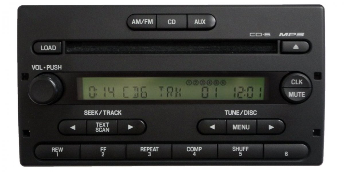

The only direct fit * no alterations* head unit I know of that will fit your dash would be the later models 6 cd/mp3 changer. Pioneer supplied some of them *depending on year*. Some had the aux feature built into them. It's a direct fit.
I have the one shown in my 98.
44660

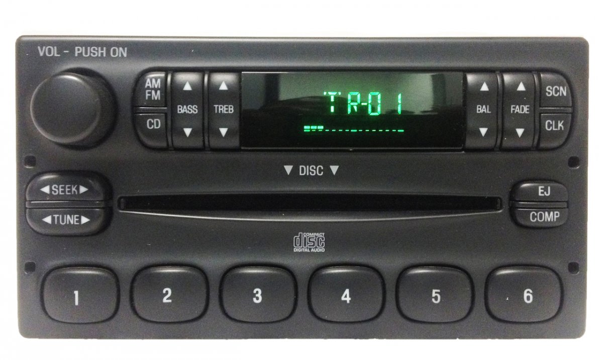

my original head unit was this......
44661
