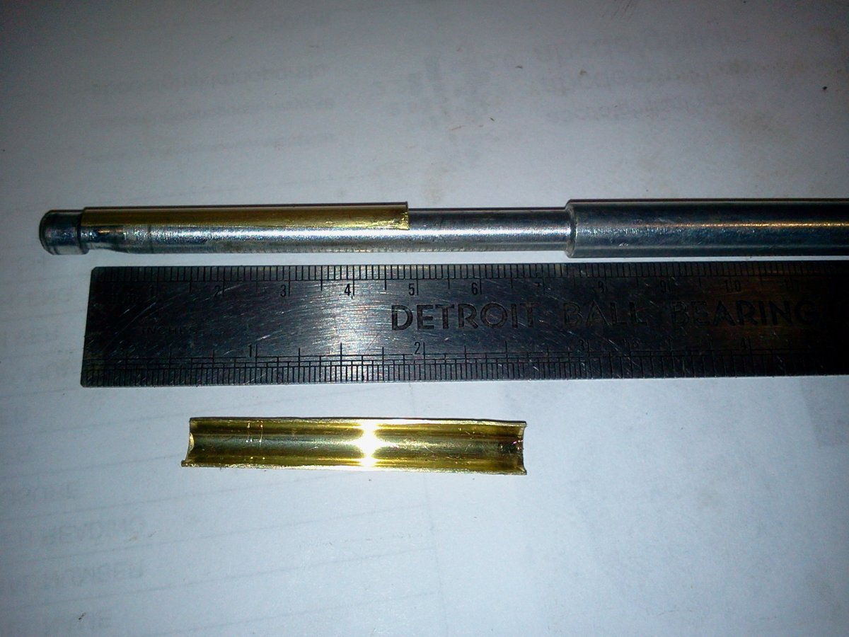

you mean the rod from the clutch master cylinder under the dash?
this is how I pulled just the rod out. 1/4 ID brass tubing, slide it down along the shaft to release the spring clips.
the small end is what's inside the cylinder.

On a '99, that's the only rod in the clutch system, both posts cover one end of the same rod so hopefully that helps :)

Ok. Ty so much

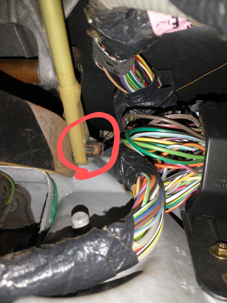

Ok guys. I just wanna make sure. This is what I was talking about. Upon looking at it again I believe I could use some more clarification.

Thanks for your help everybody! I decided just to rip the whole thing out and I ordered a new one going to start over fresh.
I usually just break em off and get #6C3Z-7A581-A from the dealer.
oops, wrong rod. sorry 'bout that.
while it's possible to pry the 2 short lock tabs open it's much easier to stick a screwdriver in there and force it off.
