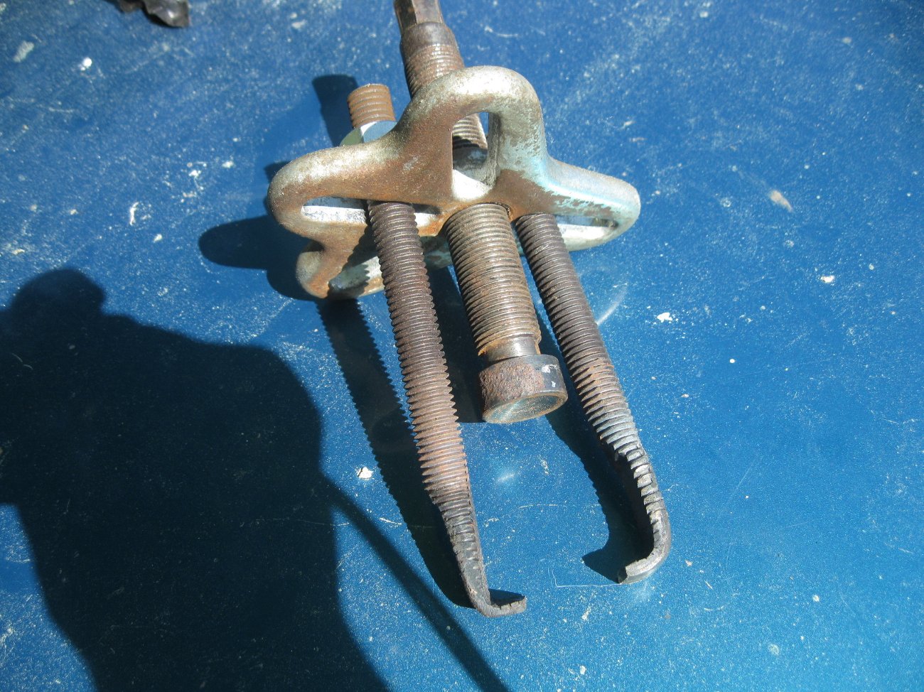

Here's my solution...I do have a torch I used to heat and forge the puller jaws. I started with 1/2-13 B-7 threaded rod...basically a high strength rod (like grade 8) used to make studs for industrial piping flanges. Fastenal/K.L Jack has it in 3-6' lengths...good stuff for making body hold down brackets.....
I heated, flattened and bent the 2 rod pieces to form the jaws...trial and error got me a good fit. I hard quenched the pieces then heated to draw the temper a bit, the first trial broke from too hard and brittle a quench.
Second trial worked slick.
Easy if you have a torch, B7, time and skill. You could use 1/2-13 Grade 5 or 8 bolts. I wouldn't trust redi rod...no carbon to harden.
