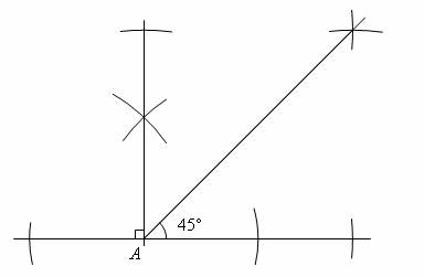

for reference.......
45 degree angle :
Removing air from cooling system

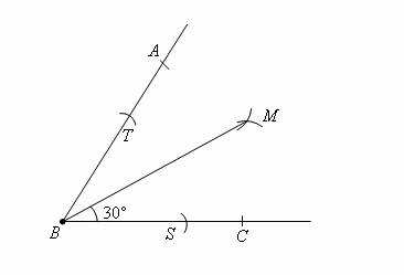

30 degree angle:
