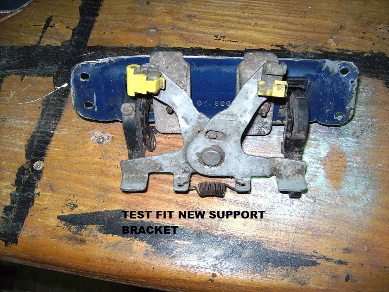

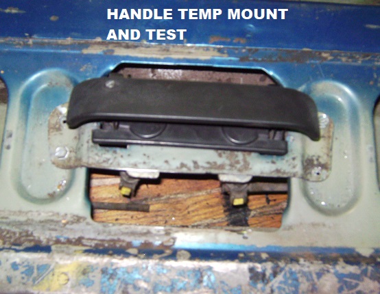

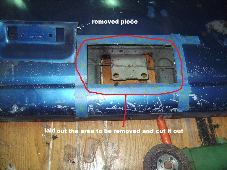

I started on the tailgate by relocating the handle to the inside of the tail gate. It turned out to be a simple thing to do. I removed the access panel on the inside of the tg and removed the existing handle and mech. I then took a cutoff wheel and cut the recessed portion for the handle out of the tg, I trimmed the removed piece to be reused as a support bracket. Flatten piece and bend ends to fit tg, bolt new support bracket to handle and test fit on tg. Connected tg latch rods and operated latch release. looks to work ok.:headbang::headbang::yahoo:
Will be welding patch to front side.

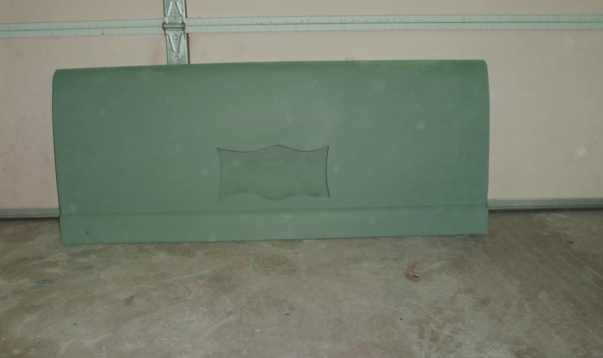

Outrangerous update
Been working on the tailgate, removed the handle and moved it inside, made up a panel and welded it in, fabbed up a sheet metal box to hold the recessed tag, and cut out the hole for the tag.
Had to open up the back side of the tailgate in order to install the sheet metal box and weld it in place.
started the body work on tail gate, it was pretty banged up after 17 years but it hammered out ok.
I shot a my first coat of black guide coat on it, looks ok
Still have to weld the panel back in place that I cut out and put the handle assembly back in.
It's coming along.
