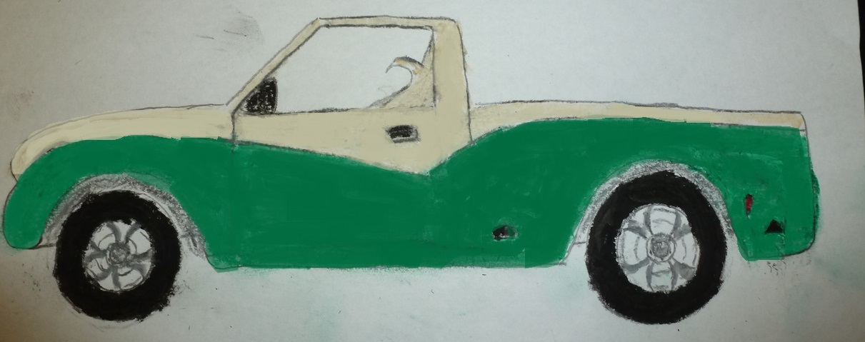

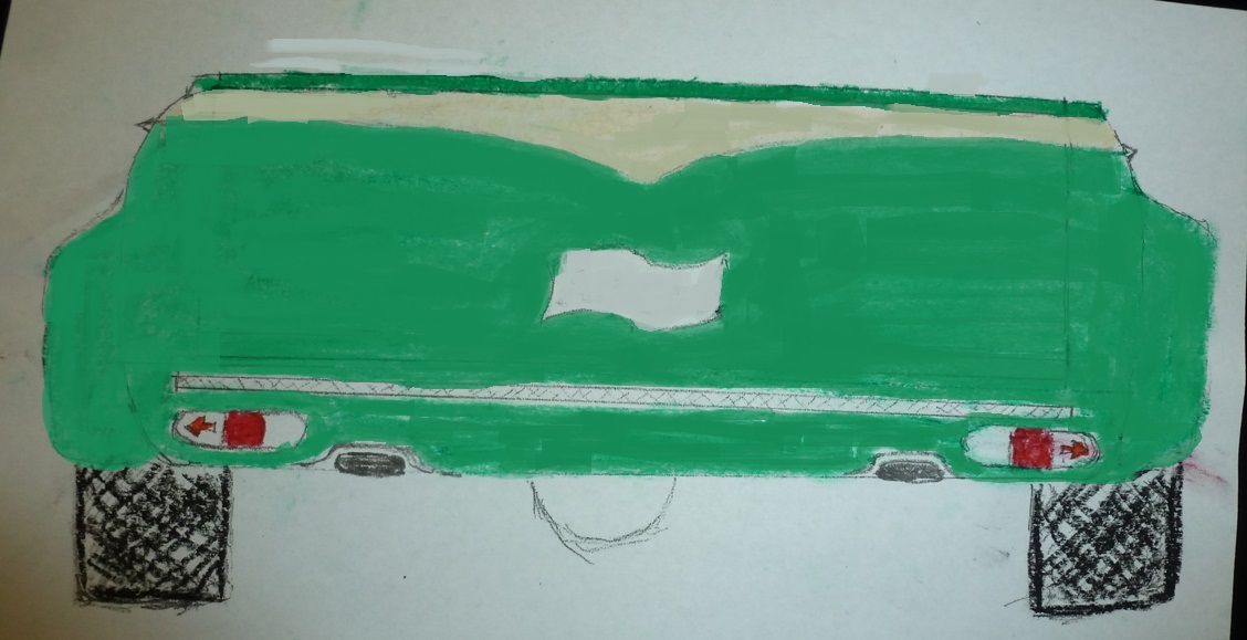

Just messing around with some rough drawings to see what kind of paint schemes I might consider.
Definitely going with a 2 tone.

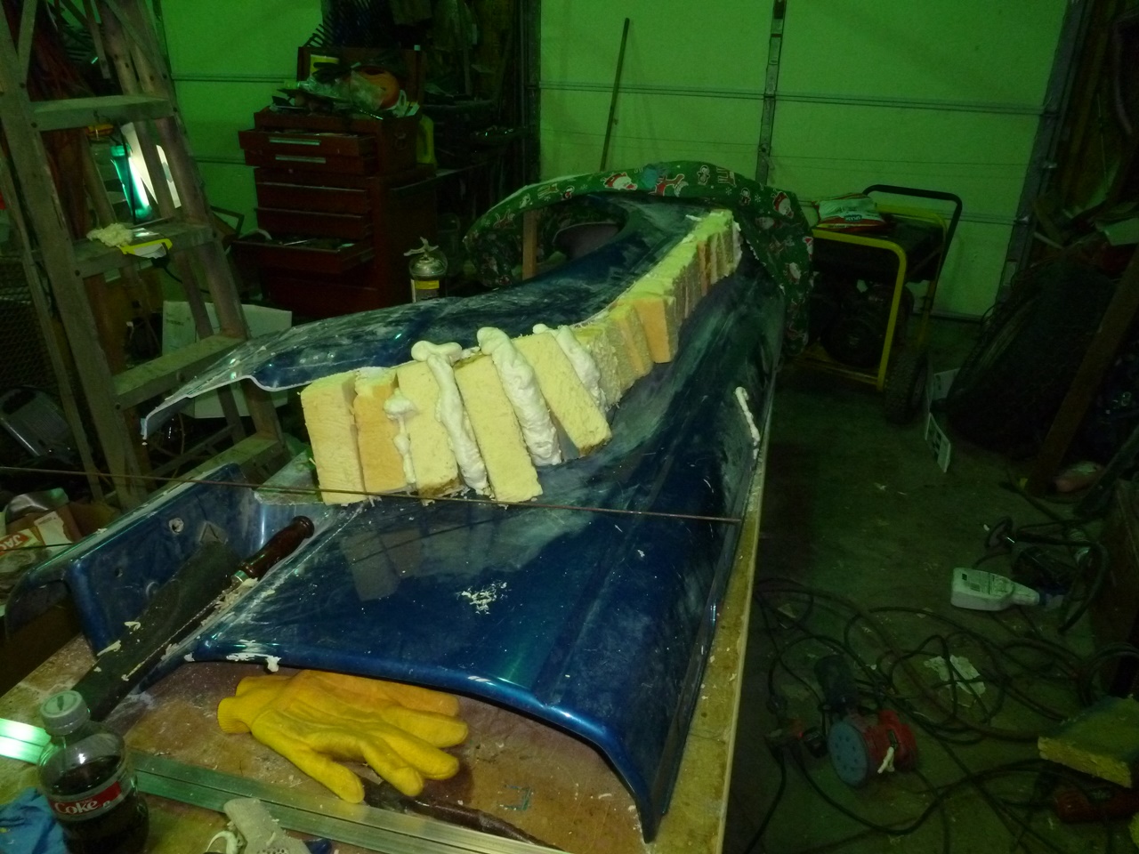

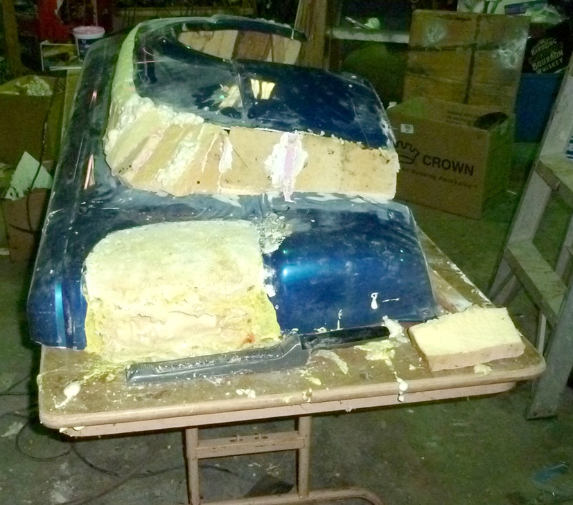

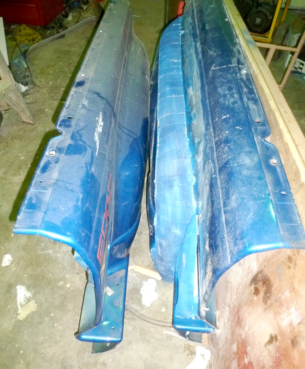

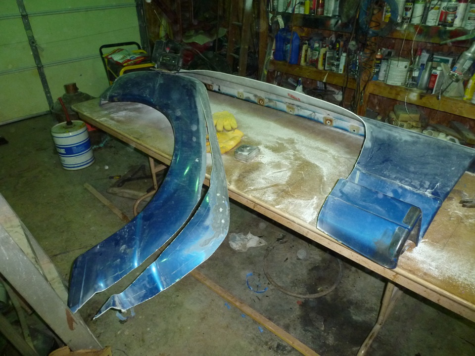

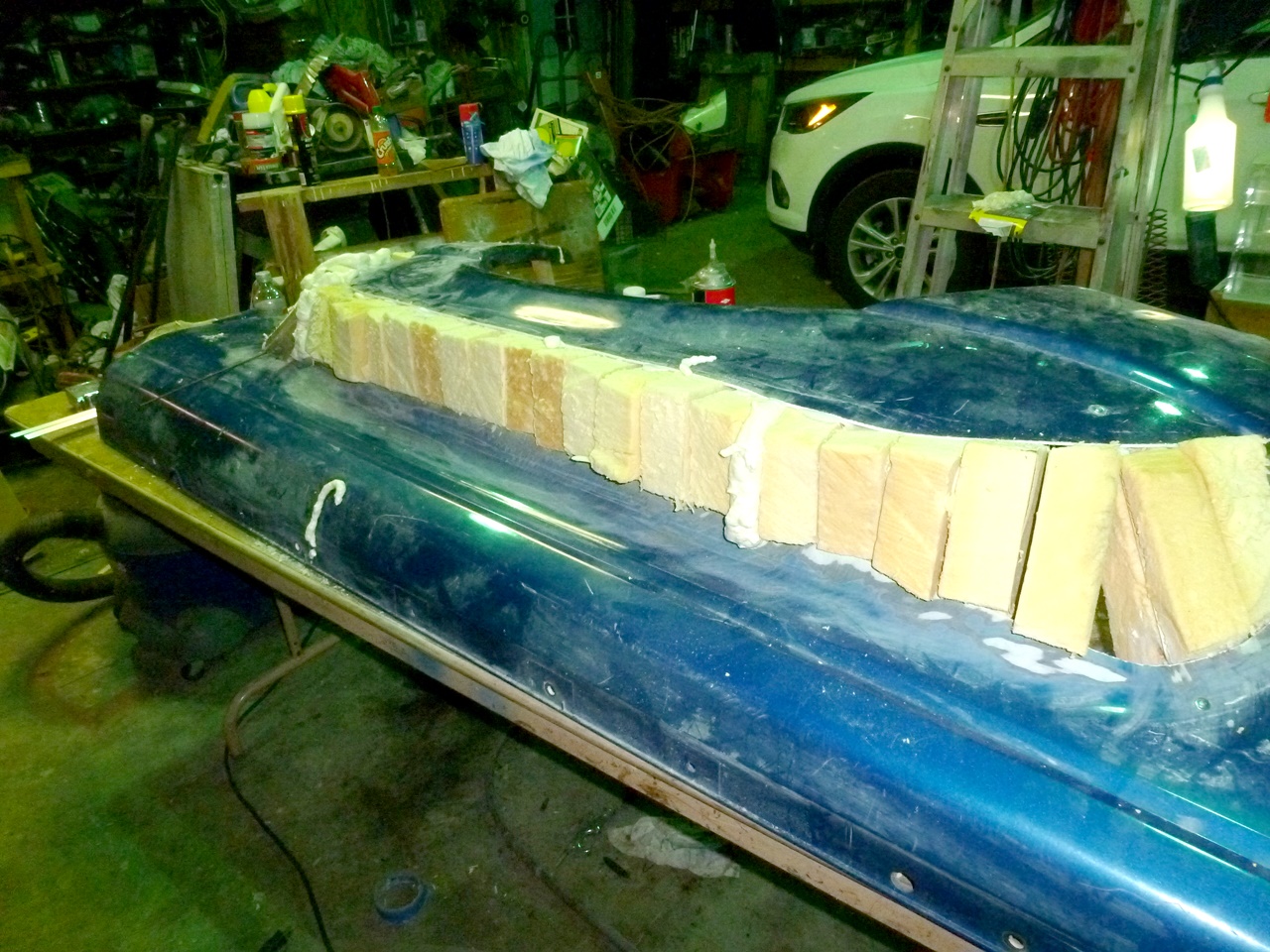

fenders
Looks good so far. Are you making a mold from this or is it going to be the finished product?
no, this is not finished, going to get final shape then put fiberglass outside then turn over and remove all the filler and then fiberglass with reinforcements on the inside. The outside will be finished off for paint.
