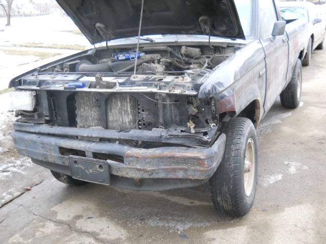

Hey everyone :) First, i would like to apoligize if this wasnt the proper place to post this. I looked at all the sections and figured it wouldnt be something for the RBVs under construction because im not doing my actual build yet. Just hit a bit of a speed bump lol.
As you probably remember from my post a few months back, i was in an accident and messed my front end up. Took a while, but i finally should have all the parts required to rebuild. Big thanks to Andres629 for helping me get alot of the parts!! :icon_thumby:
So, i need to remove the bumper, fender, whatever the thing that goes between the bumper and the lights/grille is (Lol), and my lights. Damage is on the front drivers side. I also bought clear corners/signals and a billet grille, figured i may as well now lol. Kinda sucks that the bumper is chrome and such, but free is free. And i can always find a better part or paint this one later. At least the fender is a decent black that shouldnt look too off from my truck.
I will be taking alot of pictures as I go for ya :) Also will be needing some help since this is my first bodywork kind of stuff. Gonna be fun tho.

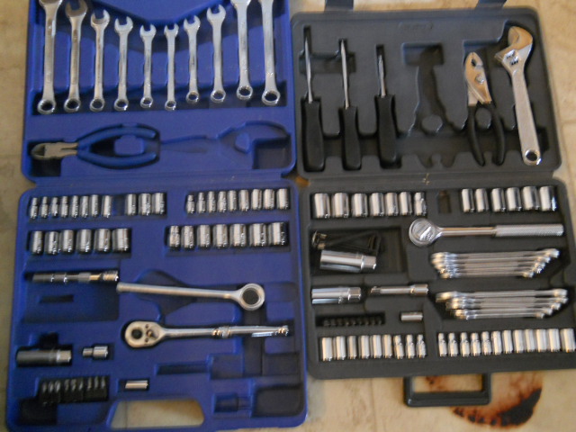

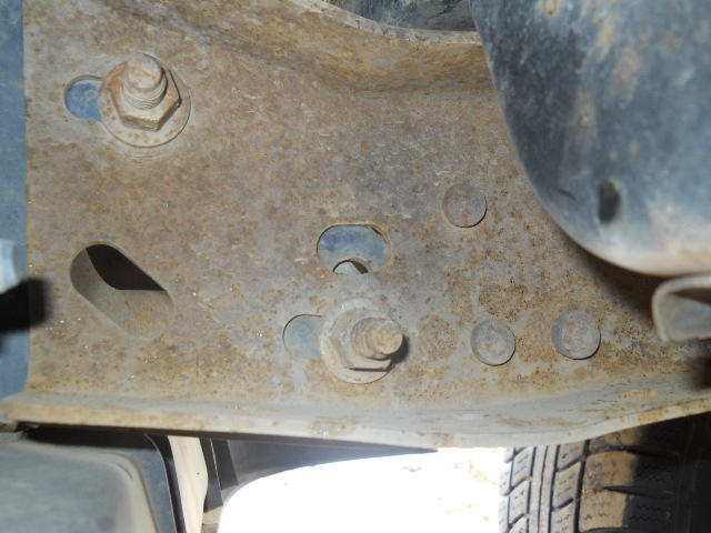

First things first... What bolts do i need to remove to swap bumpers? Is it the one i have pictured below? If it is those ones, I dont think i have a tool to get that yet. I just have sockets and stuff and it wont clear the bolt, also wrenches have no room to move in the lol. Theres a pic of the tools i have to work with currently. So idk, I'll find something. Maybe have to take a trip to canadian tire or something :P

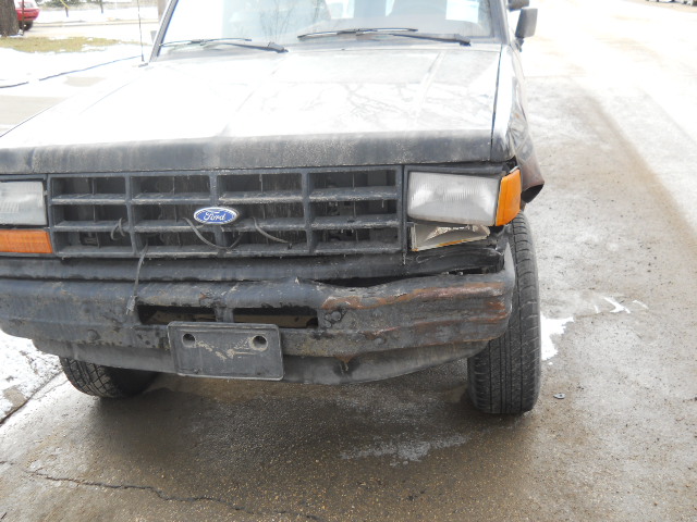

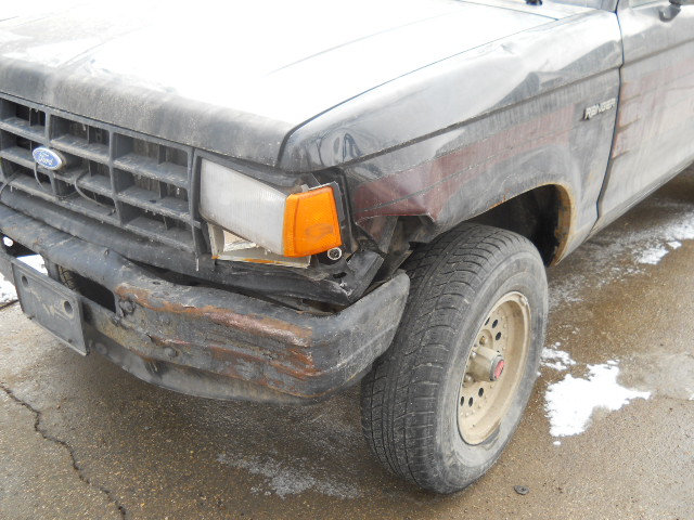

Heres some pics about how my truck currently is sitting. I took off all the screws and bolts for the fender, but it is still wedged in i think (or hiding another screw), so im going to take off the bumper and go from there. Also might move the truck somewhere other than the middle of a fairly busy street to work on it lol. The last pic is of the bolts i was wondering about.

Take all your grille and light assemblies off first. There will be bolts in behind them holding your fender in place. As far as the bolts on your bumper are concerned, put a socket on the ones that I included on the bumper I gave you to determine the size. You might need a deep socket of the same size. :icon_thumby:
For the bumper; use a combination wrench on the nut and a socket and ratchet on the bolt head. Also, sometimes you can get a socket on the nut first and then put the 1/2" ratchet on, it'll barely catch if this works.
For the fenders; do as Andres629 says, and also check the door end of the fender. There's one bolt that you have to access by opening the door and one under neath that you may have missed.

Ok ill look intot his tomorow. The fender is loose all by the door and at the top. Its where the fender cumpled in that it will not come loose so thats why i figured its probably attatched there. The headlights thing would make sense then. It looks like ill need to get a deep socket for the bumper. Ill see if i have money to buy something that will work lol.
That piece just in between your bumper and grille is called the header panel. There is also a bolt holding it to the fender, and only three bolts holding it on total. One on each side (hiding behind the inner fender plastic) and on in the middle under the grille. When I get home I'll take some pictures of what you are looking for. :icon_thumby:
Ya i pretty sure thats where the fender is still attatched. I will have to take off the bumper then bend it back out i think. Just confusing because its all crumpled in, so i cant just unbolt everything lol
Anyone know what size the bumper bolts are so i can get the right deep socket?
Put a socket on the ones that I included... On the bumper that I gave you. You'll be able to determine the size that way.
Ok getting a new socket set tomorow. So that will be done after i get that. But i tried to take off the lights and grille, but couldnt figure out how the hell im supposed to do it haha. I got the normal screws out, but there are some flat plastic ones that just turn and turn. They are like plastic and it kinda looks like they arent actually holding it. Seems like they are screws held by plastic peices that hook in when u push them thru (kinda like what holds door panels on). But that make no sense lol.
Any chance u guys know what im talking about and how im supposed to get these off? I tried turning them froever and they didnt do a thing lol they just spin and spin. They are at the top, a few holding in the lights and some holding in the grill. As well as some at the bottom of the light i beleive.
Ok, i figured out that they were clips or something where u needed to squeeze the bottom with pliers and then unscrew them. Got all the ones out exept the ones that were unaccesable in the back.

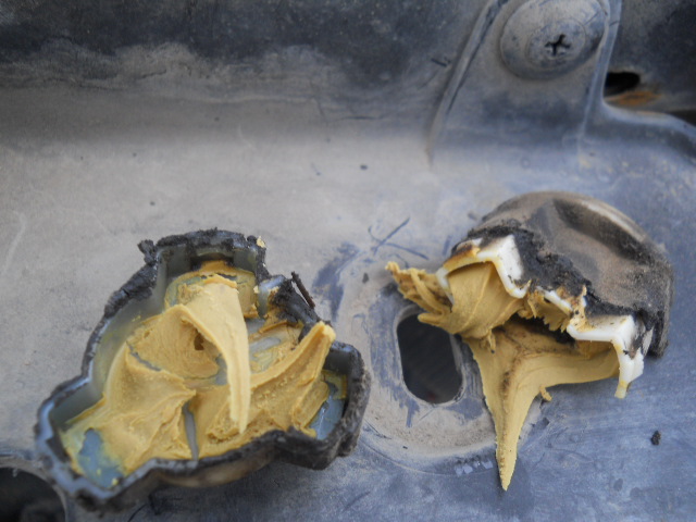

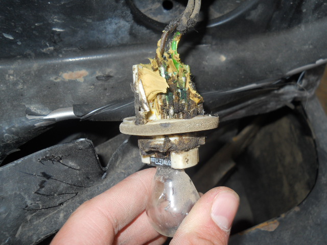

One thing i was a bit confused as to what to do with is the headlight connector is broken on the side that was damaged. Theres some pics incase u dont know what i mean. So, should i just cut the wires and replace the connector with the one i have here with my other light fixture and light? lol

Yeah just splice in the wires. If you know someone witha soldering iron, bonus! Get the to do it for you. :icon_cheers:
