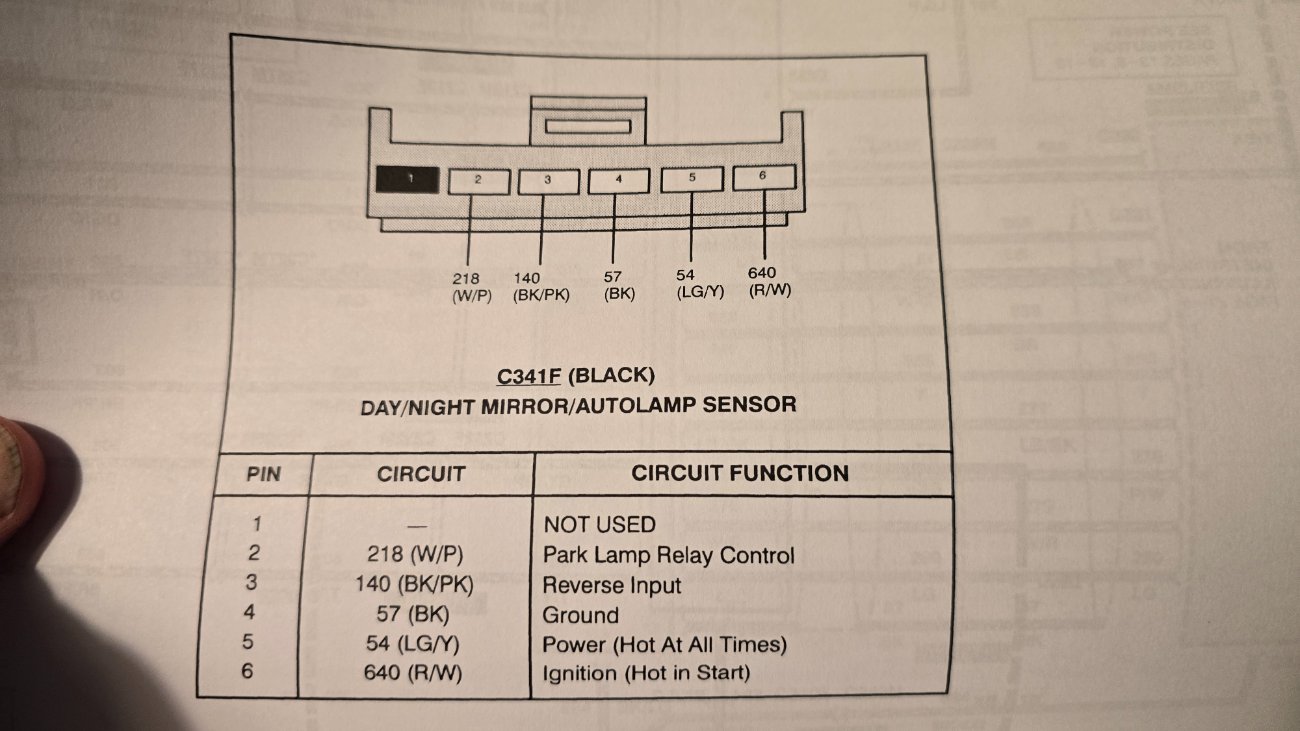

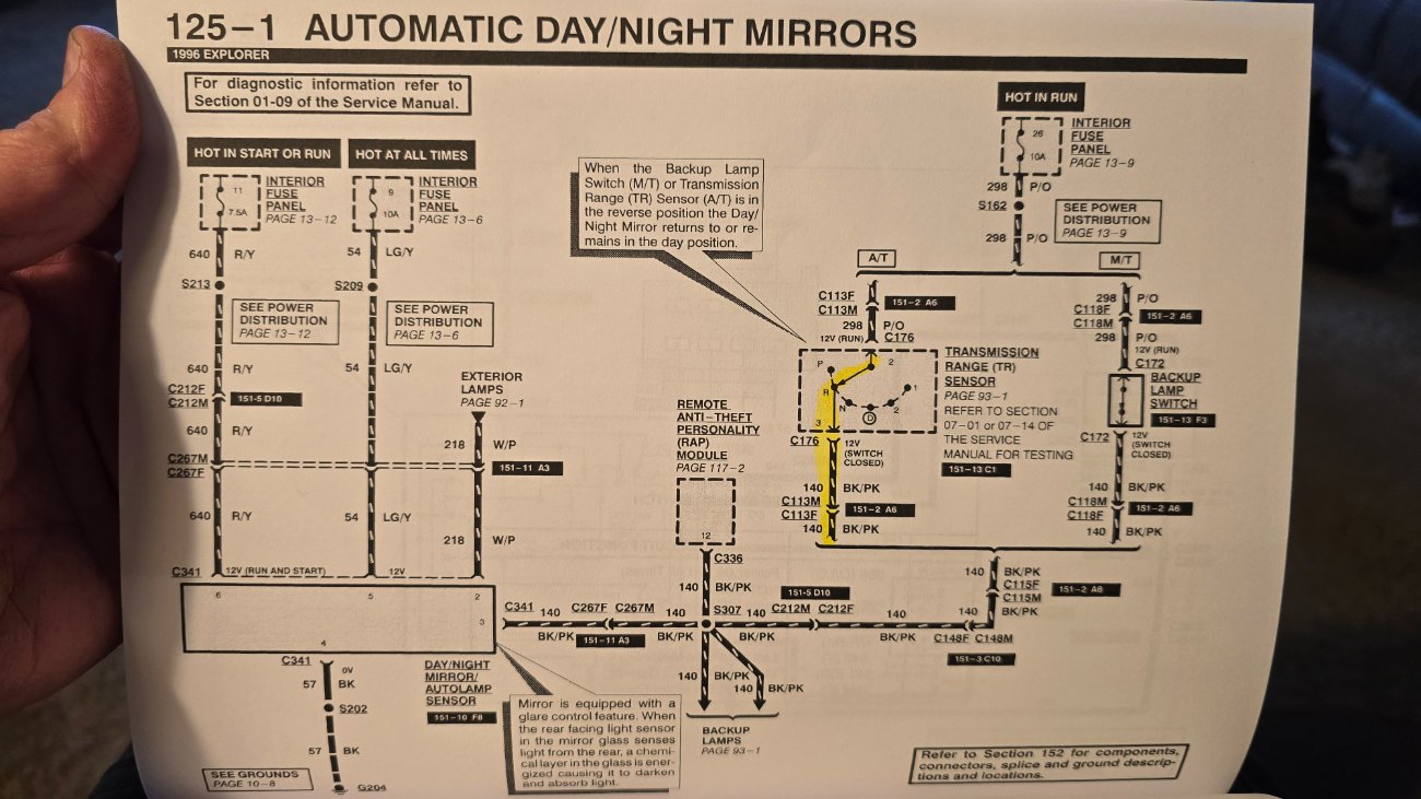

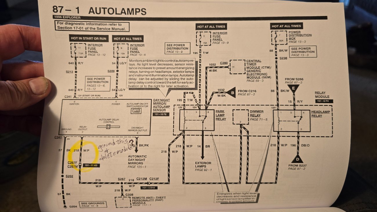

So it's a
Gentex GNTX - 156
It has six pins but on 5 are in use with colours as follows
1-red/yellow
2-green/yellow
3-black
4-black/pink
5-white/violet
6-open slot
Hopefully someone has done this, or knows another fourm (thanks again mnmattie)
