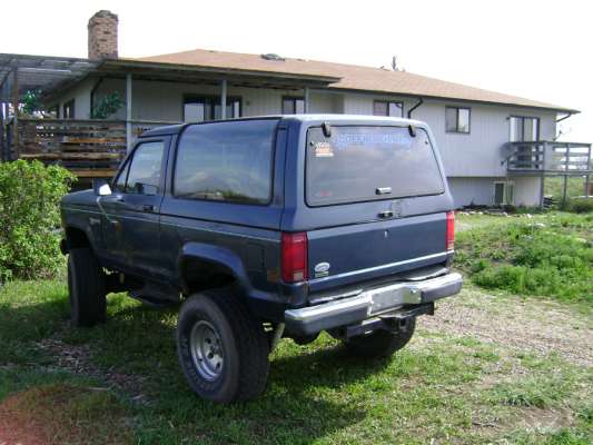

i saw a bronco 2 with a rear window that opens was this an option or is it a swap people are doin

A lot of b2's and explorers are like that. It's a very convenient thing to have.
How hard is it to add this? i have a exploder for parts could i use its rear window?:dunno:
So you are saying that I can't take my non opening-window hatch of of my BII and put on my opening window hatch? The mounts and latches are identical.
I thought I read somewhere that the rear hatch of a bronco 2 would interchange with the hatch of a first gen explorer. So that's not an option due to different sizes?
Ive had both on the back of since people like rear ending me so much, right now i have the solid sealed glass and i hate it compared to the other two i have had with the opening window. How hard is it to do the swap. I have the old glass and interior latch components.
To swap the whole hatch I believe all you do is remove the hinge bolts and replace the hatch and install the hinge bolts, you most likely need 2 people to do this though as the hatches are quite heavy to try to maneuver around while trying to install or remove the bolts. Has anyone been able to install a rear wiper/washer on one of these hatches? My 84 B2 doesn't have one, even with the fixed rear window. Are there any writeups anywhere that explains how to do the swap and anything about installing a rear wiper/washer with the opening rear glass?
