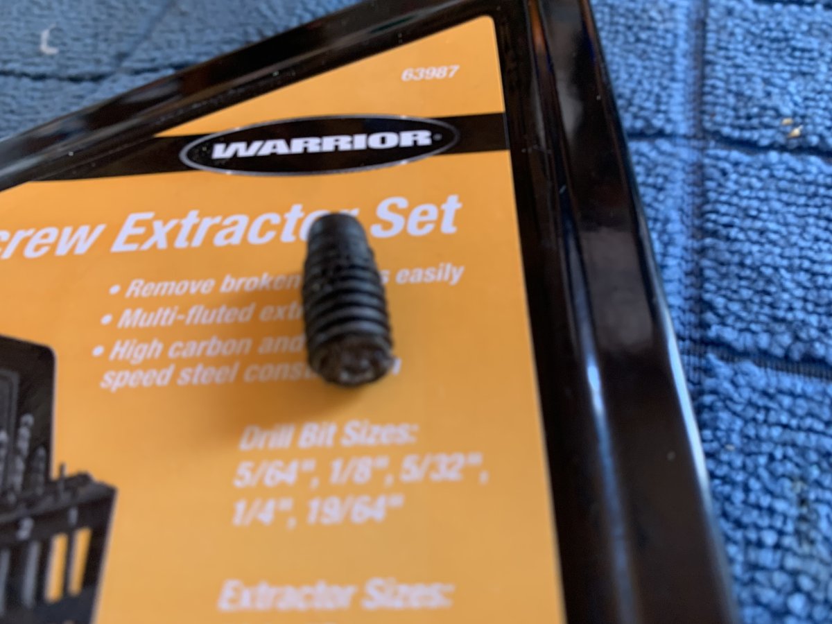

I would drill out the broken bolt because I'd never leave out one fastener. If you decide to drill it, make sure there aren't any metal chips in it afterwards.
Thoroughly cleaning the gasket surface with brake cleaner and then resealing it, odds are it would never leak.
If I try, I'll do it before I remove the old cover to make sure nothing gets in. By the look of it, nobody ever tried they just left it. Maybe a few good whacks with a center punch, some PB blaster and a bolt extractor bit will allow me to get it right out?
Broken bolt came right out. I didnt even get a chance to try the easy out spiral bit. Just drilling it with the harbor freight left hand drill bit started backing it out. Thankfully it wasn't corroded in place.

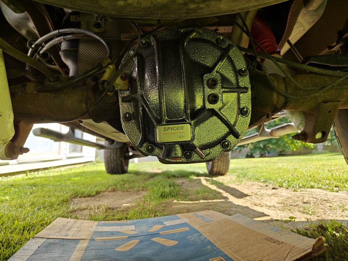

Finally got it on with the Lube Locker gaskets. No leaks so far and I opted not to torque the bolts. I just tightened them little by little until I could feel the bolts "stretching" (not sure if they actually are but that's how it feels) and marked them with a paint pen to make sure they aren't coming loose.
I filled it up using the lower port which I think is correct? The diff is at a slight angle but not enough to make a huge difference in oil level.
I also had to trim the bracket because it wouldn't fit with the new cover.
I still use the front fill port on the differential since it takes the guess work out of it. Technically, I could use the dipstick hole in the ARB cover I got but access is easier from the front of the diff and not having the spare in the way. The dip stick is just there to make sure the fluid isn't low that way.
For yours, I would fill from the front. Then pull the top fill plug to see where the fluid is at. If it's below the plug, try the lower and hope it doesn't make a mess. That will answer if either of the two plugs are reliable to filling the differential to the correct level.

Thanks, I will double check it with the front fill port. I assumed that the bottom port on the cover was the same but it doest hurt to check!

On mine the lower fill plug looks like it would be just in line with the factory port IF the diff sat level front to back on the truck. The rear of the diff is angled down slightly so I should have slightly less than if I had filled from the factory port.

You were right though, I parked on a flat parking lot and took the front fill plugs out and it was low. I brought a bottle of gear oil with me and filled it the rest of the way. It took maybe 1/3 quart. At least I know unit is right where it should be now.
I will just fill it from there as it was easier to tip the bottles up to squeeze the oil in without the spare tire in the way
