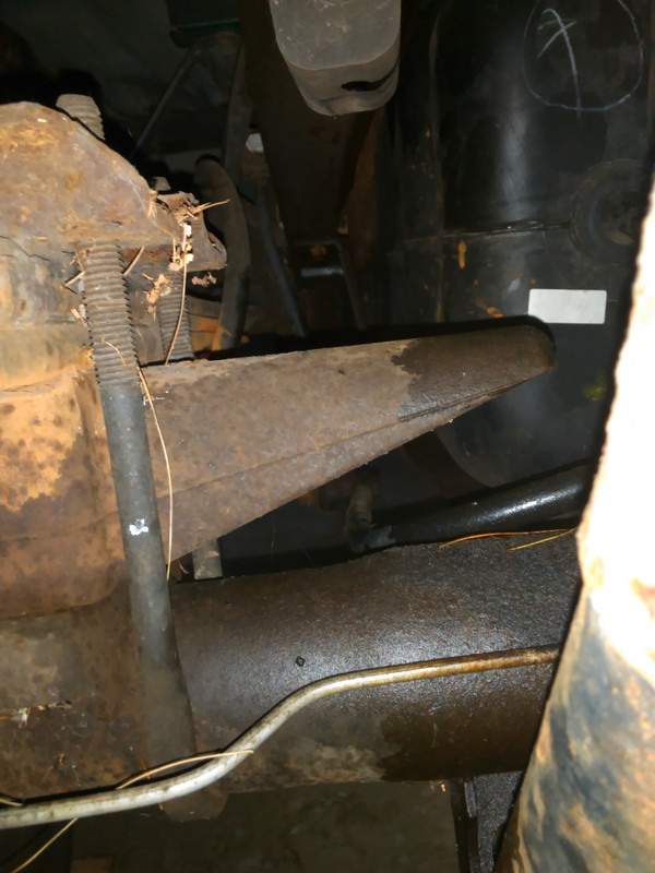

Thanks adsm! And I think you may have called it correctly. I don't have a helper to pump and the lighting isn't great, but I just snapped a few photos. The first is that T area on the axle, (reference is just behind the rear tire:
As I'm looking - and this is where the camera doesn't do justice, there seem to be wet spots going further up. Not sure what that piece of metal is that runs parallel to the axle, but there's fresh fluid:
Then following it up further, the top of the frame seems a little wet. Shadows make this hard to see, but there's some sort of leakage up there:
The top half of the photo is what I'm focusing on. Does this sound like the leak you're referring to?
That line at the top going into the rubber flex line in the final pic looks new and also hand bent so good chance someone flared it themselves... I'd start there. probably just a bad previous repair attempt. Most people who try to flare their own lines have no idea how to do it properly.

On a side note that piece of metal that runs parallel to the axle, that you said has fresh fluid on it, is part of the bump stop for the rear axle. Directly above it you will see the rubber part of the bump stop.
