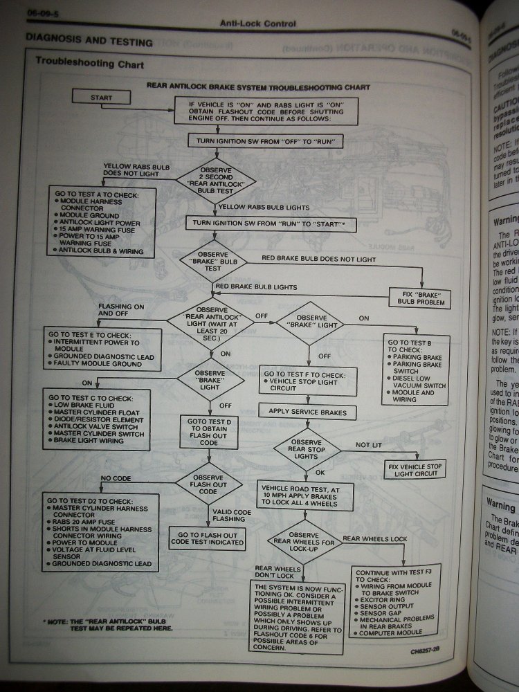

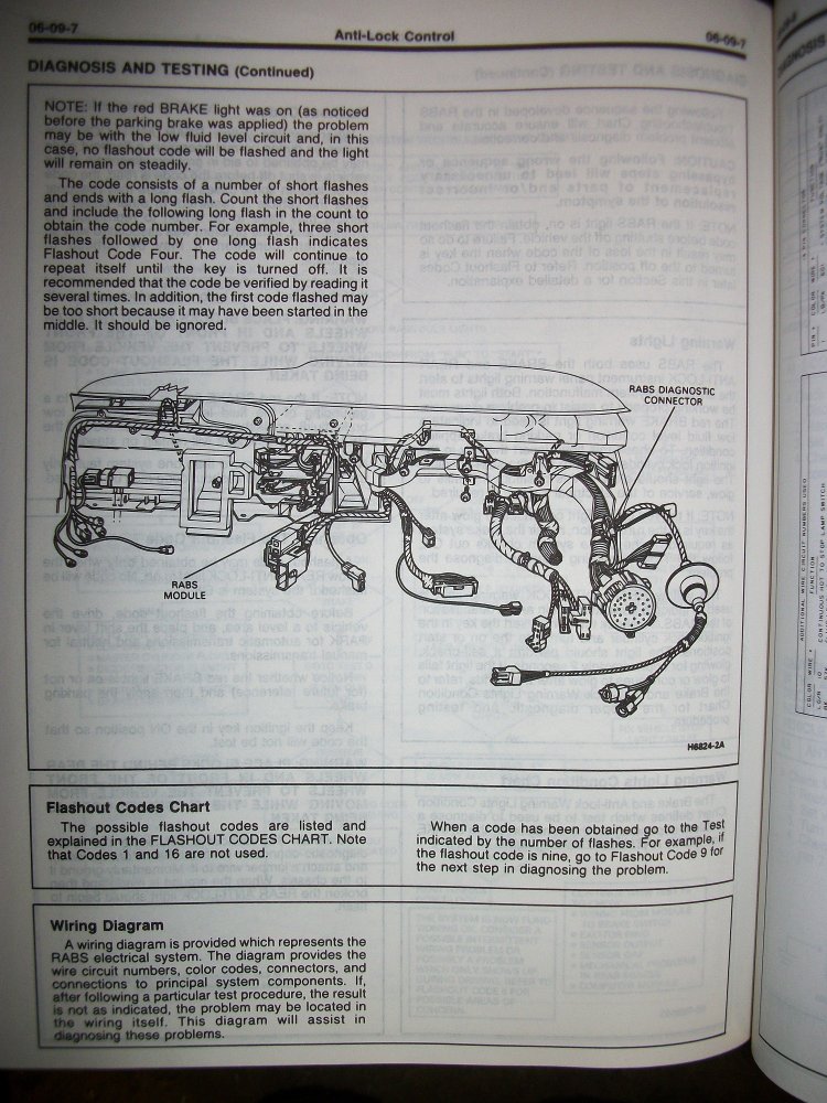

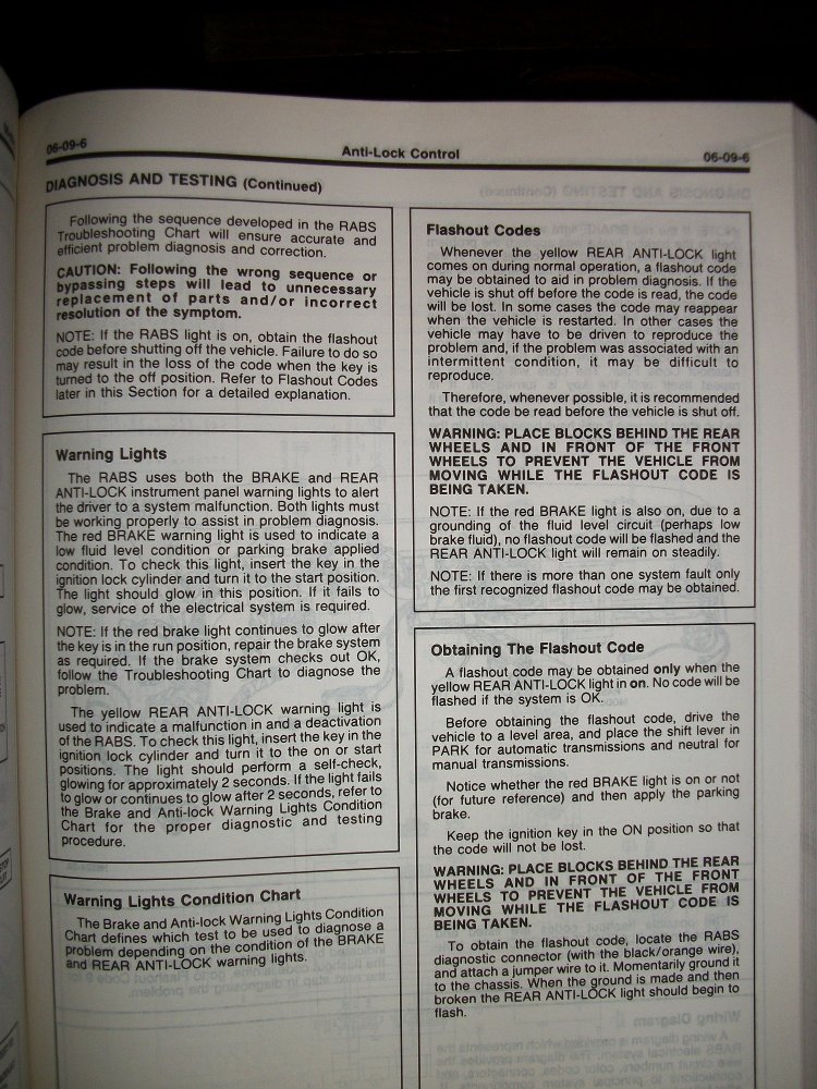

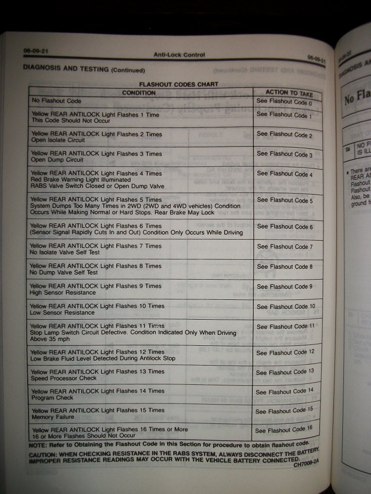

Getting a code for the yellow antilock light being on is different than pulling OBD codes, and the light does have to be on. These four pages (from the 1989 Ranger shop manual) will get you started in the right direction. The RABS diagnostic connector should be easy to find, where your main harness comes in through the firewall behind the fusebox. You should be able to download these pages and enlarge them enough to read. The factory instructions are pretty clear, and once you have a RABS diagnostic code we can go from there. Read through these pages and note how the red "brake" light and the yellow "RABS" light are both used to diagnose the system.

Made some good progress today. The diagnostic connector was easy to find as you mentioned. The code flashed 11 times which indicates "stop lamp circuit defective". I did install some LED bulbs recently. Will do some further research. Your assistance has been incredibly valuable.
-John
Just check the stop lights. Both working fine. We put the regular 1157 bulbs on later today and see if it is the lack of resistance from the LED bulbs.
