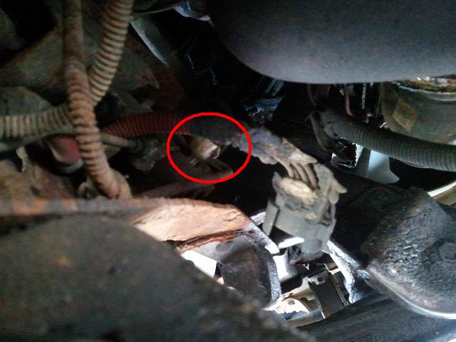

Ever take the pic?
Changed out the sensor and no bueno. So I'm not sure what to check next.
attachment.php
Whoops, it actually is a 4 pin, each sensor wire has it's own ground.
This is on the driver side, about under where the steering column is in the frame rail.

Anyone ever figure out what the issue was? The sensor weezl mentioned a few posts up is the speed sensor in the rear (typical hall effect type sensor). There's a few things that can go wrong with ABS such as the controller or the pump. I asked another BII owner about it not too long ago and he said that it is some sort of pressure switch which gets stuck. I tend to think that he's right because the system seems to work right even with the light on. The sensor (or what I believe to be the sensor) is located under the driver's side floor board closer to the fire wall. Anyone ever replace the sensor in question?
