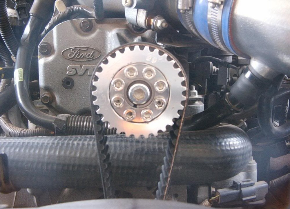

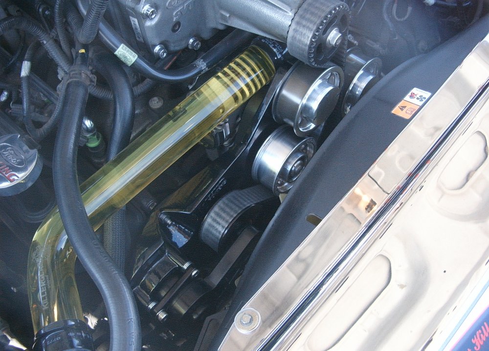

You want everyone to know you have a blower, run cogs on it. The last two are my current set up with a Magnum Powers three idler pulley bridge. That tighter wrap around the upper pulley, made them so loud! They're a love or hate thing. Gt a lot of thumbs up, and a few windows rolled up! LOL The belt tensioner is a custom made manually adjustable model, no springs. Screw and locknut.
