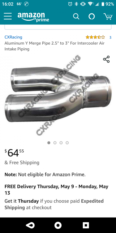

Found a Merkur Scorpio air box. When it arrived, it was a lid and tubes. No box. Freaking eBay... So, found this on amazon:

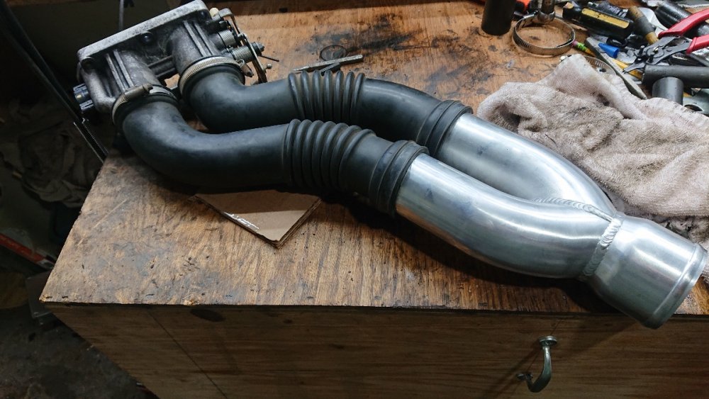

Not exactly an elegant solution, and waaaay too freaking expensive, but it will let me use the Scorpio plenum with a stupid cone filter for now, and attach the intercooler plumbing later.
I've done some reading on throttle bodies both before and after the blower. Have read pros and cons for both. Interested in opinions.

Oh, and x-post from another thread. My twin throttle body adapter showed up. I think it looks phallic. Seems @Bird76Mojo and @Ranger850 disagree.

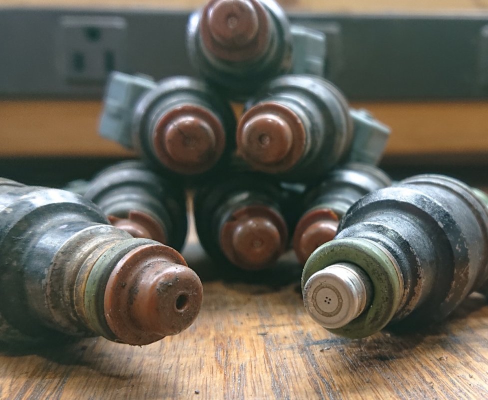

Saleen four hole 24lb injectors are here.
