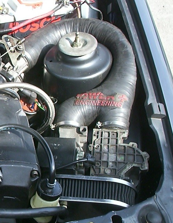

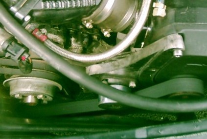

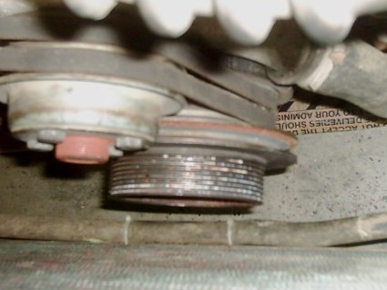

Dug up more photos from UK Sprintex supercharged 2.9s. Apparently there were only 10-12 of them built. Cool. Looks like I'm truly walking a road few have been down.

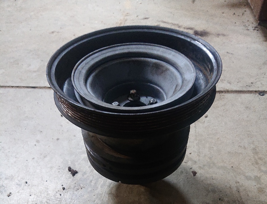

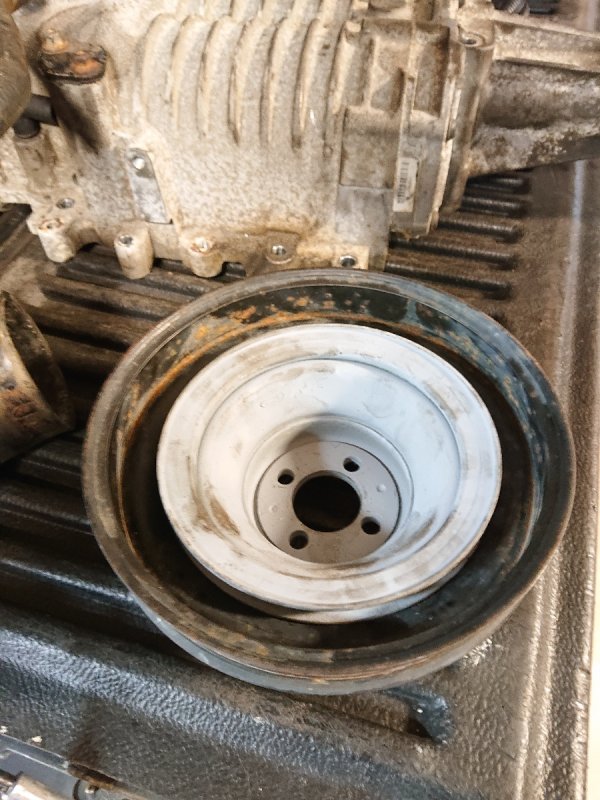

I think I have a belt solution. Just need advice from a better fabricator than myself.
This is a 2.9 crank pulley nested inside of a 3.8 crank pulley.
I'm curious if it would be possible to perfectly center the 2.9 pulley inside of the 3.8 pulley, weld them together, and trim away the mounts of the 3.8 pulley. That would give me the radius I need of the one from the 3.8, and the bolt pattern I need from the 2.9.
Any advice on how to do this? Literally thought about wrapping the 2.9 pulley in electrical tape as a means to center it.

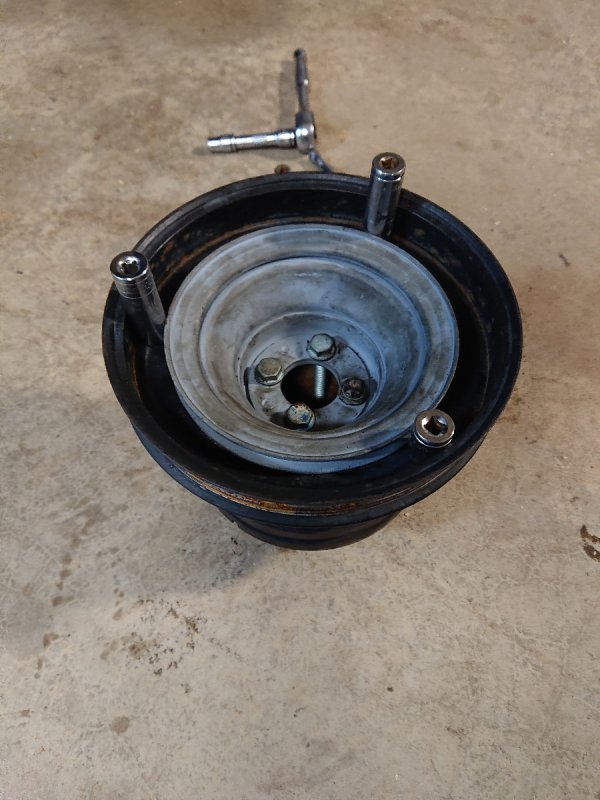

Here's an idea. Turns out the 2.9 pulley will bolt through the 3.8 one with long bolts. Use dowel pins to set the gap the whole way around (12mm socket feels perfect) and weld in place. Trim away the back of the 3.8 pulley after welding front and weld inside. Use lawnmower blade balancer to balance.
I may be able to get within a few thousandths like this.
Son. Of. A. Bitch.
I think this may work.
Someone please poke holes in this before I weld it. Going to check it with calipers in the morning. If I'm within 0.002" the whole way around, I'm guessing I'm ok.
It's gapped out with three identical OD sockets all sitting equally snug, and bolted down evenly and with equal torque. If it's rested flat inside and equal gapped, I'm going to weld it and chuck it up on a drill or something after I cut and balance it.
Damnit if this works I'm in business. It's a 2:1 drive ratio. I'll have to trim the ac drive off of the water pump pulley. But damnit this may work.
Dad had an even better idea. Mount it on the dummy engine, use his runout gauge on it to check for concenteicity on the x and y axis. If its concentric, weld the SOB.
Holy crap. Dodge guys may have gotten this one down for me. They use the 3.8 crank pulleys for attaching the M90 blowers to slant 6 engines. Thanks Dodge! I'll be home soon!
Tack, tack, tack. Then run-out gauge again. 3 more tacks in between and run-out gauge again. Then you should be fine to finish welding. Its surprising how much shrinking weld will pull the metal.
