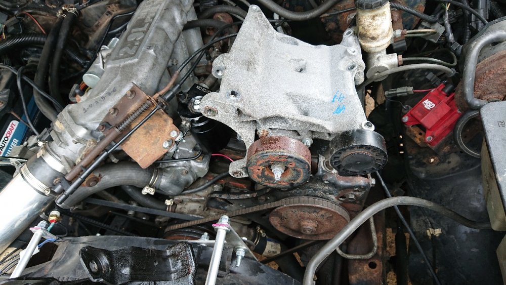

Mercedes C230 blower mounting bracket sitting on top of its future home.
Blower bolts directly to the flat portion.
Too perfect.
