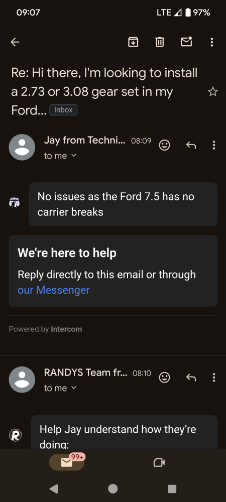

Doing a bit of reading today, I've struggled to find the 3.08 gear set being used with an LSD carrier in the 7.5. Short of having all the parts in my hand to compare, does anyone know if the LSD carrier will even work a 3.08 gear set?
I seem to remember SN95 mustangs having LSDs and 3.08 gear sets, but I'm having trouble confirming.
As far as I know, the only difference in an open carrier and an LSD is the guts in the carrier. The part where the ring gear bolts to should be the same. At least it was on my '98 with the 7.5. Since you already have the carrier, clearance for the tone ring (if you have one) will be a nonissue since the carrier will already have the relief for it.
I think you're right, I've hesitated on pulling the trigger on the gears just a moment after reading about issues some folks have had in re-gearing their 2.73s up to 3.73 or higher. I emailed the folks at Yukon Gear to get a solid answer, hopefully they'll be able to confirm.
The official answer from Yukon Gear:

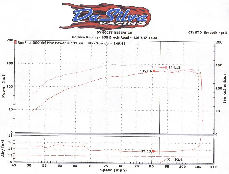

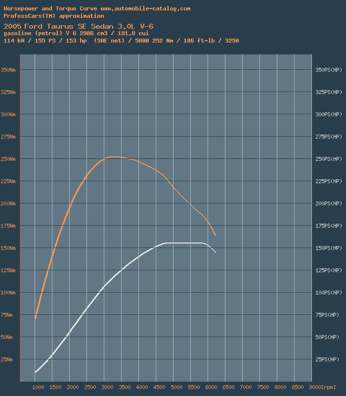

I know power dyno graphs aren't exactly the efficiency calculation we're looking for, but you may be right in saying that I'm already in or near the ideal RPM range. Given that the truck makes most of it's power between 2500-3500 RPM.
These graphs were posted previously on the forum, and do not super accurately represent the 3.0 Vulcan as it's used in the Ford Ranger, but definitely food for thought:
This is the Vulcan in a 2005 Taurus:

What's interesting is that the air/fuel ratio really does lean out on the one test after 70 MpH, I've got no information as to what transmission is being used, but it ought to be running in it's final drive ratio for a dyno-test.
That could explain why I was able to achieve pretty good fuel economy despite the high RPM. I should definitely consider dropping down to a 3.45/3.55 instead after I do some more number crunching.
