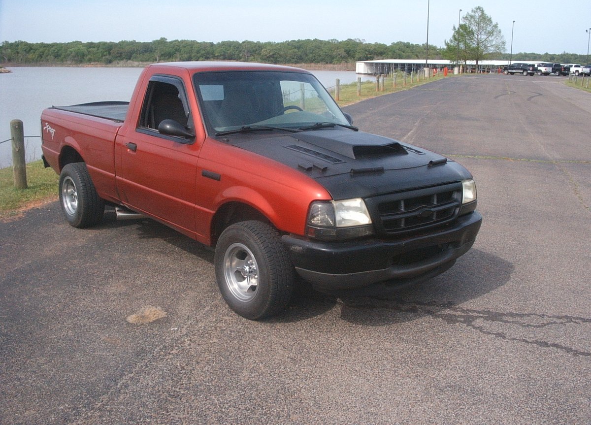

My truck has a bumpy hood, looking for one of those old school hood tachs. So far all I find is stuff
Re-Gearing 7.5 LSD from 3.73 to 3.08, manufacturer recommendations for Ring and Pinion Gear set.
for V-8's. None calibrated for a six cylinder.
