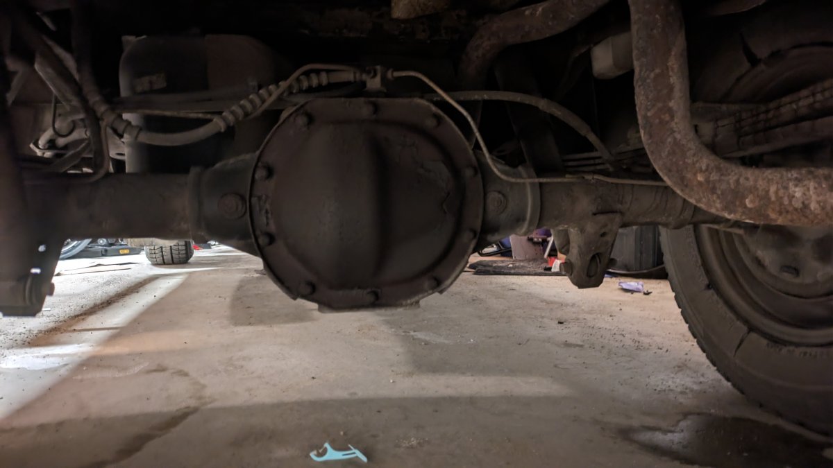

Alrighty folks, here's the confirmation you've all been waiting for:
It's a 4.10, LSD, in a 7.5 axle.
As I mentioned in a previous post, I marked a tire and counted the rotations needed from the drive shaft, and at speed the RPMs line up with a 4.10 ratio. I confirmed it was an LSD by... laying down some 11s on dry bare pavement with my winter tires.
And here's visual confirmation that it is in fact a Ford 7.5 under there:
