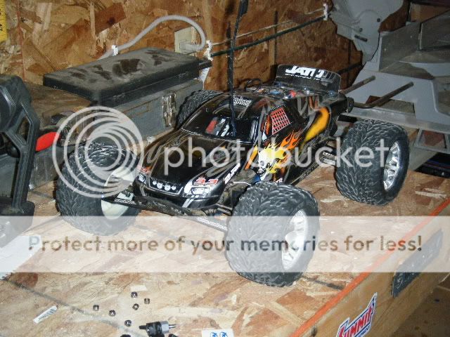

Here it is. Jato 3.3. This thing is a rocket. 65+ out of the box. Did a few things to get a few mph's. Three shoe clutch, lightweight flywheel, aluminum rear arms, shock tower, and rear arm braces, Avid bearings, K&N intake, and exhaust mods.
It's all ripped apart right now to turn it into an offroad setup with lift, wheel/tires, shocks, and gearing. Then I can really break some parts!

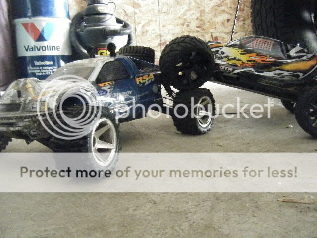

My older HPI RS4 mt and the Jato

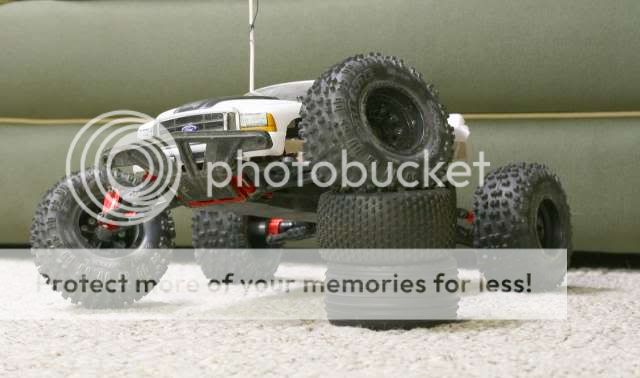

Traxxas nitro revo. It was a 3.3 but got it off my friend minus the motor and slapped my spare 2.5 in it. Its all mostly stock right now but i redid the shocks and have it set up nice.
Looks sweet! What exactly did you convert?
Plan on keeping the Talons on there?
I switched out the front spindles to a Rustler setup so I can run hex wheels all the way around. The Jato comes with just hexes in the back, and finding bigger wheels for a Jato sucks. So now I can run just about any wheel and tire combo I want. Also, changed the springs and raised it up for more clearance, and got rid of the sway bars. Now I am contemplating changing it to a 20T gear for a little more torque with the bigger wheels.
And yeah, keeping the talons for sure.

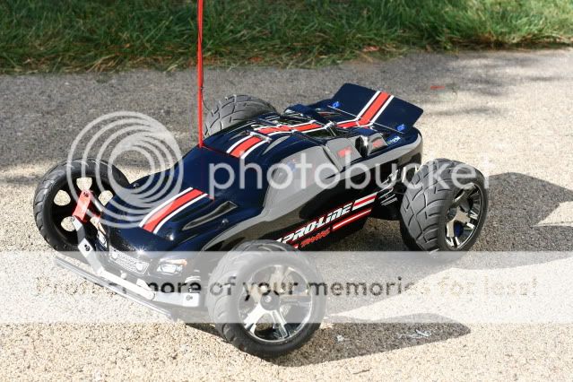

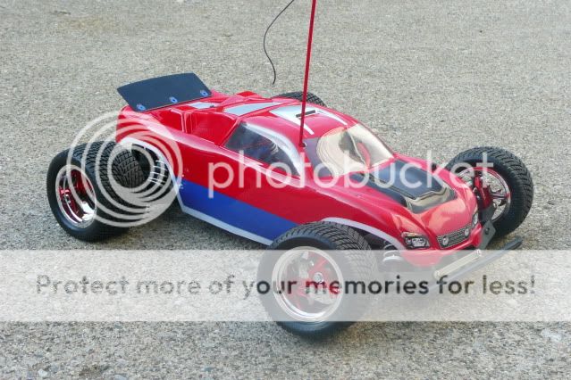

Here's my 2 latest bodies for my street Rustler...

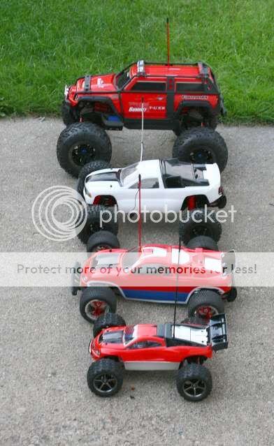

And the current fleet - Summit, two Rustlers, and mini Revo:

That's an awesome collection you have there. I really like those badlands, maybe after I rip the talons apart that will have to be my next set.
