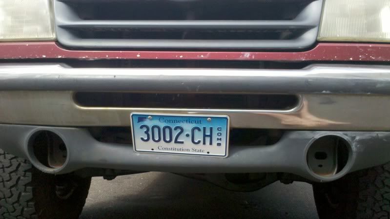

decided to clean up my bumper a bit. top looked like old chrome but the bottom was just really yellow and gross looking. these are my results. i started on the right of the picture
Ravo's Ranger

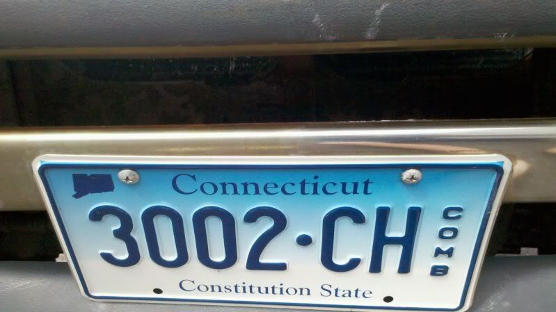

look at right above the plate. you caan see the color difference
Ravo's Ranger
this is the side i hadn't done yet
Ravo's Ranger
the bottom still isnt quite there. but better than it was

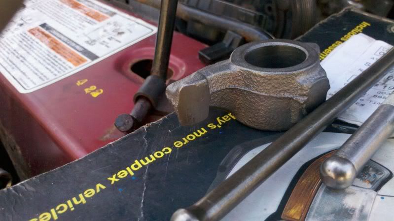

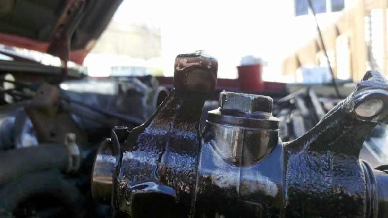

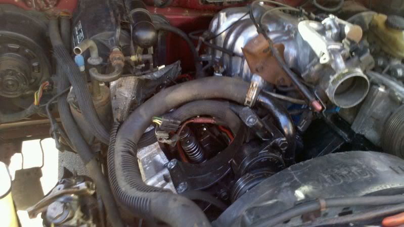

so i finally started the engine teardown to get rid of my diesel clack that has been going on. i knew i had one bad rocker/push rod but what i found was surprising.
Ravo's Ranger
turns out all of them aren't far behind. i had bought one set to fix the problem but i just ordered the other 5 which will come in tomorrow. the valve stems destroyed the rockers over her long life.
Ravo's Ranger
close up
Ravo's Ranger
new one
Ravo's Ranger
notice how there isn't a huge hole in the end. i like that a lot better. i'm gonna do the other side in a month or so once i save up more money. if this side is this bad the other side can't be far behind
also i can't wait for the extra power due to the valves being able to open all the way. the one really bad rocker could move freely about 1/4"

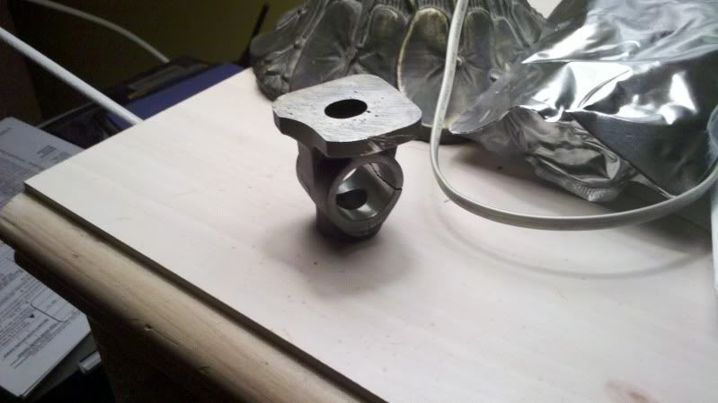

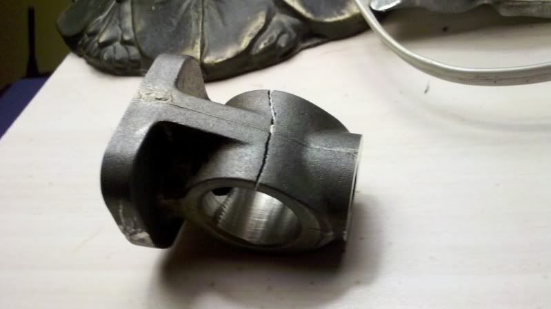

anyone know what this part is technically called and also if it is a stealership part. it is the rocker arm shaft pedestal. it is cracked. i really dont want to spend 50 bucks on something i can find at i can get for cheap
Ravo's Ranger
Ravo's Ranger
it looks like i found a part number. 89TM 6531AB
so i finally got the part through ford. 12 bucks with my dads company discount. not bad. got it today. got the rocker arm back together. should be putting it all back together when i get off work. don't worry. i know how much you guys like pictures

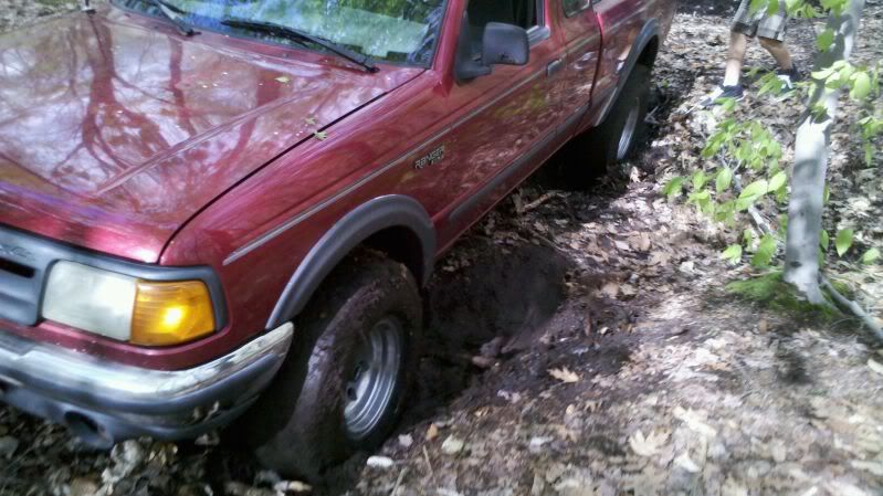

so i took my truck wheeling today. actually yesterday. its early and im tired. i broke my fog valence but ill fix it up with a bit of fiberglass and new bolts and such. i ended up getting stuck on a log with my front dif. lucky my dad came to the rescue with his sport trac. just a bit of tension and one guy rocking it was more than 4 guys rocking and pushing could do. ill post pics in the am
so first got it stuck in the mud
Ravo's Ranger
turned my tires into slicks. then when i want to cross a log my front end slid down to the thicker part before going over and getting my meatball stuck. heres the aftermath

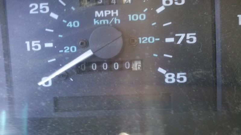

So everyone doubted me about getting 20+ mpg on the highway with a 4.0, 32s, and 3.73s. I can honestly say that I get 20 mpg on the highway. Drove up to my sisters house for the weekend. 105 miles each way by my odometer. So I ended up going 210 miles and used just over 10 gallons of gas. Also I've noticed I smell gas after I drive so that's 20 mpg with a small gas leak. I'm very pleased. At 70 mph I was running 2300 rpm. Can't really ask for a better crusing speed

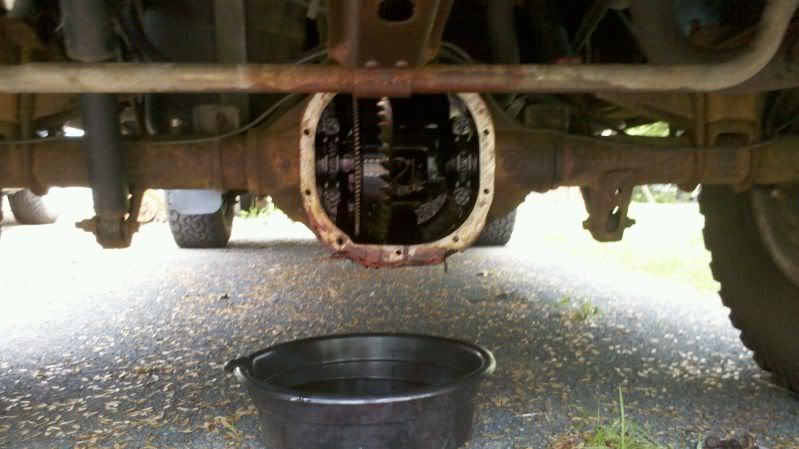

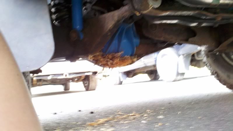

so i've been noticing that i have a dif leak and that one side of my cover is always wet
Ravo's Ranger

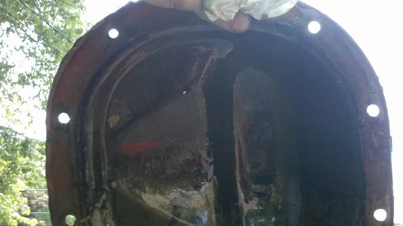

took it apart
Ravo's Ranger
and look what i found
Ravo's Ranger
theres a hole. so i'm either gonna buy a new cover or weld it up or jbweld it for now. i'm gonna switch over to an ex 8.8 when i get the money anyway so everything will be "new"

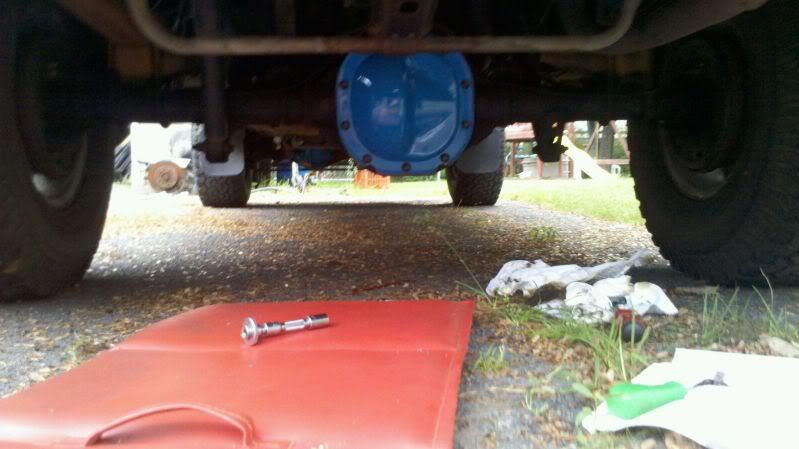

got a new red diff cover. painted ford blue to match the front

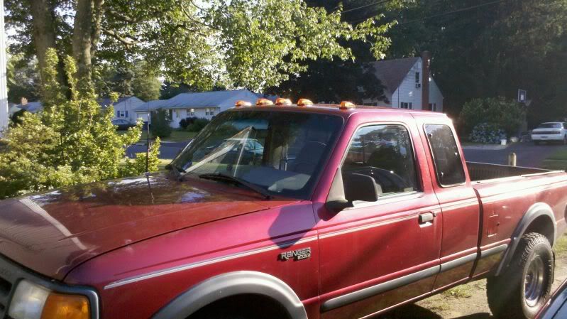

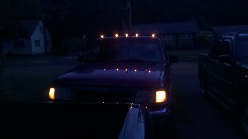

bought a set of cab lights
