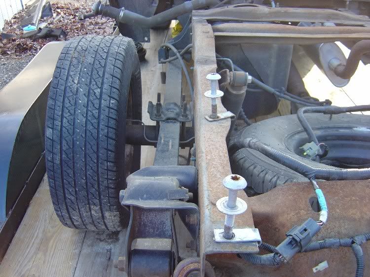

Hey, how much are the Explorer spring mounts? Also, why are you moving the springs under the frame?

more room for tires is my guess
EXACTLY!
Call me CRAZY, but I figured what the heck!:icon_twisted:
Stock:
Now picture that with springs UNDER the frame, and excuse my lame drawin skills, but heres my intent:
I have decided to go with a 29 X 15.50 X 15 Hoosier Pro Street tires and Weld Draglites............all INSIDE the wheelwell, my have to mini-tub the box a lil', will have to wait & see after I get a spare grand for the wheels & tires.:icon_surprised:
You can fit 275/60's in the wheel wells using deeper backspaced wheels.

Lookin for more tire without modifyin the frame majorly.......

I'm moving springs under the frame on my Ranger for a different reason, more flex and lift...
Yes, mine are dealer items, but I believe they are now obsolete through Ford, you would just have to check...........
My springs are gonna be located at the same points, just moved under the frame, so unless your usin some higher arched springs, I don't see any lift advantage:icon_confused:..........
Don't suppose you have a part number? I'm using Tundra springs. THey certainly have an arch to them, and I can get rid of blocks. By using a shackle mounted under the frame gives me some lift too. But I wanted the springs closer together to allow more travel at the wheels... At least, thats the current plan...
