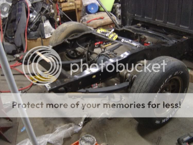

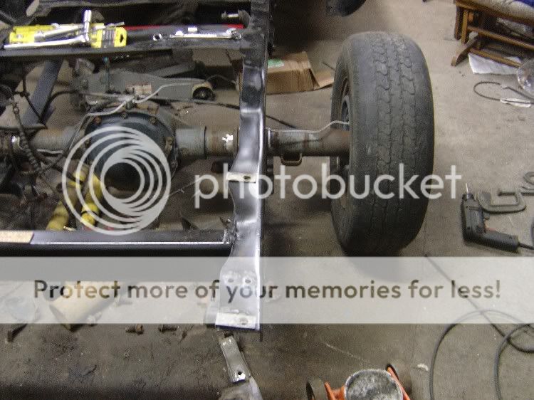

Rear suspension mod done with the exception of weldin the spring perches once I get the pinion angle set & get my new shackles......
Rat Ranger Build

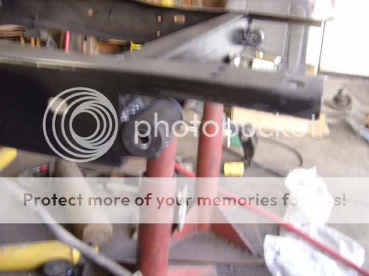

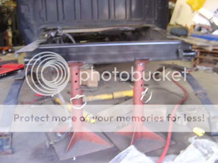

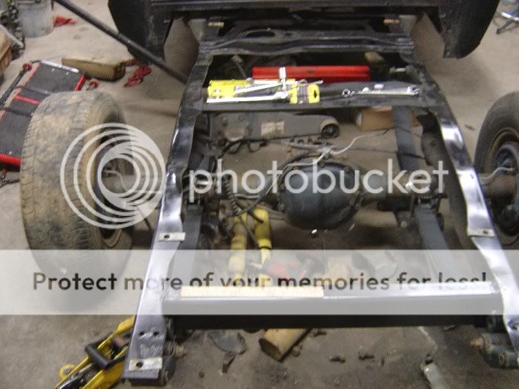

Rear crossmember removed, notched rear frame horns, installed 2X4 tubin to rigid it up, and made shackle mounts out of black pipe that fit some bushings I found::icon_welder:
Rat Ranger Build
BUKOO room for Pro Street tires now::yahoo:
Rat Ranger Build
Rat Ranger Build
Done for now:

Are you going to gusset those shackle mount bushings on the frame horns? Or box them in somehow?
Ummm.........
Don't plan too, as the are welded to 1/4" angle iron, and then the angle iron is welded to the rear crossmember.......
Didn't see the angle. I always think offroad overkill though.
