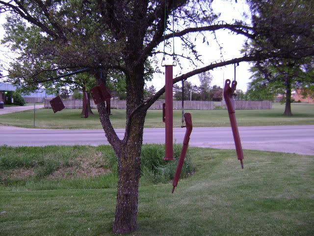

Slung some more primer and dark grey on the front suspension parts.

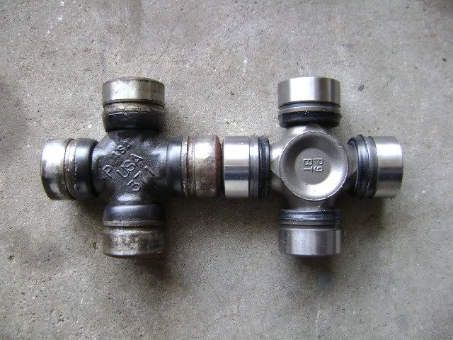

Contacted the driveline company on the u-joint and they had 1 out my way yesterday.

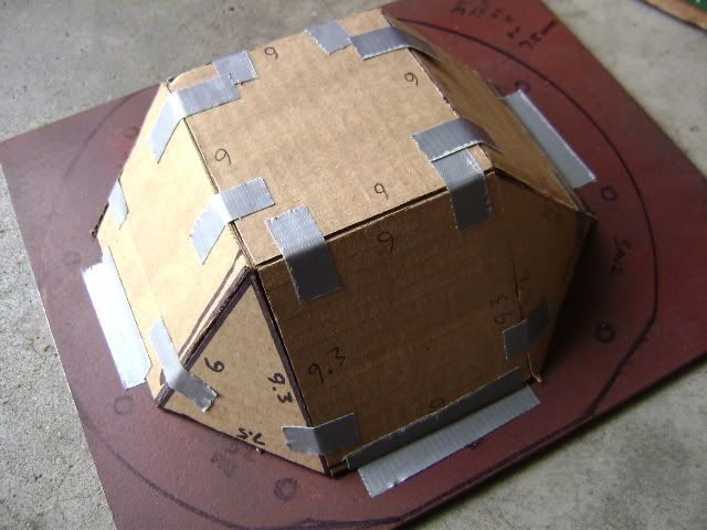

I think I may have enough 1/4" to whip up a diff cover for my 7.5.....we'll see.

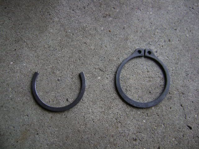

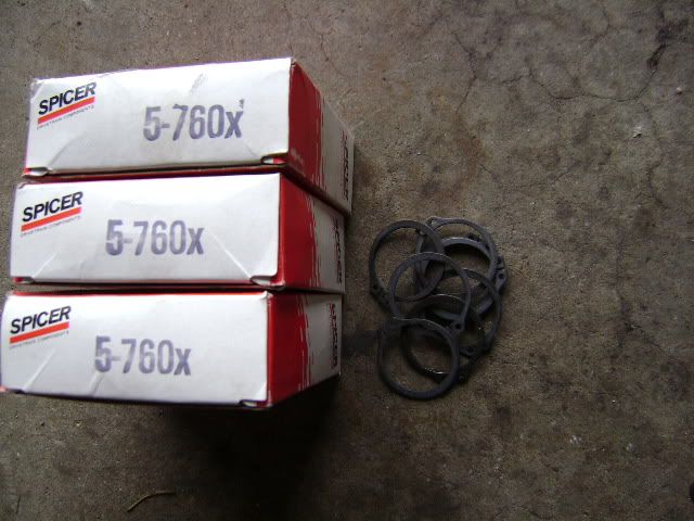

Shafts all put together:
e/c clip eliminator Spring, that Echo P/N spring for a weed wacker.
Clearance at the shaft yoke next to the clip yoke.

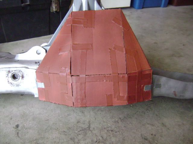

Nevermind that diff cover pattern. I have a much better one. Cleaner.
