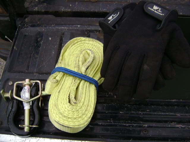

Got together a recovery box:
There will be more added, but it's a start.
