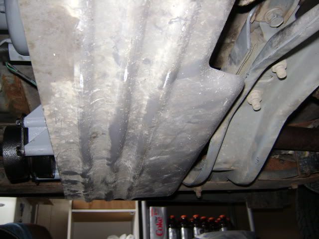

Always have protection!
Skid installed fo' my D35.

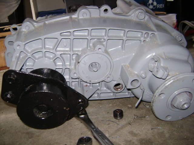

Good t-case swapped in:
This was my biggest problem on the last one===>
That and it looked like poo.....
The nice one......

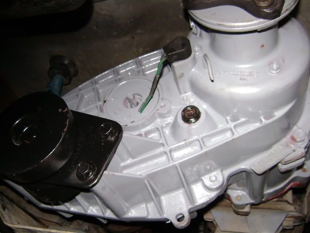

Installed:
With a skid:

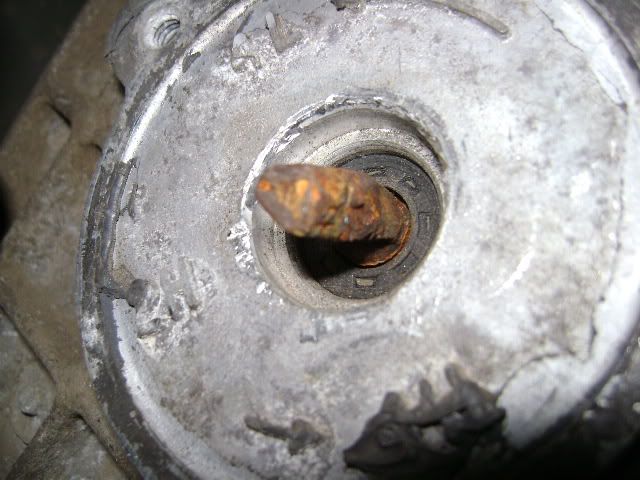

I didn't have a chance to snap pictures when I installed, but here is where I had to clearance the tooth on my 7.5 in order to remove the cross pin. I have 4.10 gears.

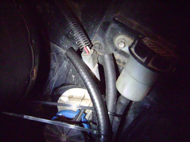

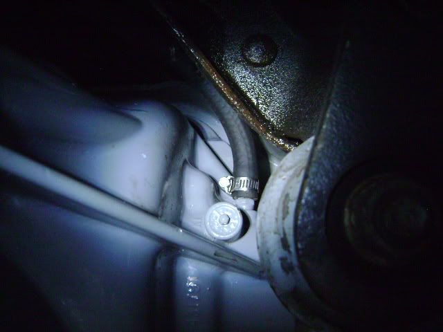

Then ran the extended breather lines for the t-case and front axle.
I clamped them nice and tight, and routed them to up by the master cylinder res. If water get up there, I'm already in DEEP trouble.
I'll figure the rear axle out tomorrow.....
Lookin good!
Thanks!

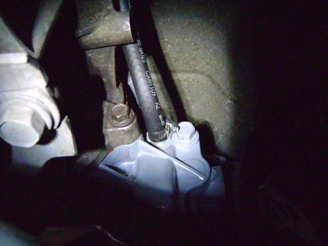

I routed the rear diff tube up to about the rear tail light on the driver's side. I took the original clip that held it in place and put it on a seam in the bed side, and routed it and clipped it. I put a hose clamp on the end so it wouldn't slide back down past that clip.
I installed the shift motor, and put a 20A fuse into the fuse box.......and.......
I HAVE 4x4

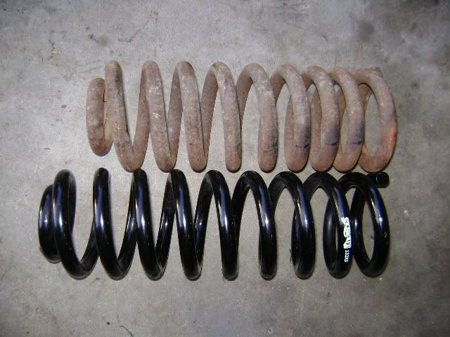

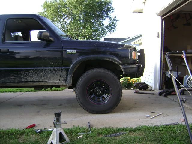

Leveling coil install
I like.
It will need longer shocks, and a few alignment adjustments.....but that didn't stop me from doing this.......
Just a teaser....
