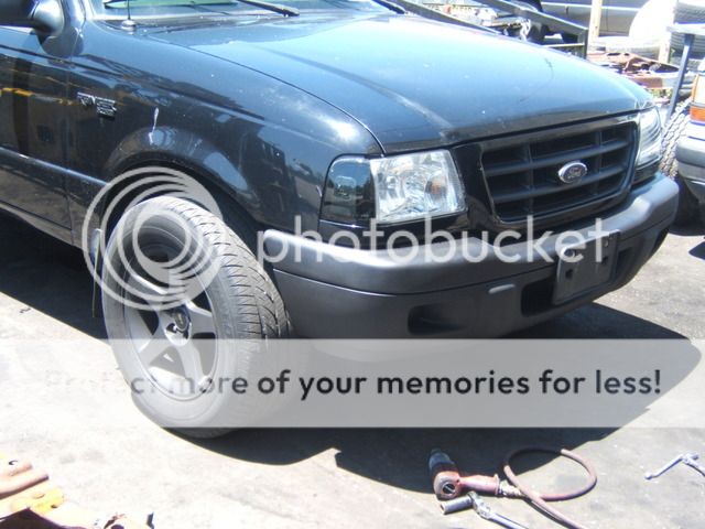

I ran 245/45ZR17s "car tires" on my last Ranger for around 10 years.
