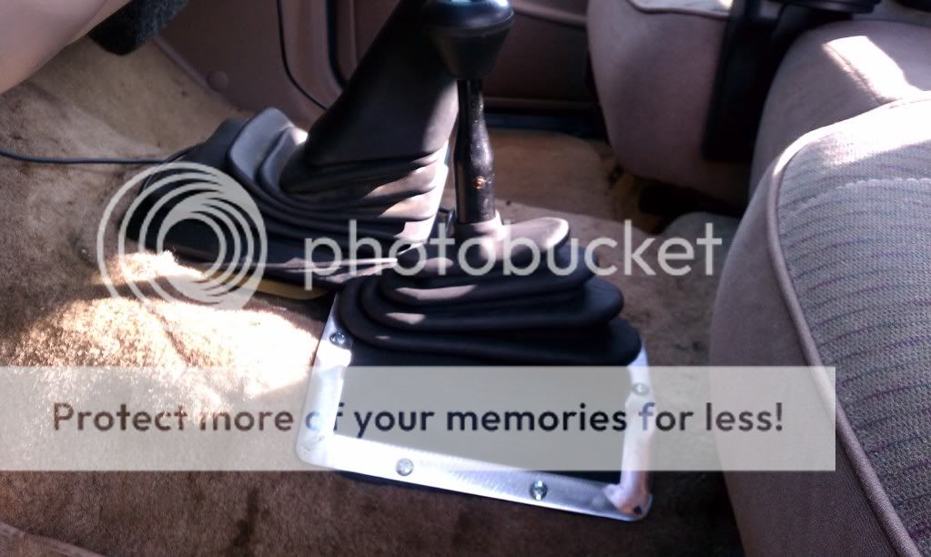

I finally installed the t case shifter.
Since i have a 2" body lift, the shifter barelly made it into the cab hahaha
ill see if we can extend it a couple inches.

Did a bit more on the shifters.
I tried a CV boot as a shifter boot, and seems like it doesnt look that bad.

I still need to install some rubber stripes to seal it a bit more.
I wanna leave it as sealed as possible. so no water, noise, heat or dust will come inside the cab.

Here is what I did. It is a boot for a 70's CJ7.
