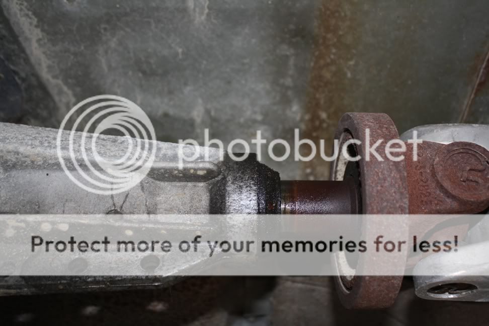

my shaft has this on the trans side:
so im wondering if i can do something like this, so i can use that flange to weld it on the new driveshaft.

Ok i finally got a 4wd driveshaft to use to build my own.
i just found out mine isnt aluminum, its steel.
my bros ext cab had an aluminum one. that was what had me living on a mistake haha
im planning on leaving the rear of my driveshaft untouched(axle flange)
have it cut to the lenght i need, put the telescopic thing from this one on mine, and have the machine shop build me a flange for it so i can bolt it on my trans.
