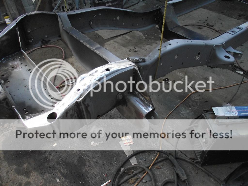

i've been doing some work on the frame,trying to get it ready for paint.i wasn't happy with the area around the winch tray and steering box,so some time was spent cleaning this stuff up.
ranger refit/build thread
where the steering box bolts up was boxed in,and there was some sloppy looking work on the winch tray.

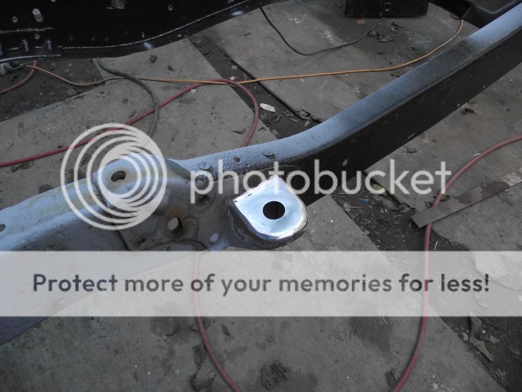

there was a lot of cleanup on the trac-bar bracket as well.

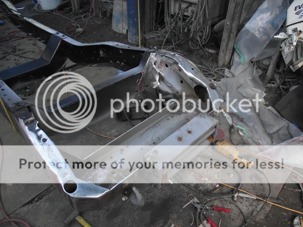

while the front cab mounts were in good shape,the rear ones were rusted to the point that there was nothing left to sit the body mount on.these were fixed up with some new metal.

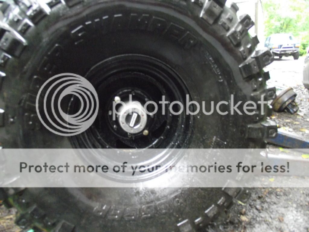

the wheels were all given a coat of basic black urethane over an epoxy primer.hopefully this will keep the rust at bay for a little while.

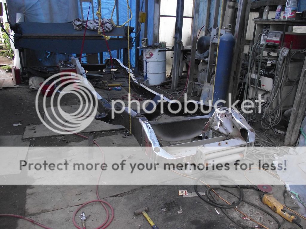

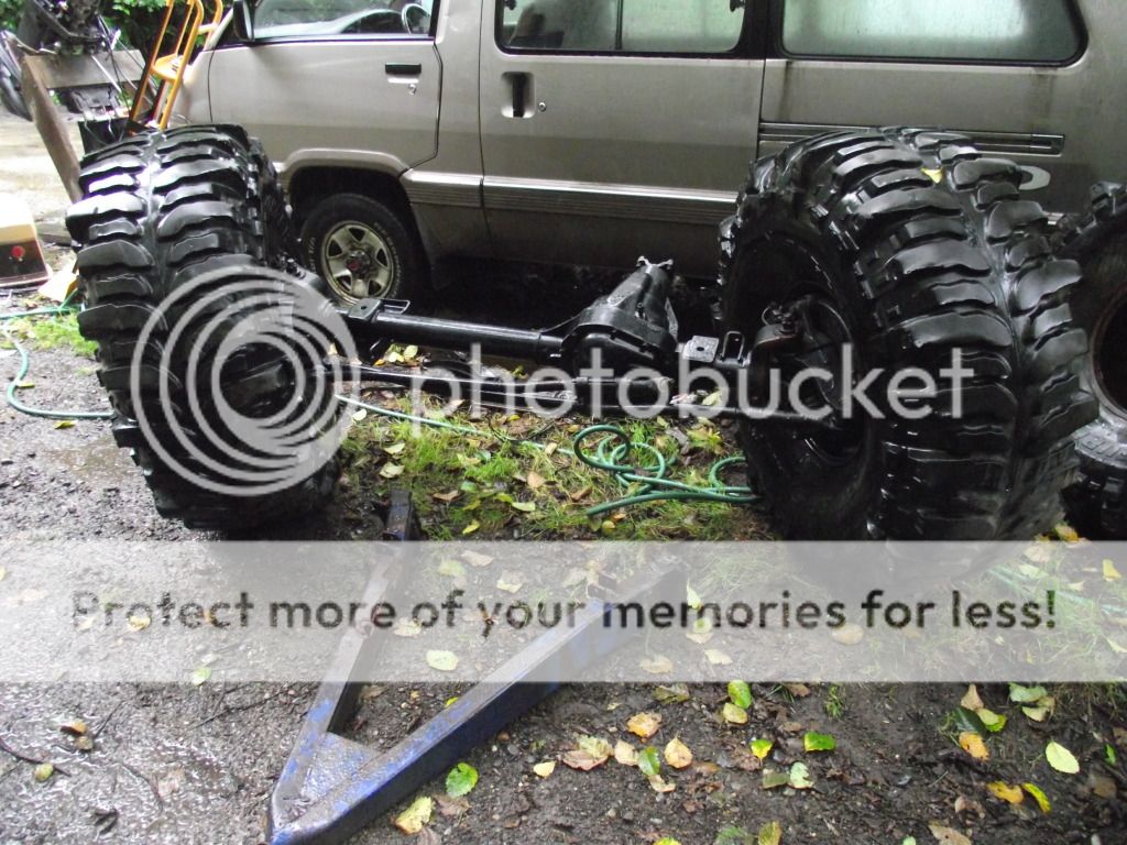

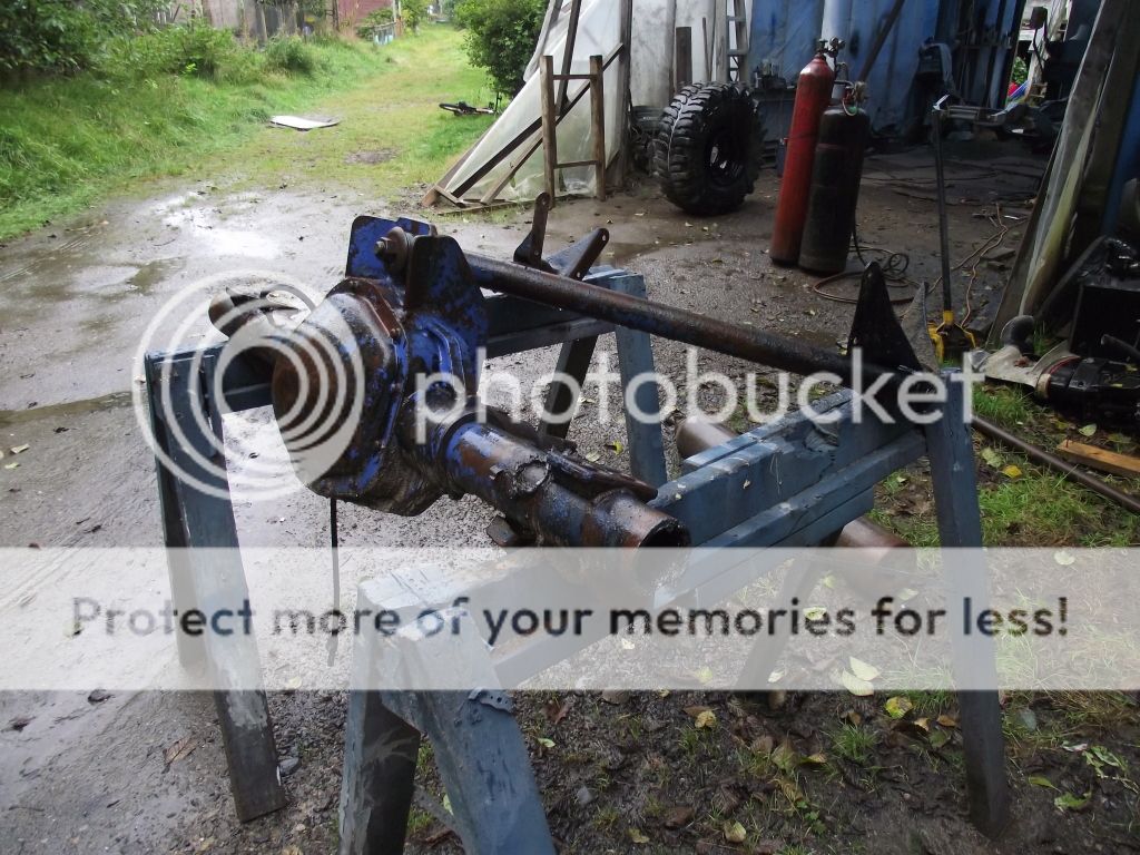

i've bucked the ends off the rear in preparation for widening,and have the axle tubes cut off a donor sterling to weld on.i have to at least get this thing back onto it's wheels before winter sets in,it's a pain having it spread all over the yard.

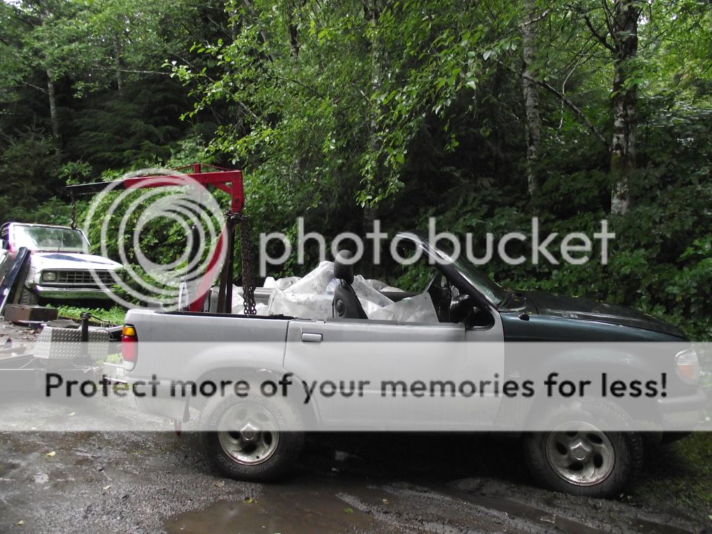

i had a problem in this project with having to move a bunch of heavy things around.the problem was solved by chaining the engine hoist into the back of the explorer.it only took a few minutes to do,and allows me to pick up and easilly move up to about 1000lbs.
i see a more permanent folding version of this idea being built into this rig,when not in use it would be folded flat to the floor.it's also very handy for moving outboard motors around and setting them on boats.
