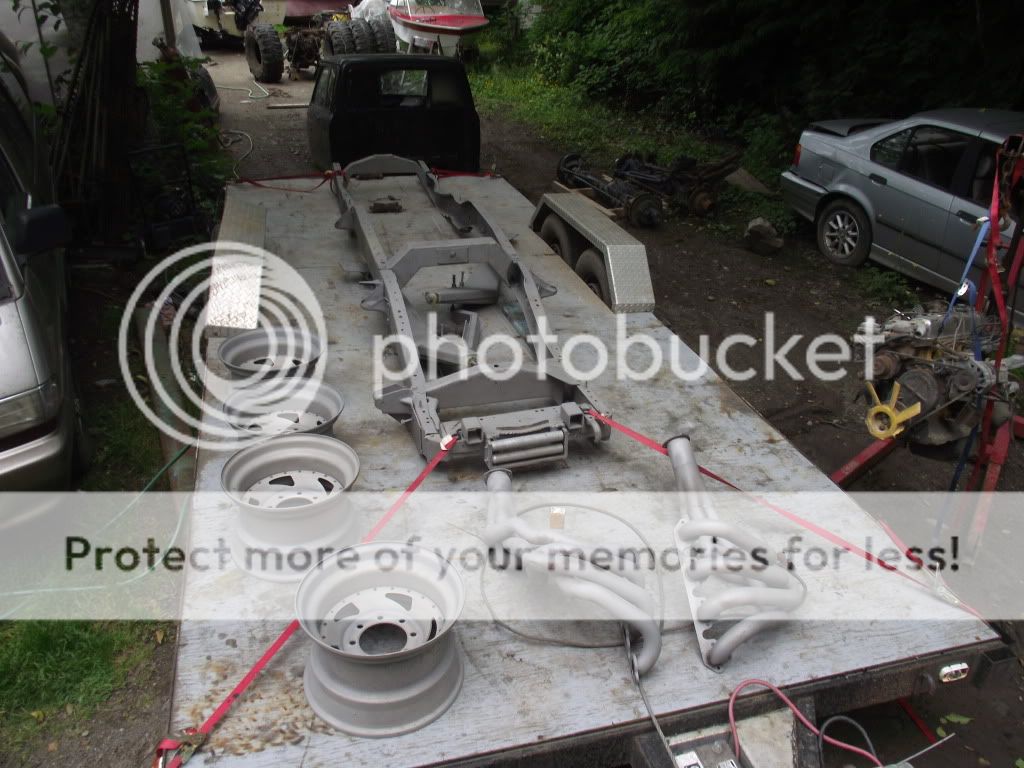

so i just got back from sandblasting,eveything looks really good but i have to get some primer on it right away because i'm seeing a light rust color forming on it already.

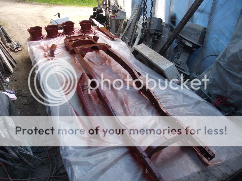

i got some epoxy primer on the bare metal so it's got some protection.after finishing the metalwork on the frame,it'll get urethane primer as a base for the topcoat,which will be a single stage urethane in gloss black.
should look pretty good,and hopefully the salt air here won't get a bite on it too soon.

you need to have it epoxy primer, reg primer won't stop rust.
also, pretty.
Are these the new frame rails that bought and took all apart??? because the old frame has stress cracks in it ???
Robert
that is epoxy on it.
soaks into the blasted metal nicely.the old frame had cracks,plus i wanted an extra-cab as there was no room in the standard cab.

well,i sure don't have that much into this one.the blasting was done in trade for rebuilding the leg from an outboard,then a couple hundred for primer...i should be good for a while.
