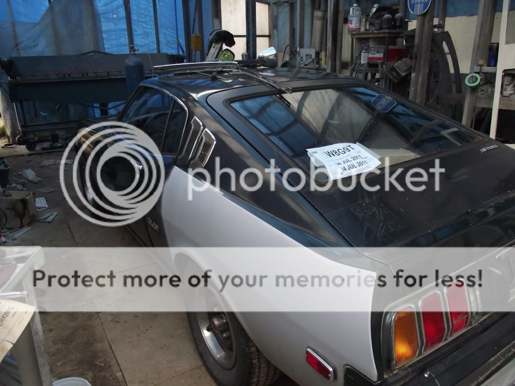

in the mean time,this is what ate up most of the last month...

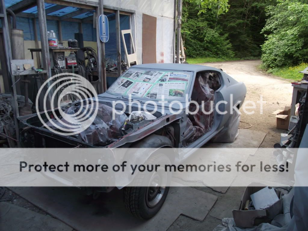

i had a repaint to do on a 75 Celica.this required pretty much tearing down the whole car as it was a color change,plus the previous bodywork was pretty crude.
torn down,primed,and blocked-the shell is ready for paint.

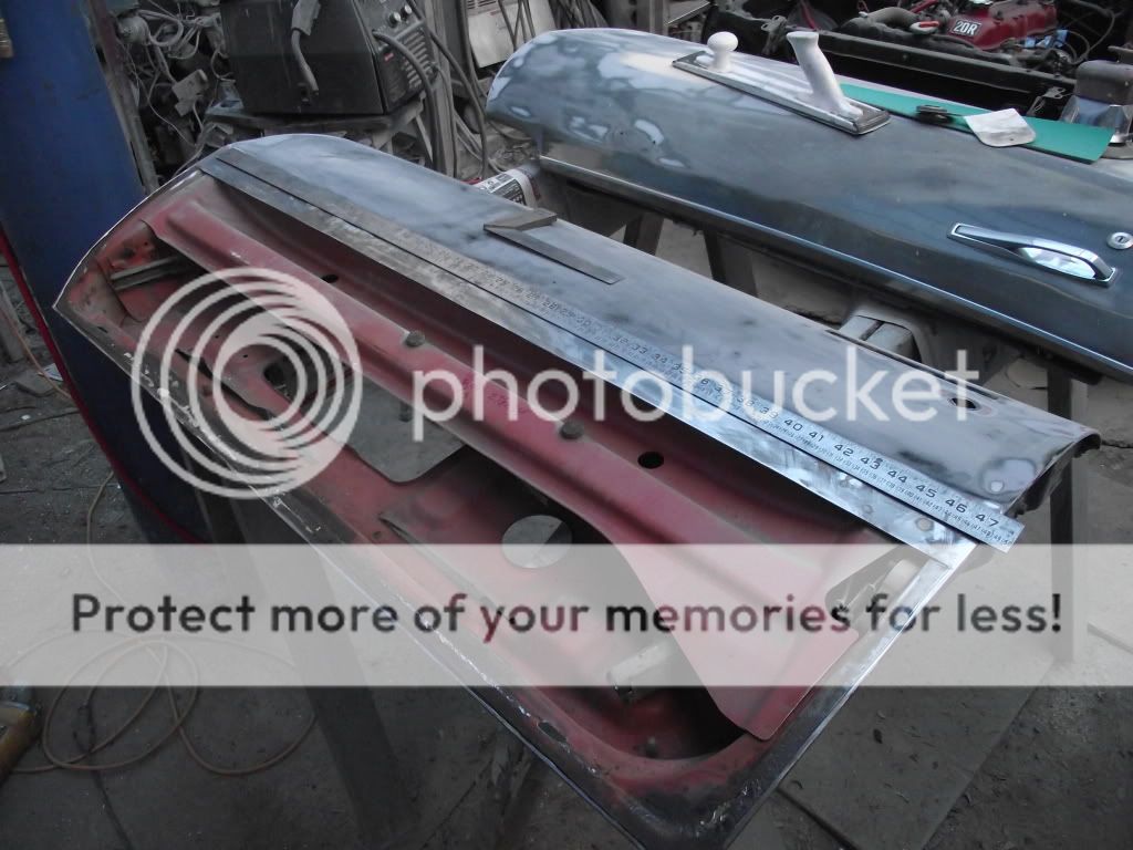

turned out the driver's door had some serious issues,so...
i chopped it out,

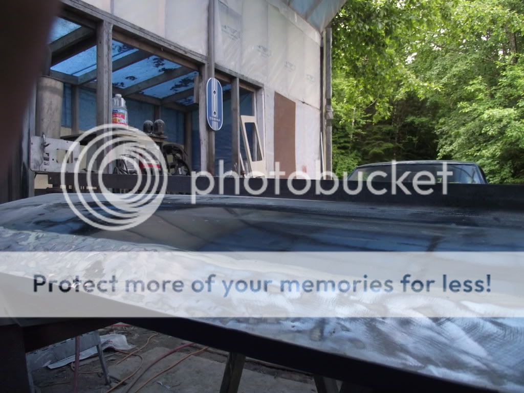

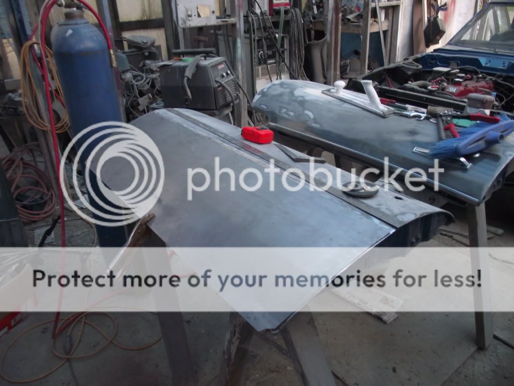

formed up a new panel,

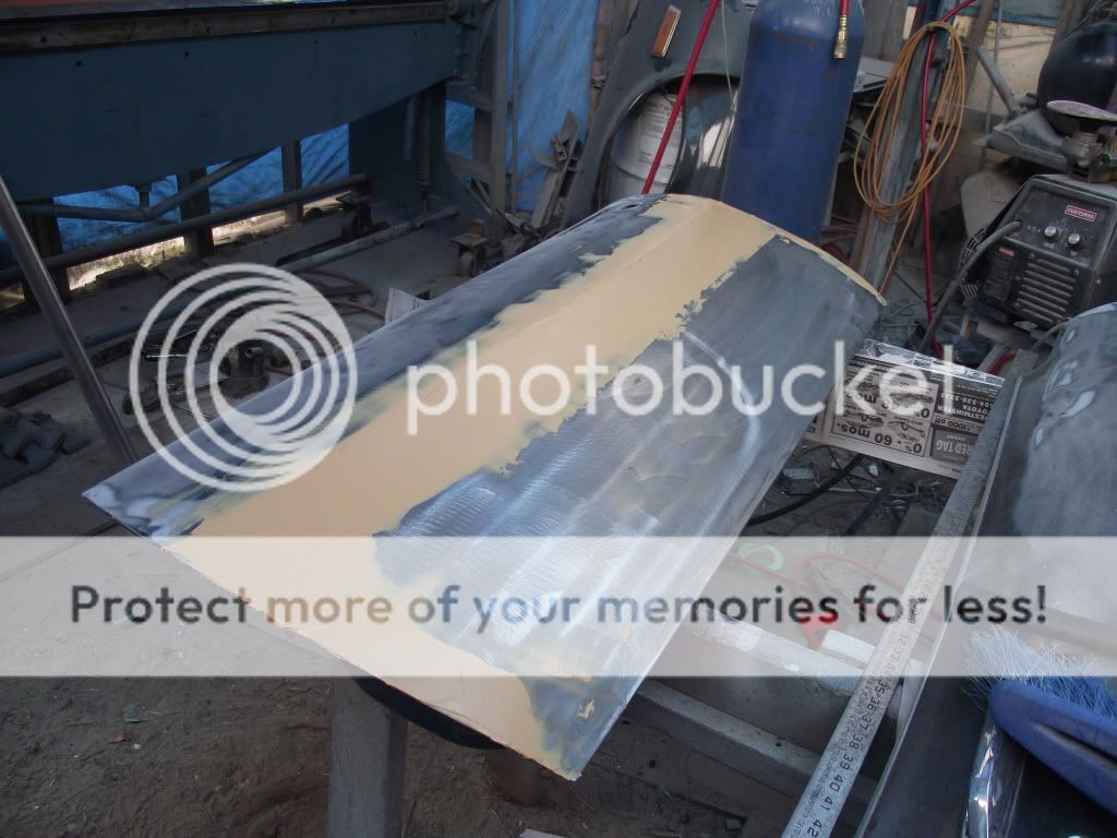

and buzzed it in.a skim of filler cleans up the weld.

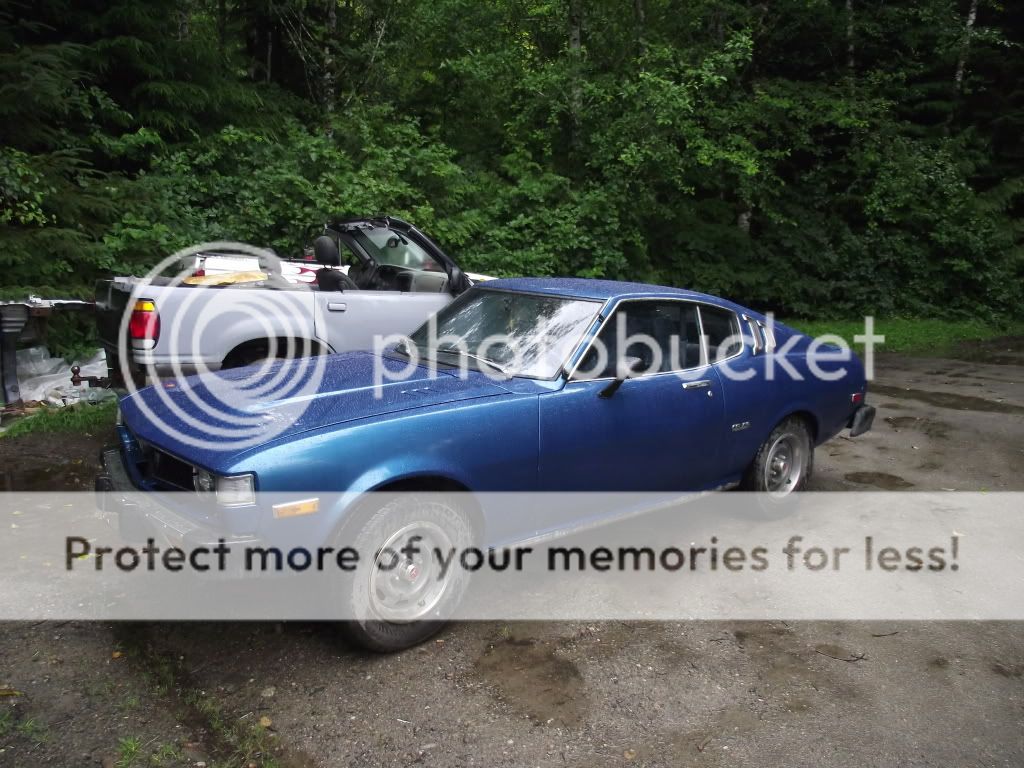

the pictures don't do it justice,but the color is a nice aqua blue with a high pearl content.

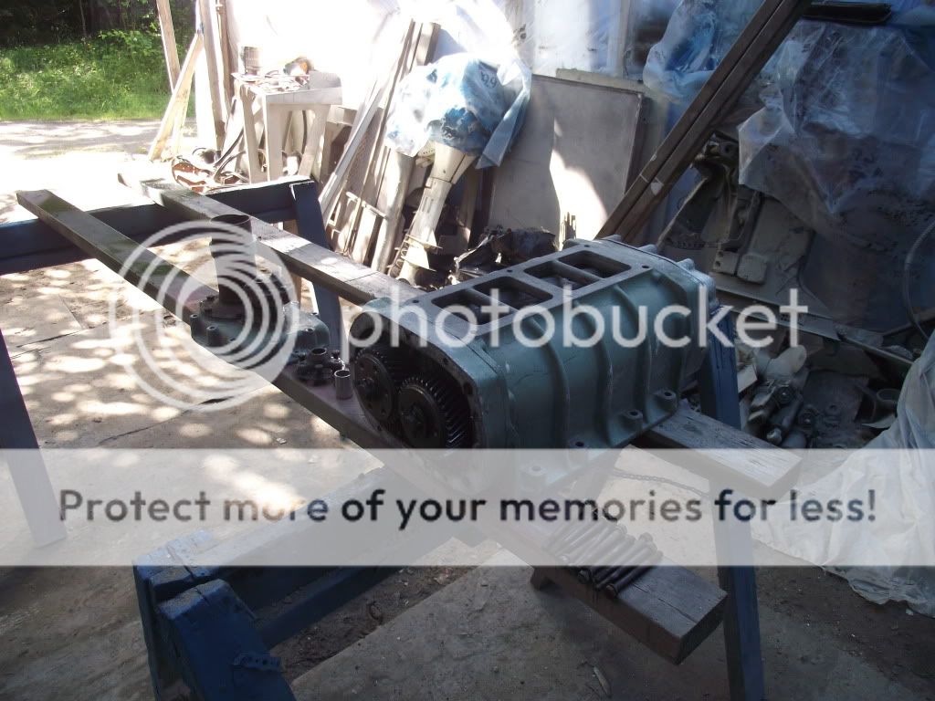

a little something i just bought,who knows where it'll end up;
needs new bearings and a bit of cleanup,but overall it seems in reasonable condition.paid $70 for it.
Celica...I always loved the older ones. Nice paint job by the way.
Sweet Celica! A good friend of mine has a '76 that's getting a 2.3T... It's almost done. :headbang:
this one took way longer than i first expected,but i figured it was worth the time.other than a few minor rust spots that i repaired properly(not like the bondoed-over mess i removed)it's really solid...certainly worth the effort,and the owner is happy with it too.

yup.i went to a tool sale at an outfit where the owner had died,that was sitting on the floor so i made an offer on it.figured even if it were no good i could hang it on the wall by the cobra air cleaner cover.
as it turns out,it won't take much to get it operational.

Did it come with the base plate for mounting it on the engine????
Robert
Robert
nope,just what you see there.if i mount it to the 460 there are intakes available,though i'd probably just make my own.i have to hunt down drive systems for it,and do a bit of studying on boost levels and such as i've never run one of these things before.
i'm thinking i'll try it out on a stock 460 at first as they are pretty tough,but more important,they are cheap and plentiful so if i grenade one it's no big deal...$150 will buy another.
