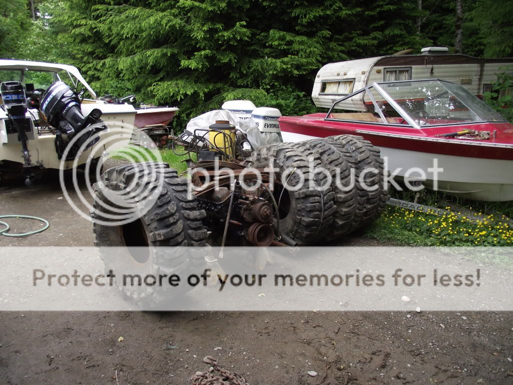

the tires are off the rims now,and will wait by the engine for the opportunity to rejoin the(freshly painted)wheels once again.
the rear needs some cleanup still,and new brakes as the ones that were on it were 'borrowed' for the f350 when i got it.the ranger had new brakes all around it wasn't using and stretch needed them,so off they went.
now it's time to repay the debt.

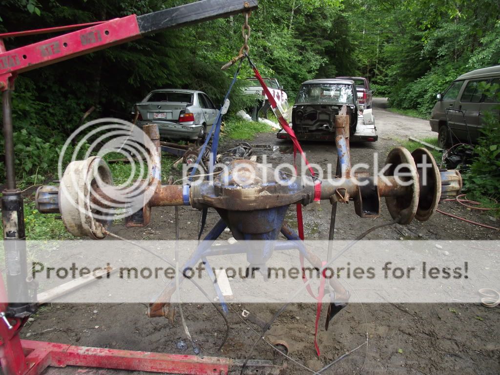

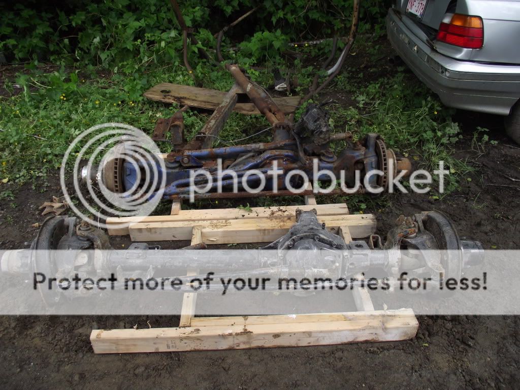

the front will be picking up some width here.the d50 was narrowed some,and has a wms width of 61''.the d60 is 69'' wide.the rear,which i narrowed around 3 and a bit inches is 63'' wide.this means the front wheels will poke out 3'' further on a side than the rears.
i don't feel like setting up another rear end,so i guess i'll live with that.

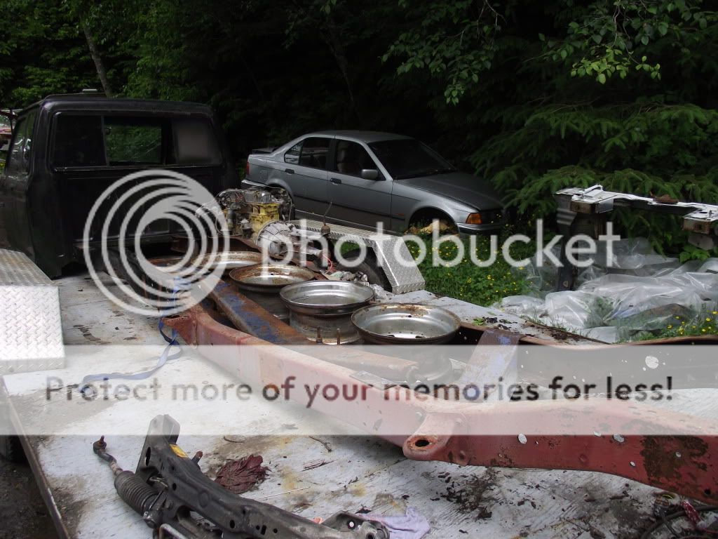

the frame,arms,and wheels are loaded up and ready to go.
the cab and gt6 engine are just there because it's a convenient place to keep them for now.
why are you ditching the correct width d60 for the smaller 50?
and i've always been curious, any reason you couldn't run the right hub on the left side, and the left hub on the right side, then put the tierod on top of the mounting points for them on the spindles (so it runs over the pinion) and then the drag link somewhere near the back too (not that you have much in your way)
that way the steering components are behind the massive solid axle for protection?
of course with that simple setup like that, left would be right, and right would be left... but that could be countered by simply turning the steering box around 180* to face backwards, so a push would be a pull and a pull would be a push...
um.....other way around,bud.
the 50 is what came out of it,the wider 60 is what's going in.i doubt i'll change anything on the steering for now-if you look closely you'll notice that the pitman end of the drag link is right in line with the old one.at this point,the more things that just bolt up,the better.
ahh, well that makes more sense then! lol
would that work though? what i said?
Any hints on narrowing up a sterling Tom? I'm looking at doing it soon...my ranger is going 1 tons this winter.
it could be made to work.
i touched on that a bit earlier in this thread,by useing two short-side axles and shortening the one long tube to suit the short axle.this will result in the 63'' width i have.any other width will require custom axles.
you'll like the sterling...it's practically indestructable.
I've already narrowed my front d60...it's sitting at just shy of 62" wms to wms.
Now I just have to find a sterling...I've got a rear 60 available that is free but i hear they aren't the greatest option unless you upgrade to 35 spline shafts. Decisions...
the way i see it is free is better.... the $ you'd spend buying a 14 bolt would be about the same as building the 60 to do 35 splines now i havnt actually looked into this but its kinda hard to argue with free
sterlings are everywhere.i've got a bunch of them,but it would cost more to come get one than to find one there.i'd stay away from the 60...the cost of upgrading it woud be more than just buying a 10.25,you'd get a weaker diff,and then there's the whole brake service issue.
while 1'' difference between the front and rear diffs is no issue,if you really wanted you could probably cut 1/2'' from the end of each axle and cut the tubes to suit,getting a 62'' wms on the rear.there should be enough spline to do this,but if you do want to,double check the axle spline engagement with the side gears to make sure.it's not something i've personally tried with this diff.
