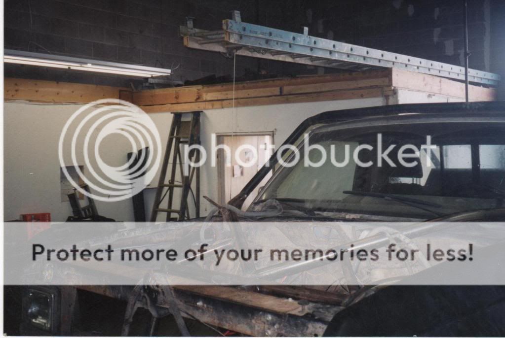

so with the engine taking up most of the bed, whats under the hood? have you turned it into a "trunk" of sorts?
no room there.there's thr front section of the cage goes through there and the shocks are there as well as the battery tray.
as for this thing,while i was at the frame,i added some tubes from the cage down to the front of the frame,
this helped stiffen it up substantially,as now the cage spanned from the very front of the frame to the rear.
here's a bit of what i'm talking about.
