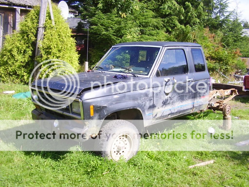

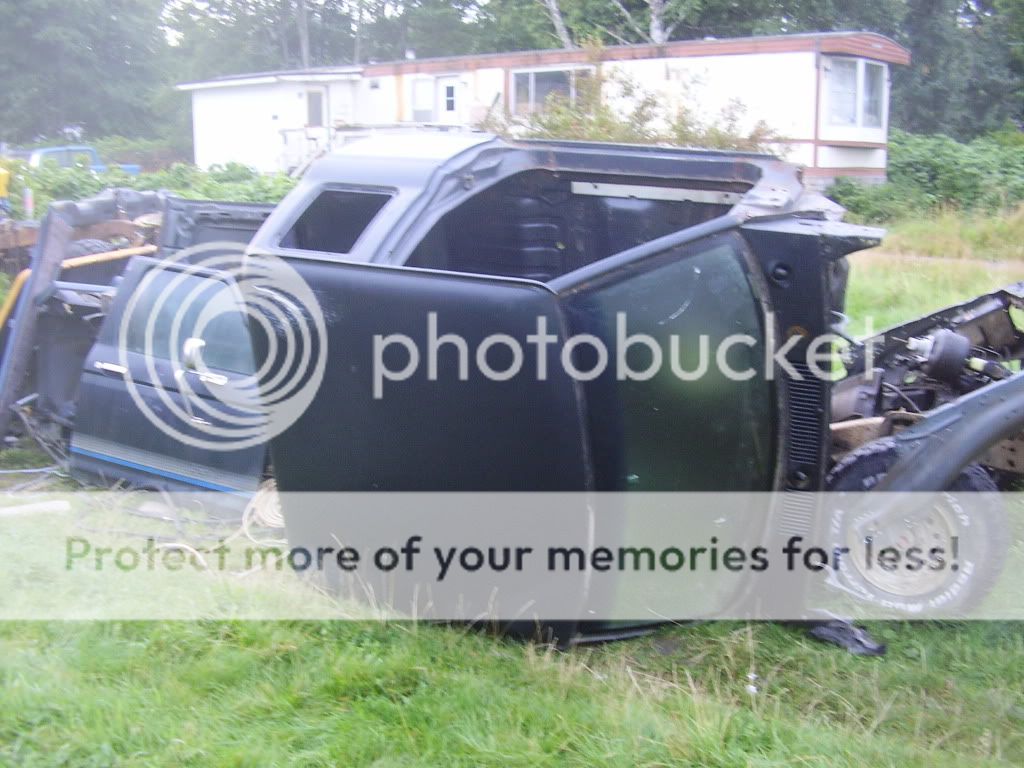

came upon this.looks pretty rough,but it's not too rusty.doors are shot,but i don't need those.cab is good,frame's not too bad either.it'll do,not going to find any better around here.

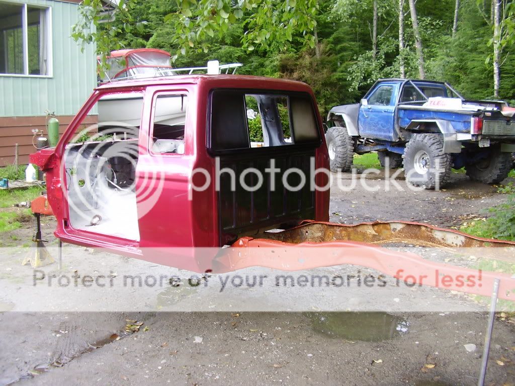

i very carefully removed the cab,after stripping it.
boot.

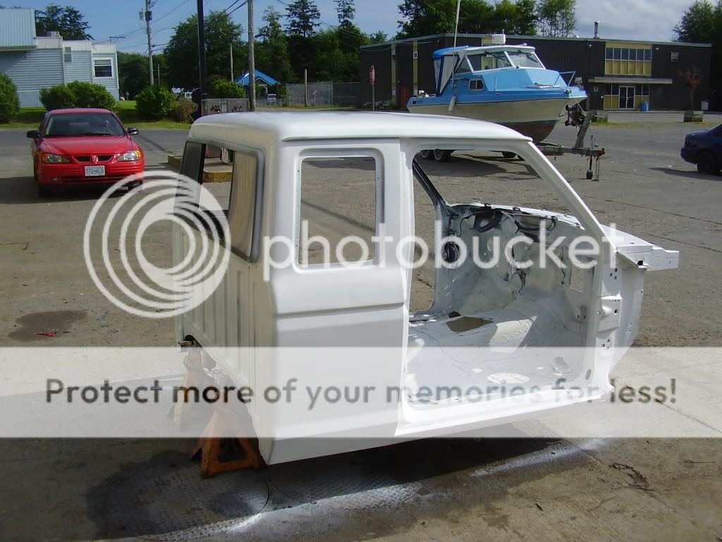

a little prep and some primer....
that's not too bad.

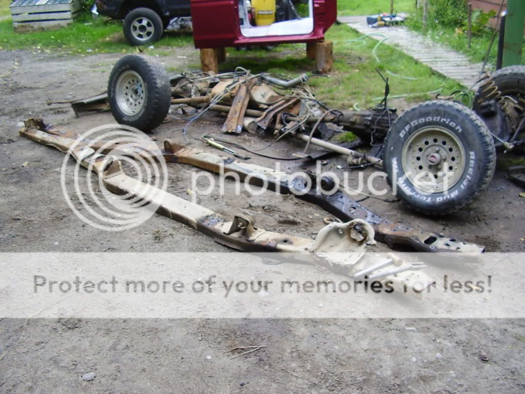

now for the frame

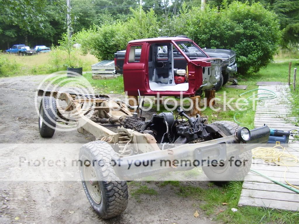

all i need is the bare rails....all that other junk has to go.
note that the cab is wearing a nice red coat now.
gutted like a fish...
after cleaning the rails and putting on a temporary coat of primer,i jigged up the parts so i could start taking measurements.
