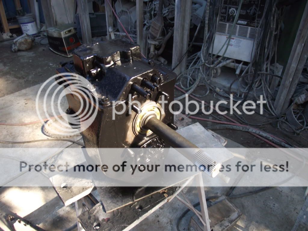

for those interested in such things,i have one of the aux transmissions out-figured i'd show how it's set up.
ranger refit/build thread
this is the input side.a tailshaft housing from a 205 was turned down to index in the input bearing bore in the 435.this supports the shaft in the picture a few pages back and allows a driveshaft to be used as the input.
on the output side,there is not much changed.you can see where the shift tower has been removed and capped.the shift rods were extended through the housing to be linked with individual shifters.
