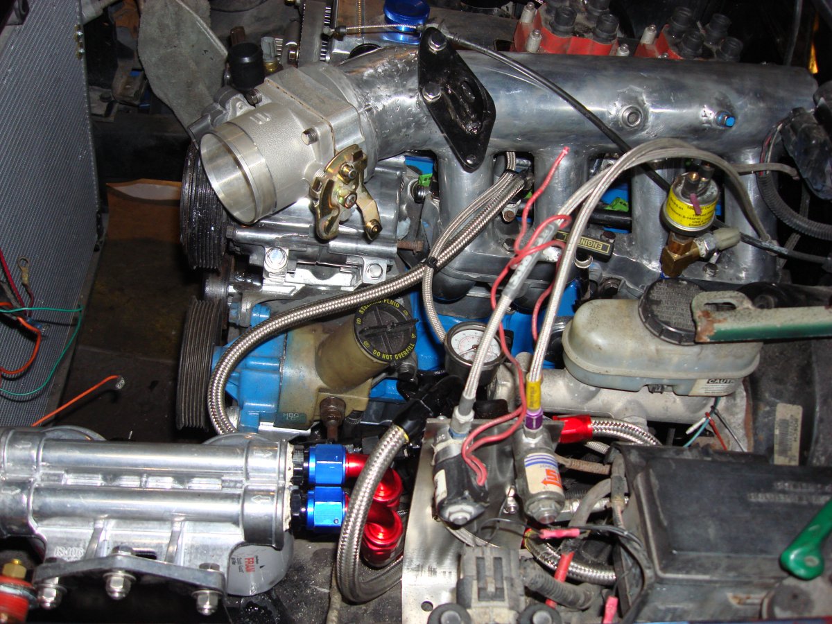

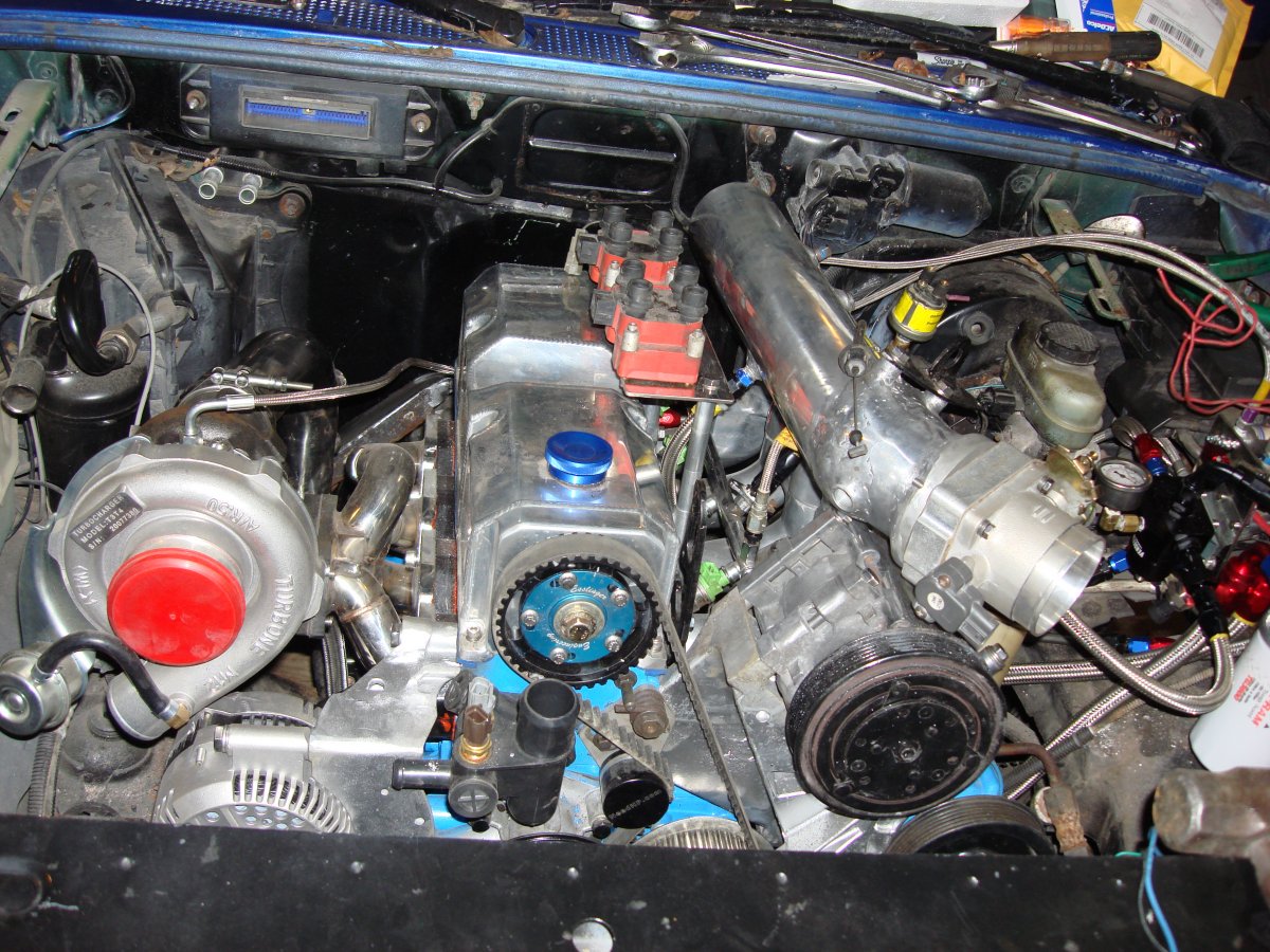

my version of your build. 2000 2.5 with 2.3 crank, cp pistons and h beam rods, 2.5 head ported and polished with 1.89 intakes, 1.59 exhaust, 2.5 bopart cam, turbo and nos

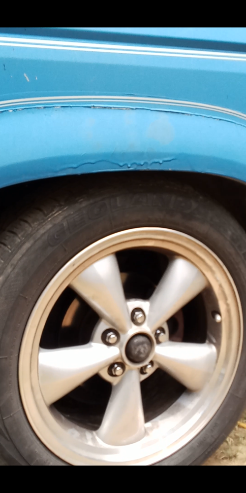

Some almost new 17"s, they knock offs but I like them

my version of your build. 2000 2.5 with 2.3 crank, cp pistons and h beam rods, 2.5 head ported and polished with 1.89 intakes, 1.59 exhaust, 2.5 bopart cam, turbo and nosView attachment 68639View attachment 68640
👍 Nice... I mean not really a version of my build but it is your build and I like it! In my head Its using the terms loosely a touring/cannonball build while my 2.3 fox is my A/X build and my courier is a "drag" build.. have you fired that thing up yet? I'd like to hear that 2.5 cam!!!

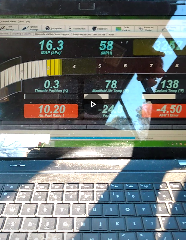

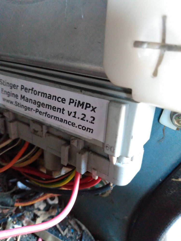

got the pimpx installed and auto tuned for about 30 minutes of driving and truck has never been so smooth.... Still need to work on the cold start and hot restarts and it will be perfect!! Sounds totally different without massair In intake as well. Had to moved pin 32 to pin 52 for dual plug and take 5°timing out the whole table and add a pin for efan but other then that was direct bolt on and go!!!

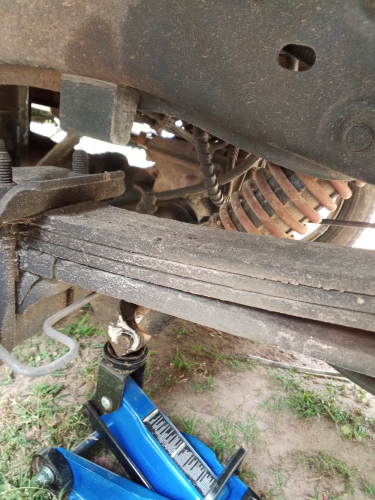

My mustang has been getting a lot of attention lately as I plan to Daily that when the ranger gets motor swap. I have done a few things on the build aside from buying parts.

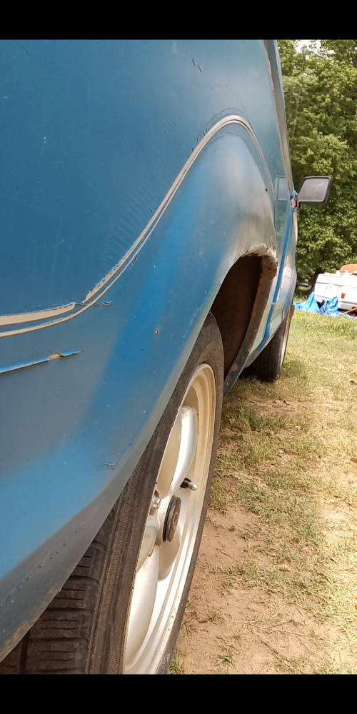

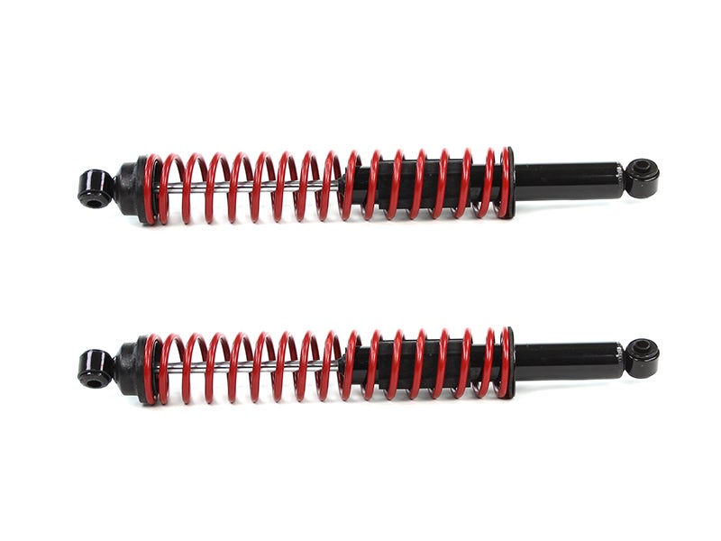

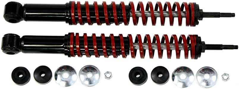

Old set of Monroe load carrier coil over rear struts

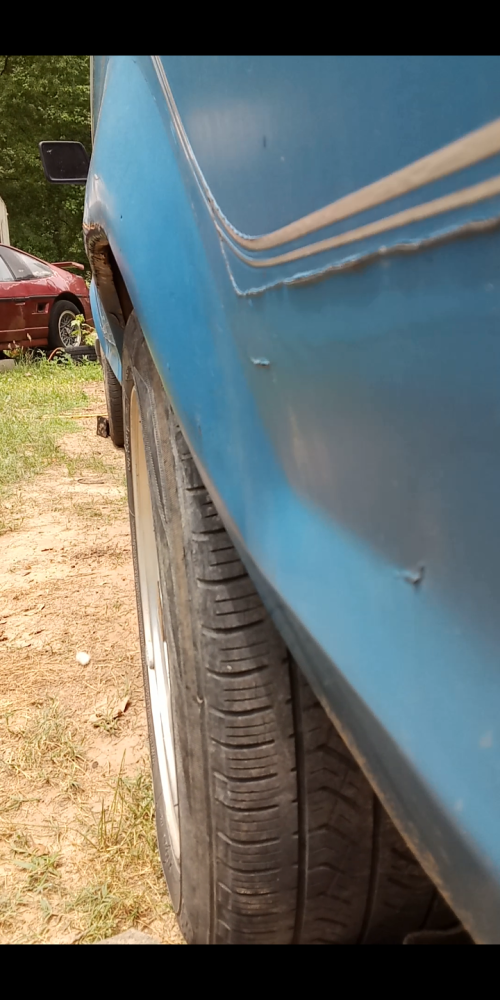

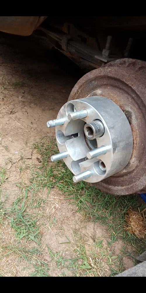

Some 2" rear spacers to fill the wheel well,
Fender gap before^After\/

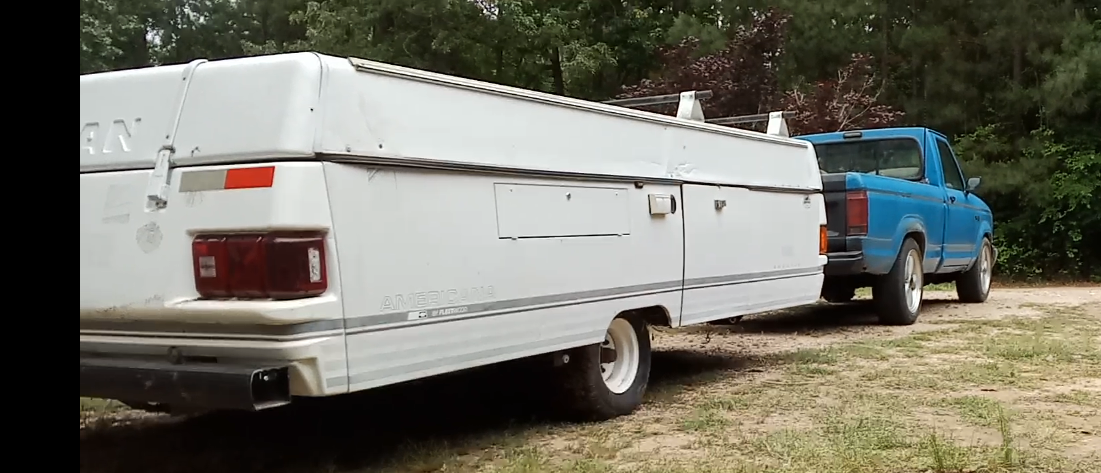

Here's how she handles the 2,700lb pop up I pull occasionally, we have hundreds of campsites in a 60mile radius and I'll use this before I do my f350 460fi (8mpg)
Haven't taken it on road with camper but before my hitch was 8-10" off the ground with camper ands is now 14-16"!!! And it handles well without the camper!
Sorry there Gabriel 43167 part numberfor the rear
Front gabriel 34076
Less than $200 for all four I am ordering a fresh set for the rear later was curious now on how they handleso the old set went on
