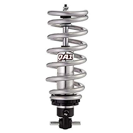

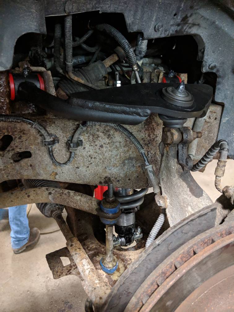

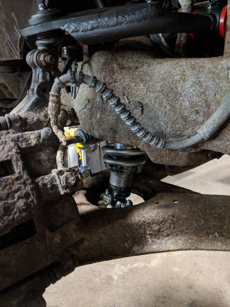

After searching for eternity and not finding anything that works in a stock application, I finally gave up and called QA1 and talked to a rep about potential coilovers that would work. After about half an hour on the phone talking about weight, length, and travel, we happened to stumble upon a gold mine; a Chevy S10 has the same basic front suspension setup, AND they make coilovers for them. With that in mind I took a leap and ordered the pro adjustable front coil set. From what I can tell, the only reason nobody carries stock-mount coilovers for a ranger is because they never thought to bring one in to test. That was the case with QA1. But for all my Mini Rangers out there, these coilovers absolutely work perfectly and make a huge difference in ride quality and handling, especially if you're running 2-4" drop up front.

No. The 97 and earlier Rangers don't share a single common front suspension component with the later trucks.
