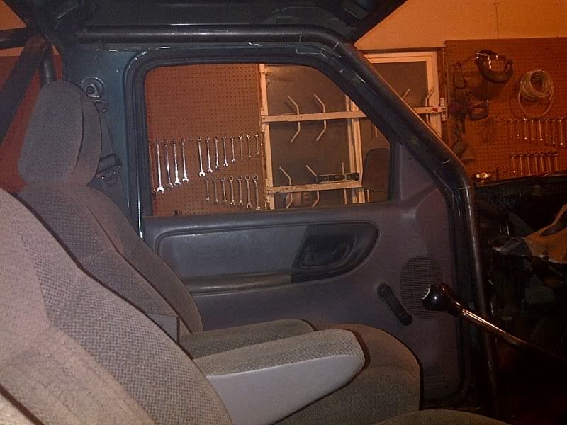

Got my tube...started on the interior cage. Im trying to keep it as close as I can to the cab, I need all the space I can get. Figuring out these bends in multiple planes is significantly trickier than the back half.

Cage will tie into outriggers Ill make coming off of the frame. Also going to be keeping the stock dash. May get some more done this weekend.

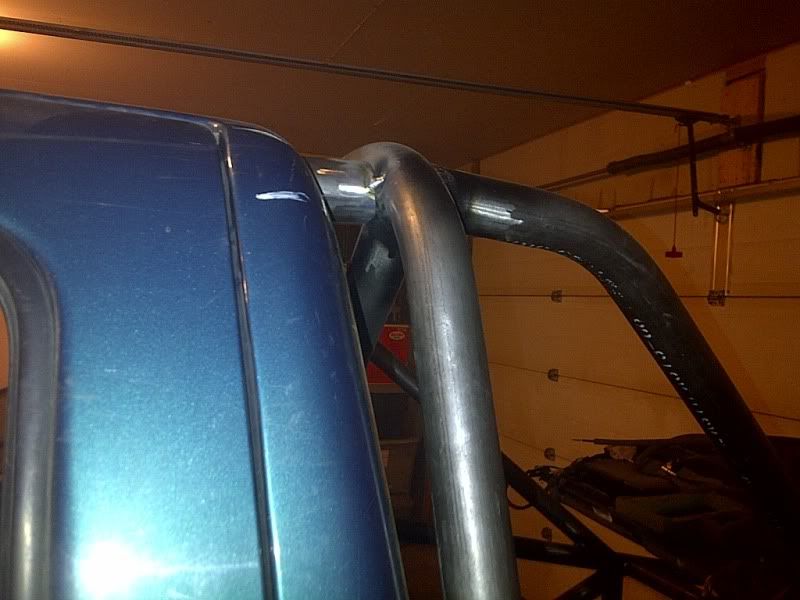

Final fitment of A pillar of cage.

Goes through the body, into rear cage.
