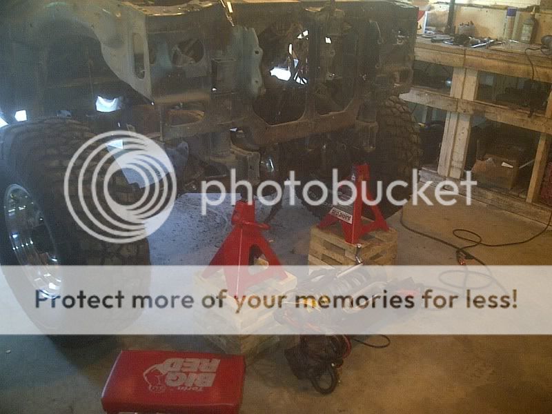

Got a bunch of small, but necessary, stuff done tonight.
Started by tearing out all the old brake lines, fuel lines, and battery tray.
Then cut off the winch/end of frame horns. Still need to plate the ends; will build a new cross member at some point.

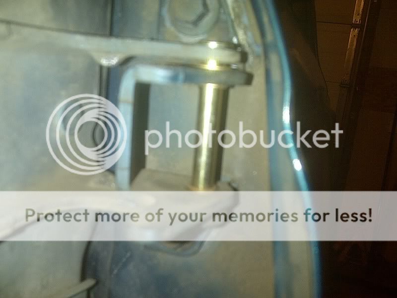

Changed door pins, because I was tired of not being able to shut the doors.

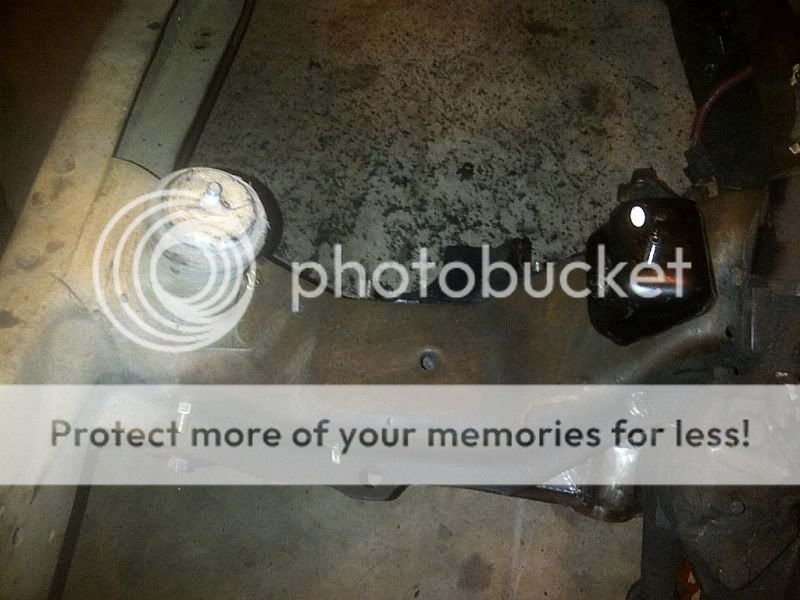

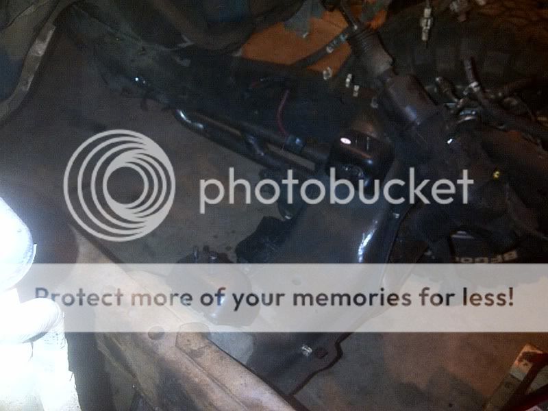

Took out the old motor mounts, here you see a new 4.0 motor mount on the drivers side, and a 2.3 on the passenger. The 2.3 mounts are hydraulic, and suck.
And both 4.0 mounts in place...next is to make plates and drop the motor in, to check for clearances and such.

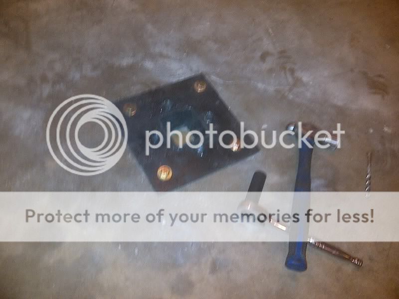

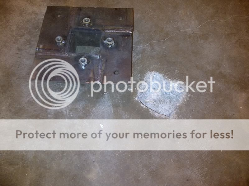

Been busy getting my bender setup. I didnt order a stand because it would have been a ton of $$ to ship, and I didnt want one bolted to the ground permanently, taking up space in the shop. I couldnt find anything for a stand that I liked, so I made one.
Drilled/chiseled a hole in the concrete, and made a steel plate that sits down inside of it, and bolts to the floor

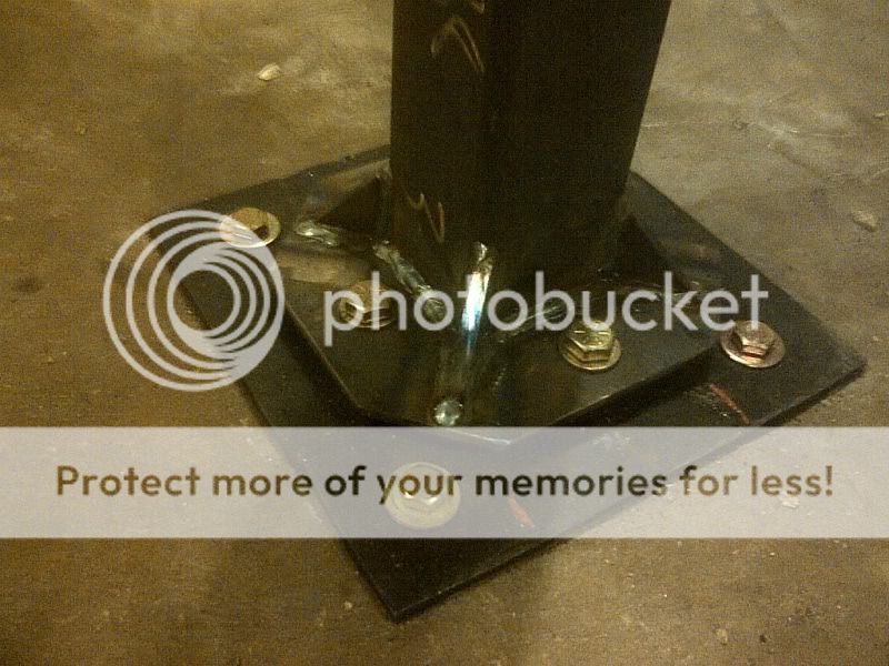

Here it is bolted in place. When the stand is not in it, its out of the way, and easily drove over. Its only 3/8" thick at its tallest point.

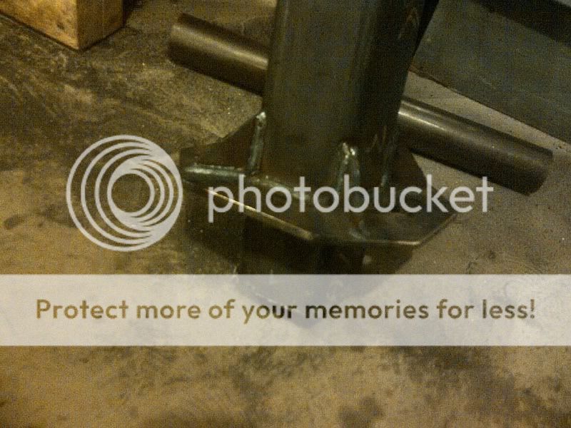

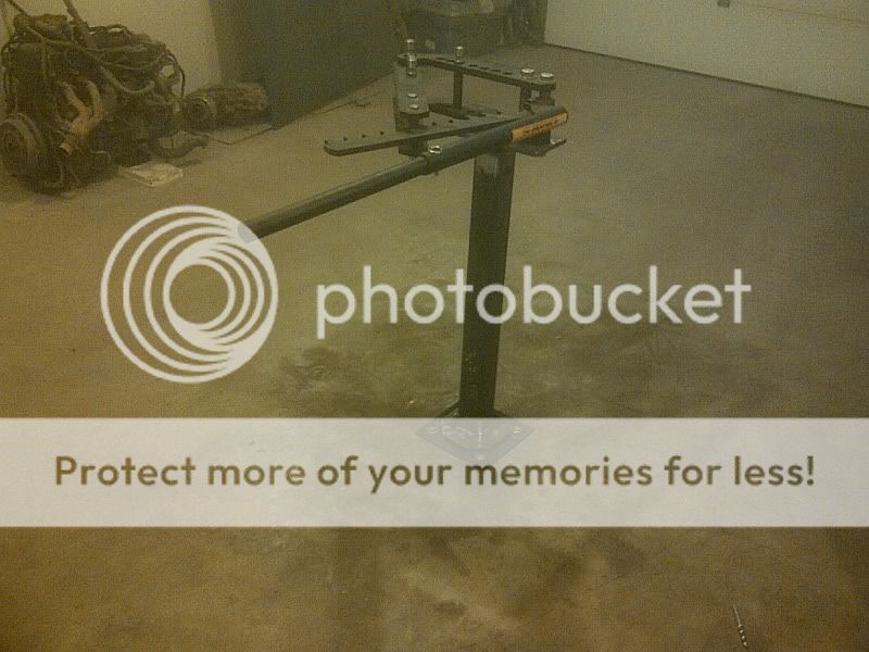

Took some square tube that fit in the ID of the larger tube in the concrete. Made a base that bolts to the top of the plate in the concrete, and welded it up.
Here it is in place, and bolted down. The square tube is a nice snug fit, and sinks down in the floor 5". Its extremely sturdy.
And here it is all together, lots of room to work, and I made sure it was level to the ground. Take the 4 bolts out, pull the stand out, and set it in the corner, out of the way :D

Are your motor mounts level? Mine weren't and I had to redrill and move em before I mounted them for good.
havent checked yet. Need to get a M5ODR2/BW 1356 and figure out final placement. Kyle, what tcase are you running? and did you have any fitment issues? Ive heard of guys having to make the engine/tranny slanted a bit to make it fit.
I'm running a 205, clocked up flat and twin sticked. It is narrower than a 1356 and fits with the trans in the center. The 1356 is too wide to bolt in without fanagling tranny placement.
gotcha. If I was building more of a crawler Id use a 205, but I think Ill make a 1356 fit :D I NEED to find a tranny and t case to mock up, before I can do much anything else. Oh and in case anyone needs the info in the future, F150 1356 tcases have a rear slip yoke, what you want is a 90's or newer full size bronco 1356, as it has fixed yokes front/rear. Mid 90's bronco 1356's also changed from a rear yoke to a rear flange.
