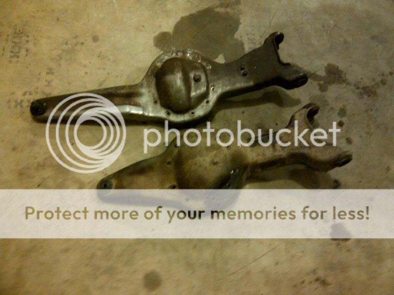

Tore down the 50 tonight, everything is significantly larger than the 35/44 TTB versions. Not to mention it weighs a fair bit. I took some comparison pics between the 44 and 50 beams for future reference.

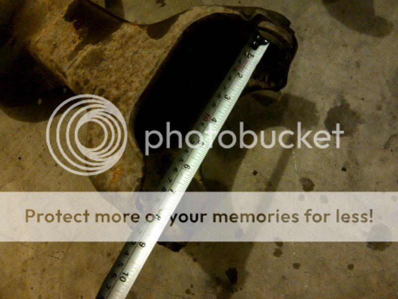

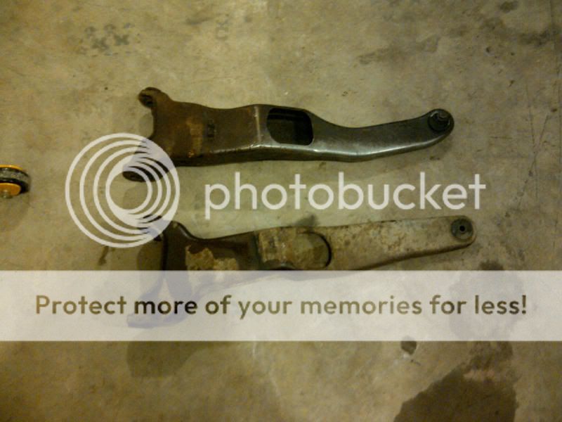

PASSENGER: 44 top, 50 bottom
DRIVER: 44 top, 50 bottom

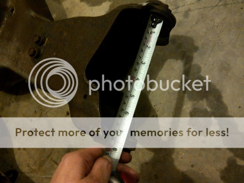

distance between ball joint sockets, 44 top, 50 bottom

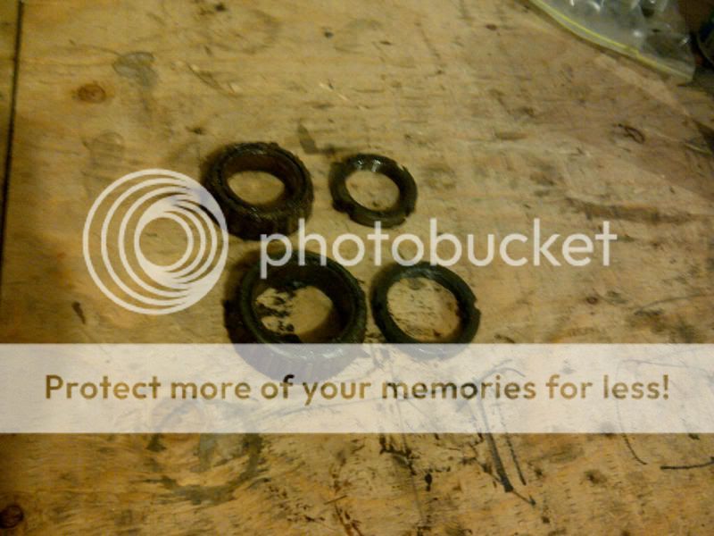

bearings and spindle nut, 44 top, 50 bottom

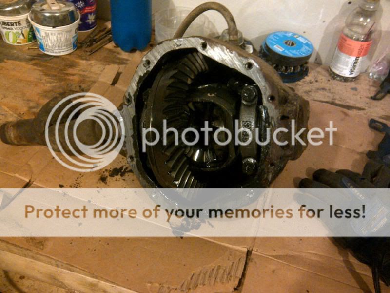

and pic of the 50 pig

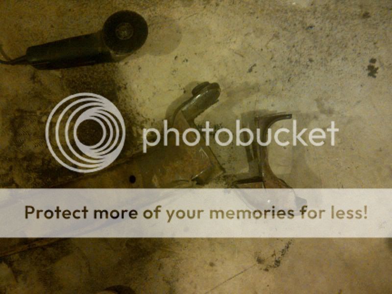

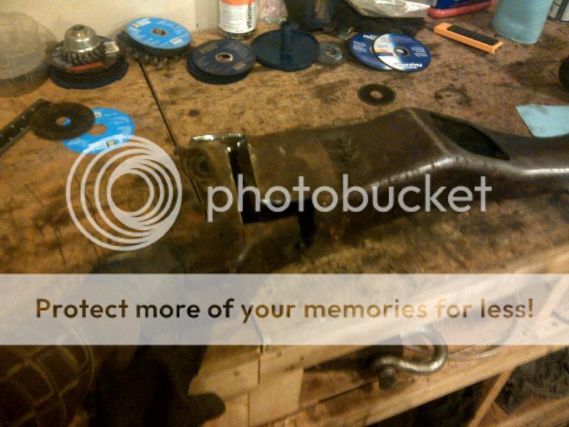

Took some measurements, and cut the lower portion of the Dana 50 passenger arm.
Then using the piece I cut off, took measurements from the center line (line created by running a piece of tube through the ball joint holes) and transferred them to the 44 beam, all the while keeping them in relation to the top ball joint. This is the reason I left the top joint, as it allows me to keep the knuckle:beam angle very close to original.

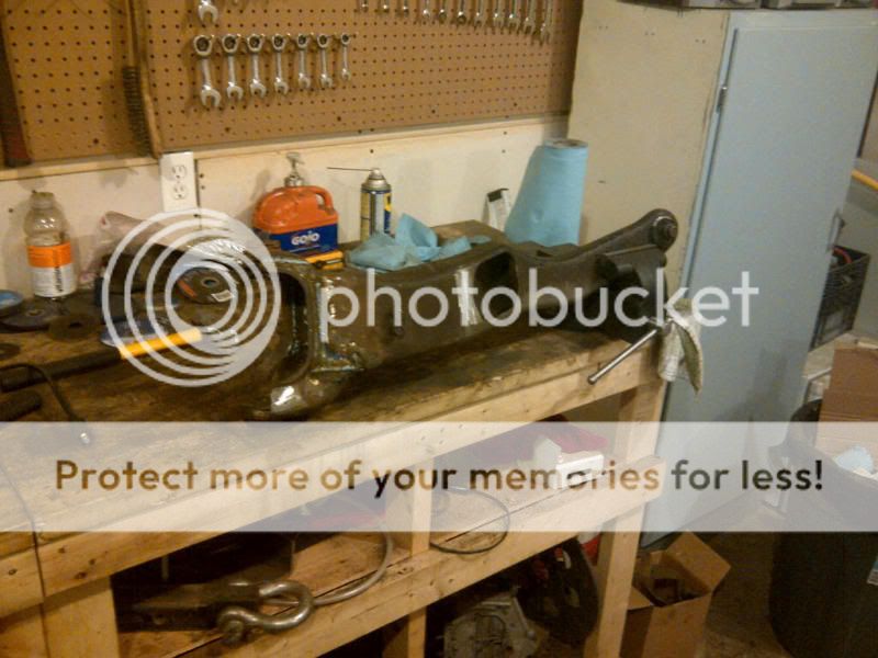

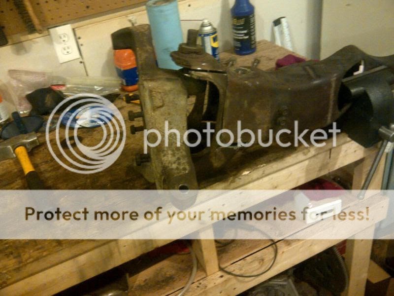

Had to head in for the night at this point, but was able to mock them in place....that is the 44 beam with 50 lower joint and 50 knuckle. I have a few more final tweaks/grinding to do before I weld it all in place.
Ill have a couple hours tomorrow night to work on this more, so hopefully Ill get this beam all set and welded in place, and truss/gusset plates designed.
Had to do some grinding to fit the piece where I wanted it. BJ socket to BJ socket is identical to what it was stock, and the angulation of each BJ socket are within a degree of each other, so Im pleased.

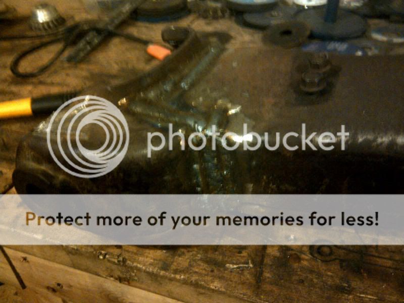

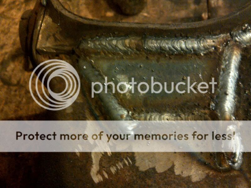

I wanted to ensure a strong weld, so I made sure to pre-heat all joints prior to welding, and made multiple passes. Also, all welds were done inside and out.
On the back of the 44 passenger beam, there is a depression. The axleshaft still cleared, but just, and I wanted to make sure I had more than enough room. So I cut it out and welded in another piece.
