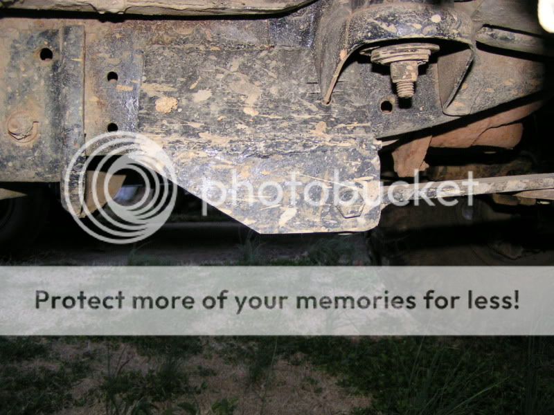

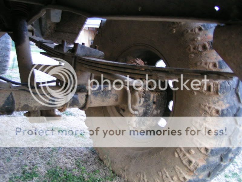

Hey John, do you have any closer pics of the front leafspring brackets? And did you ever end up adding any leafs to your explorer leaf pack?

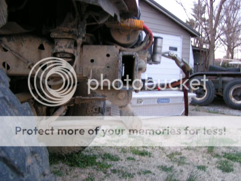

the rear tabs are gonna be cut off to mount the "box sliders" like Jon ( Slo-Vo) has....
as for adding any leaves I have not....the pack has not sagged any yet after three wheeling trips....but if it does I will add as needed....

I just used the factory spring perches on the D60, and with the Ex leaves I think it works fine....

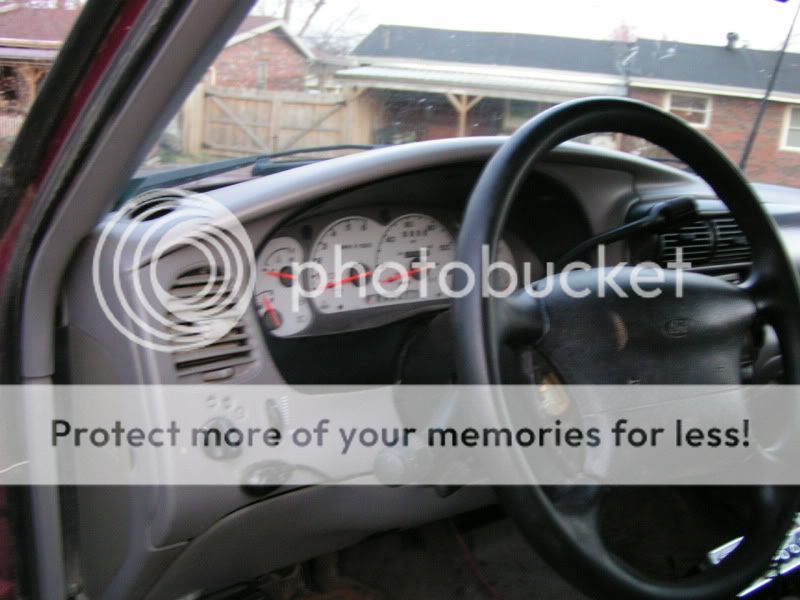

and in other news.....I have finally installed my Ex Sport guage cluster I have had sitting in the garage for the last year.....

I didn't realize explorer sports had white gauges in them, do you know what all years had them?
I got mine out of an early 2000's one...I believe they started putting them in Sports around the same time the Sport Tracs came out....

Hey John, what pitman arm are you using? How far did you push the front forward? and whos hi steer arm is that?
E-brakes are overrated.
hmmmmm....I wonder why????:D:icon_rofl::icon_rofl:
for now I still have my drop pitman arm from RC....but, I plan to put a F-150 arm on her for a little more clearance...
I pushed the axle centerline forward 4"....
the Hi-steer arm I got off Evilbay and has "Bonez" engraved into it....was only $52....

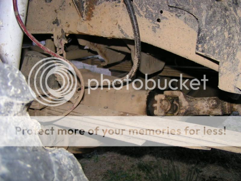

Hey John, what did you end up using for drivelines? Stock ranger with conversion joints?
my 1 piece rear shaft I had to shorten about 2"...
as for the front shaft I had to lengthen it 2"....since I pushed the axle centerline forward 4"....
and yes I used the conversion joints front and rear....
when I install the doubler my plan is to make both the front and rear shafts identicle, so I just need 1 spare....
