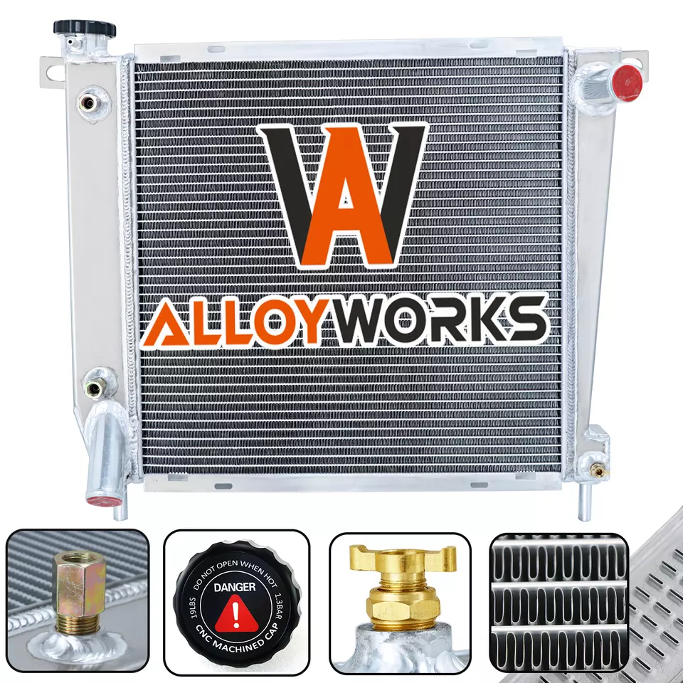

I would go with an aluminum radiator, there are several on Ebay like this one, for 85-94 rangers.
summit ebay and amazon are generally the best deals.
can be risky.
