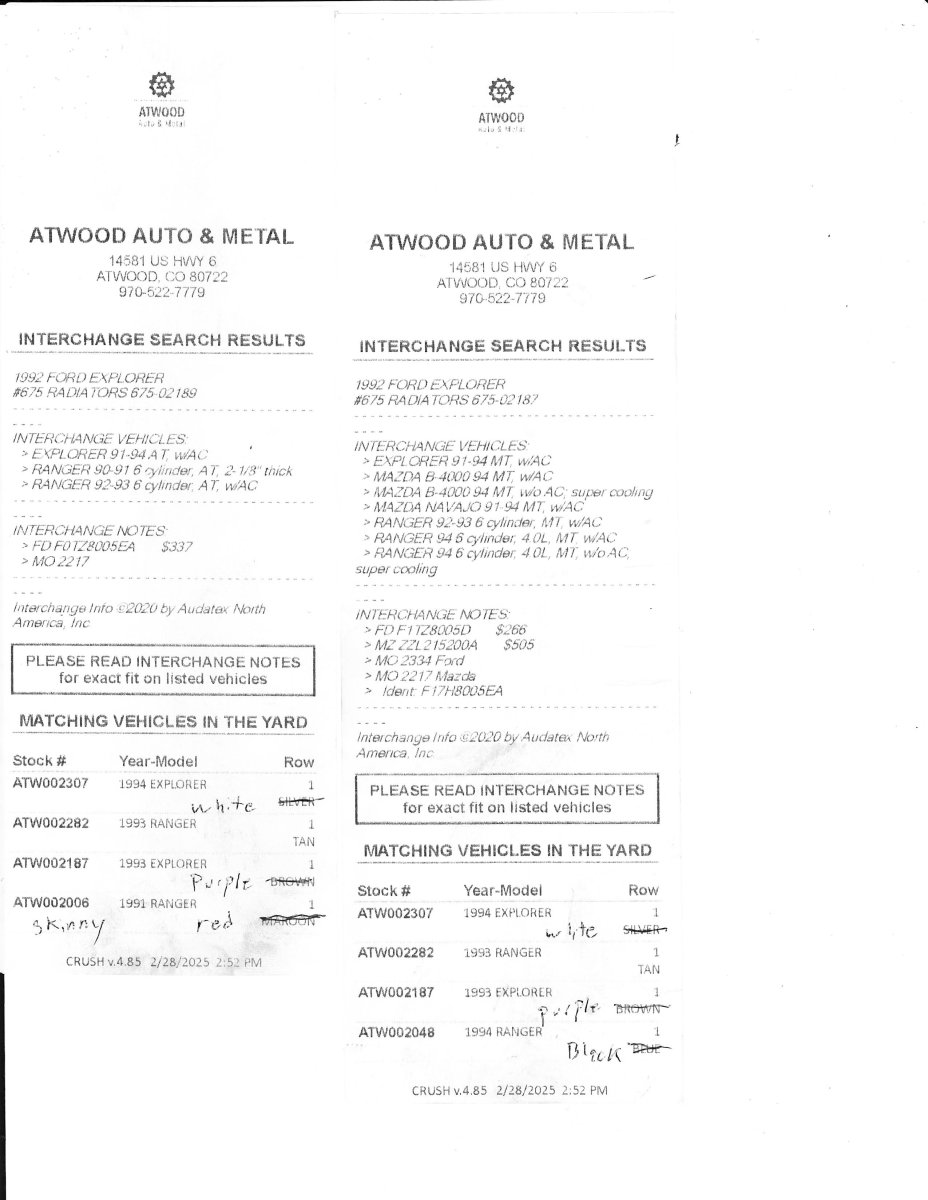

I read several forum threads suggesting slight variations "4.0L explorer with AC" etc etc... well rather than just randomly poke around the junkyard I picked a year I kinda knew should be right (92 explorer with AC) and asked them for their interchange... they gave me this:
That was both more than I expected and less... they include earlier years of Rangers (1990 before the 4.0L was introduced) and some things I hadn't thought of (Mazda's)... Of course I looked at every one of the candidates they gave, one was the "right combo" but someone had taken the radiator and shroud both (the purple one)... all the rest were skinny radiators, missing or front end completely smunched in.
As long as I was roaming around I glanced at every explorer in the yard and there were several 2001/2002 (that would be SOHC's) but the radiator was totally different looking and after a second of staring at it thought I wouldn't be able to adapt reasonably.
So here's what I "assume" based on this....
Any Ranger or Explorer (heck, even the van, etc) manual trans or auto trans, AC or no AC might have the double thick radiator and almost any model between 1991 and 2000 would be a candidate for having the right radiator - right? Is that too broad, or too narrow and I am missing something. Just asking for a little help narrowing it down so my next trip (which now must be soon) I can hit all the candidates without wasting a lot of time chasing down the erroneous.
1994 Explorer w/Auto Trans & A/C yielded me the two-core radiator I needed for mine.
I’m not sure about the rad in gen 3 Ranger (93-97) because I’ve never owned one as to if they fit in a 2nd gen or 1st gen.
I do know that a 90-92 Ranger and 91-94 Explorer with auto trans and 4.0 with AC nearly always have the thick rad and fit in any 1st or 2nd gen.
98-11 share the same radiator mounts to the best of my knowledge but they do not interchange with the 1st/2nd gen. I don’t know if they could be made to fit or not, but one of the big things is that they are taller. I should have an 83-92 thin rad with auto transmission, a 4.0 auto AC out of my 00 and a 97 Explorer 5.0 auto AC rad down the driveway currently, I’ll see if I can remember to do some comparisons.
IIRC 95 up Ranger has different lower mounts.
1st gen Explorer, auto, w/ AC is your best bet. You need the shroud & maybe the lower hose (it's necessary when swapping from a manual trans radiator.) FYI the 1st gen Explorer "manual trans w/ AC" is smaller than the automatic w/ AC radiator.
1991-94 Explorer auto w/ AC is what I used in my '90 Bronco II. If I'm not mistaken, the auto trans w/AC radiator was the thickest available that would drop in and bolt up to the GEN2 radiator support. If I remember right, I had to use a trimmed 4.0 upper hose.
