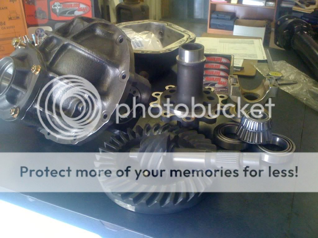

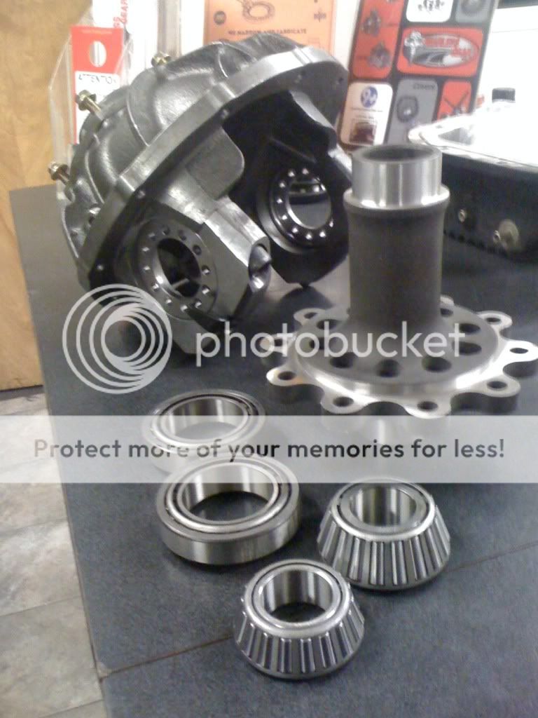

Got all my parts ordered up for my 9". Cant wait to have it under the truck, going to build it over the course of next week. whent with a 5.67 ratio, should put me about 4k rpm at 70 and 5k at 80 not using overdrive. This set up is good to around 1200hp with the 35 spline axles, so i dont think i will be breaking this thing anytime soon.
you should be set with that...alot of beef

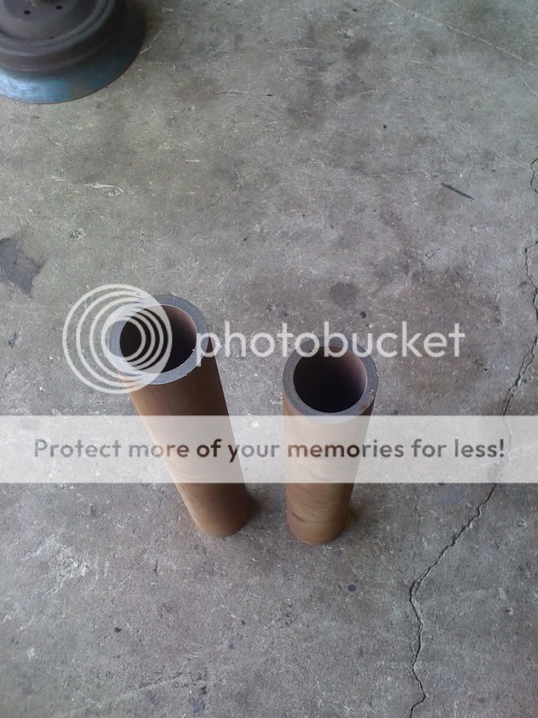

Cut the tubes for my housing, 3 1/4" o.d 3/8 wall. Quite Beefy.
just went threw the whole thread, love the build, keep jumping the $h%t out of that thing!
so your re-tubing a stock 9 inch housing?

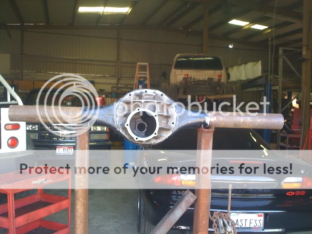

Yeah pretty much, we shove the new tubes in a lot farther than stock though. Almost to the carrier bearings.

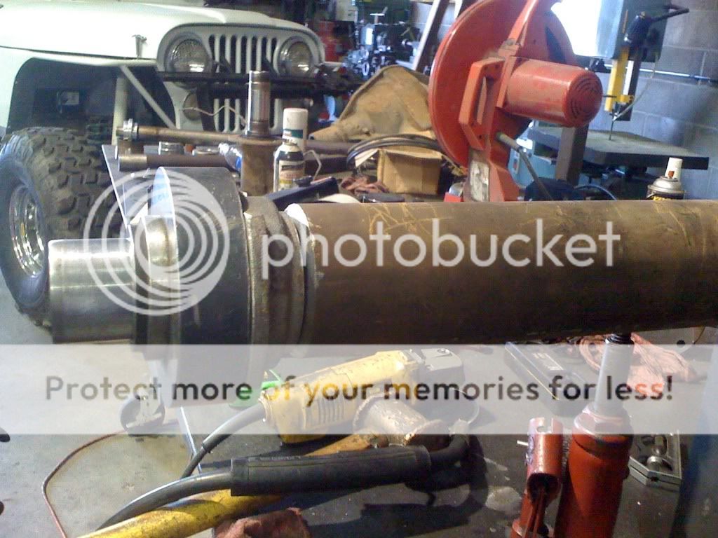

also did some more work to the housing today

so your going with regular 9 inch outers? i see a rear spindle in the back ground, didnt know if you were going FF or not
