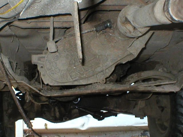

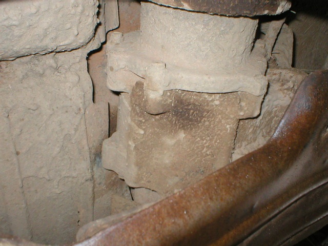

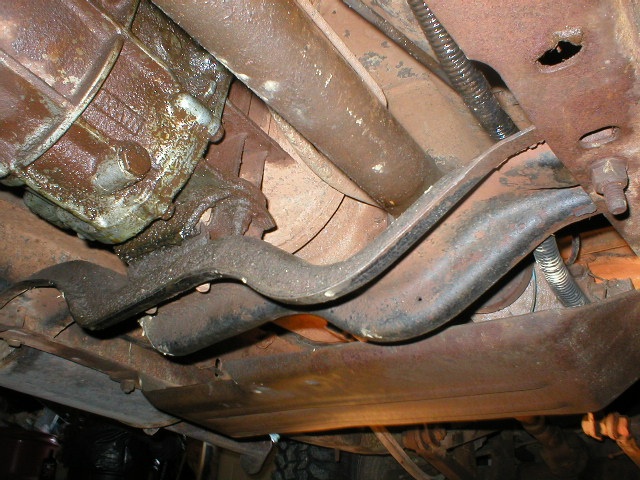

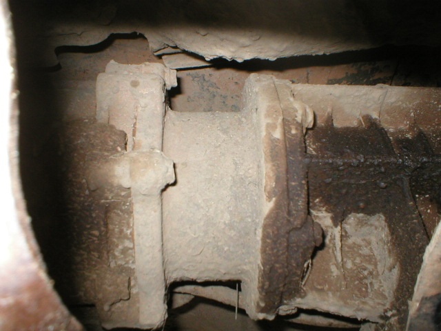

Ok i found pics of where a guy used an aod adapter to hook up 1350 t/c.but im having issues uploading them.a current owner did the swap and he asked around until guys in another forum told him.il upload asap
Pic r2-1350bw t/c
Pic
Pic of t/c
T/c

Pic
Pic
Pic 2
Pic 2
So can anyone tell me which adapter that is?its possible to convert the stock t/c and the kinda off road i do. Itl work fine.guess i still gota buy a 4x4 tranny.
You have to change the output shaft of the 2wd trans to mate to a t-case. A 4wd trans/t-case combo already assembled is the easiest way to go.
Sent from the road while ignoring traffic
Yep, if you want to retain the 1350 TC, going to need an adapter (Advance Adapter?). Best off like just said, start with a full size trans & TC. 1356 and 4406 will require some notching or moving power train more to passenger side.
