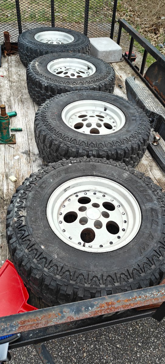

I scored a set of Jeep "Gambler" wheels with nearly brand new 31*10*15 MT's on them.
I don't need MT's by any stretch of the imagination, but I'm not buying another set of tires...
From what I have read, the Gamblers need a spacer to keep them from rubbing on the LCA's and shocks.
So I ordered a set of (4) 2" from Titan.
I'mma put it all together but NOT Loc-Tite the front ones until I get an idea how it looks. If it looks goofy, I'll see if 1.25" or 1.5" will give me the clearance I need...
...then throw the extra pair 2" up here for sale. 🤷‍♂️

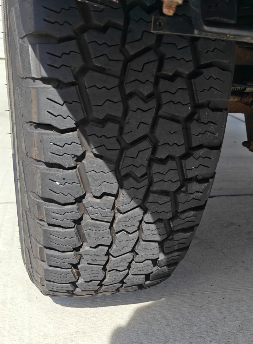

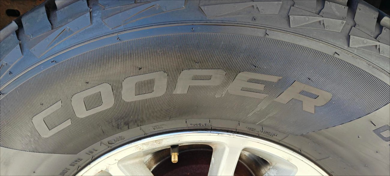

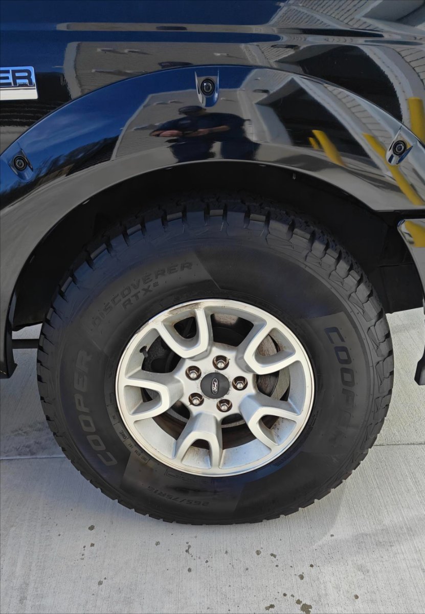

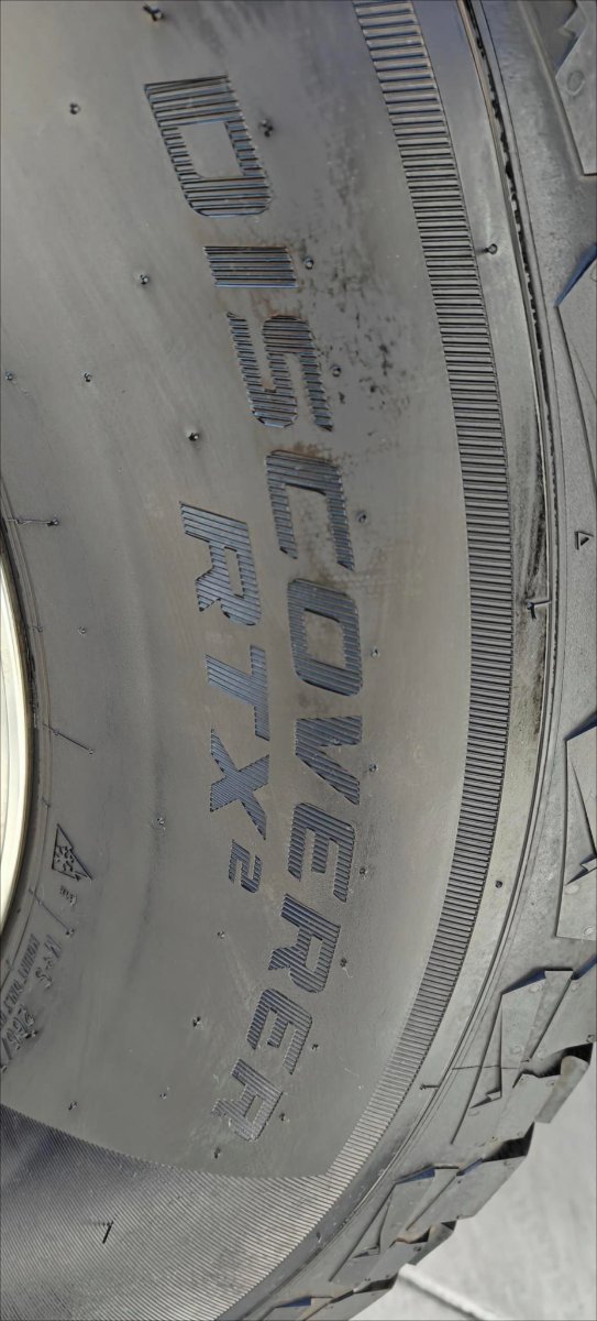

FWIW, my OE stock 16's wearing 265/75 Cooper Discoverer RTX 2's with about 10,000 miles on them will be for sale soon...

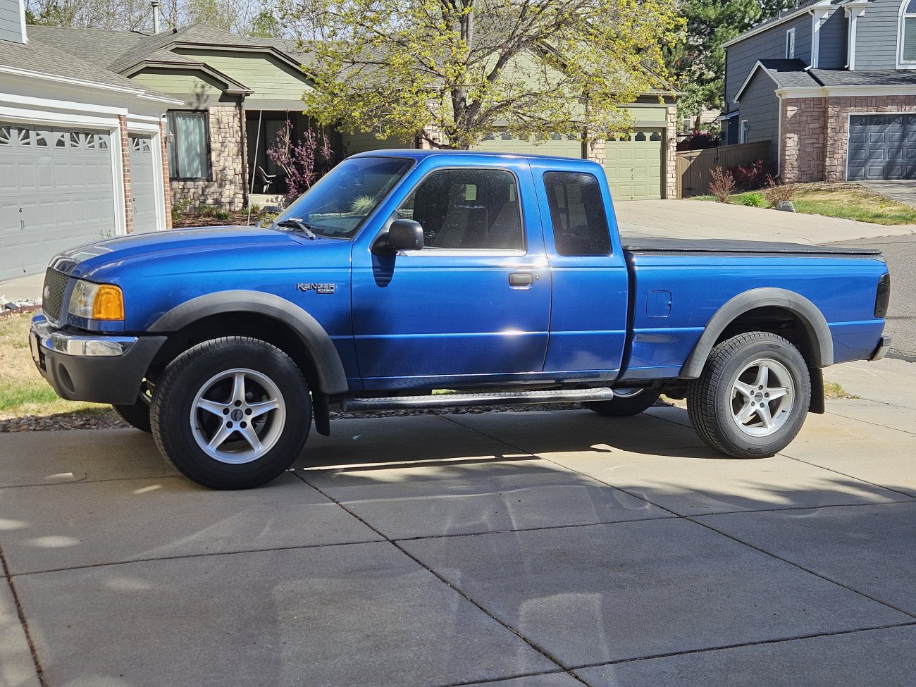

Here is a photo of my 01 for reference:
